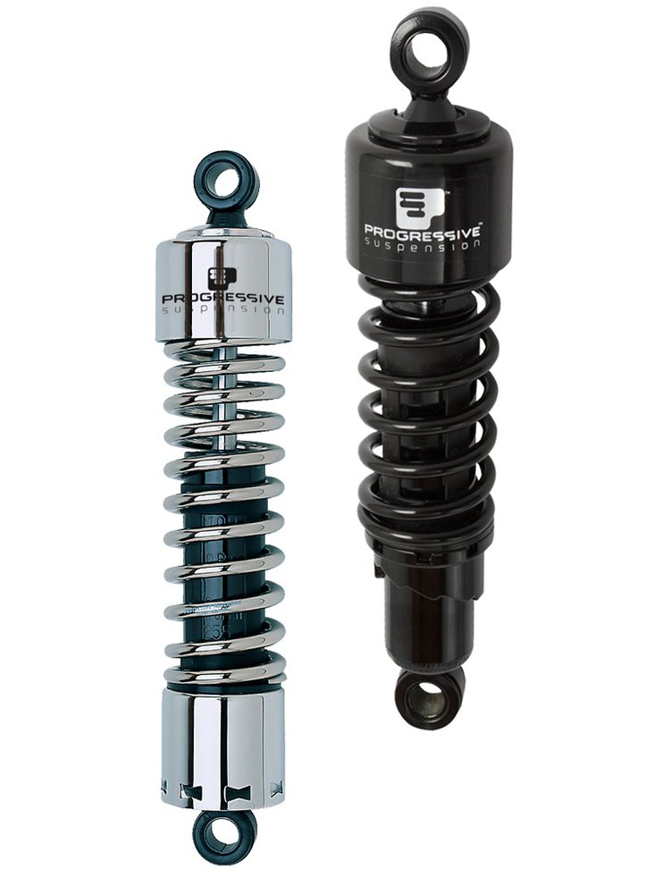

Progressive suspension do shocks with the top shroud which look a little more like the origionals. They are a very good shock.
