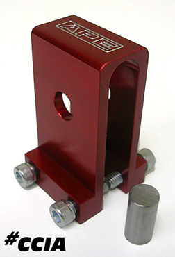

Has anyone got a spare Camchain idler adaptor that they would be willing to sell? Cheers, Mick

Mark,I am using a Z1000J head on an ST engine converted to chain with an Opcon Autorotor supercharger, I have a set of 1045 Wiseco pistons and want to reduce compression. It's an APE adaptor or similar to run an idler that I'm after. It is a long term project, but I'm always on the lookout for useful parts, cheers, Mick

http://kzzone.com/sprockets.html
Still available as far as i can see.
Rob ZED1015 did have the drill jig for this which you would need also, as i remember him doing one a few years ago.

Thanks Al, I just had a look at the website. It's very useful to know that Rob has the drill jig, especially as he's not that far from me. Cheers, Mick

I have a jig and will drill your head FOC if you bring it.
