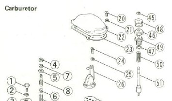

Cleaning the carbs on my 1978 KZ1000 A2 I have found one of the starter plungers is bent. Anyone got a straight one I can buy please?
Starter plunger is number 51 in the picture
Starter plunger (51).jpg (18.45 KiB) Viewed 1851 times

I refurb these all the time and fit new Viton seats as the originals are always worn and leaking which causes rich running..
viewtopic.php?f=1&t=46284&p=383839#p383839
Many are bent when I receive them but they are only brass and easily straightened.
I also have a very limited amount of NOS Mikuni plungers here -
viewtopic.php?f=1&t=46415&p=384946#p384946
