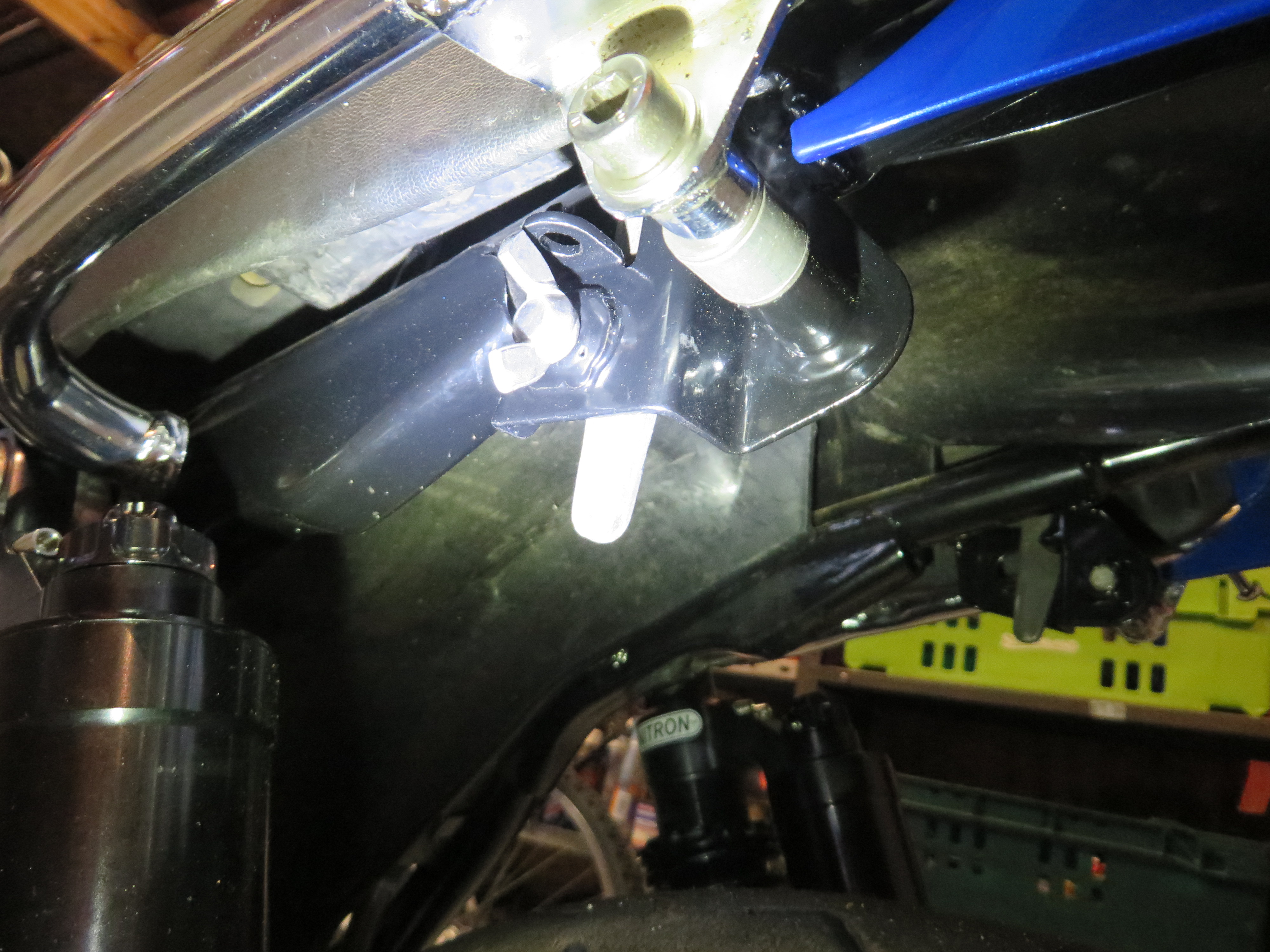

After going to Cadwell Park and discovering i had left my seat lock key at home (couldnt get seat off to connect battery) i deleted the lock mechanism and put a 6mm nut and bolt through the hole to attach the seat. Later revised to a welded 6mm nut and quick release wing headed bolt for simplicity. Not elegant but practical in the short term.

Not pretty but does what i need.

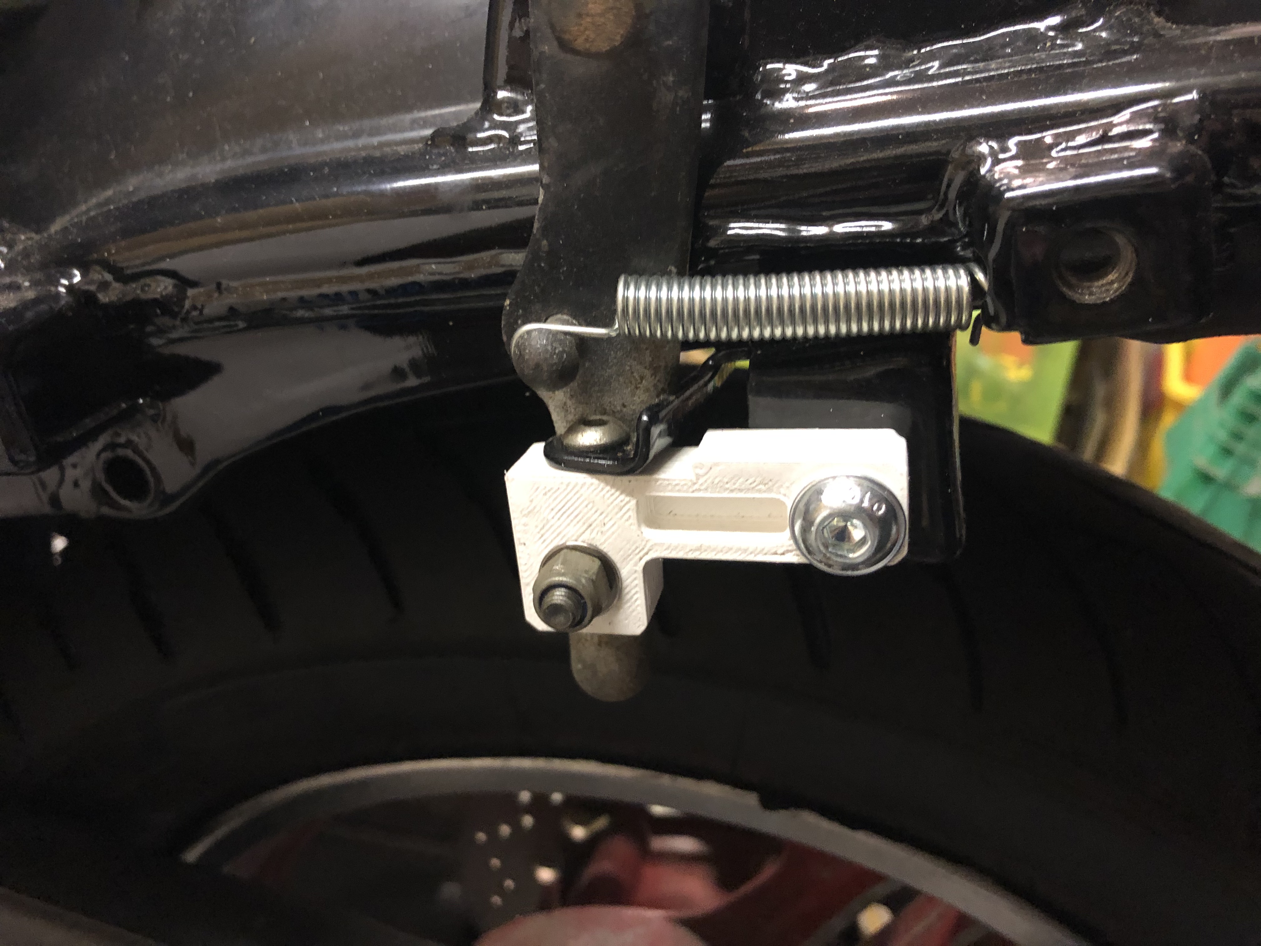

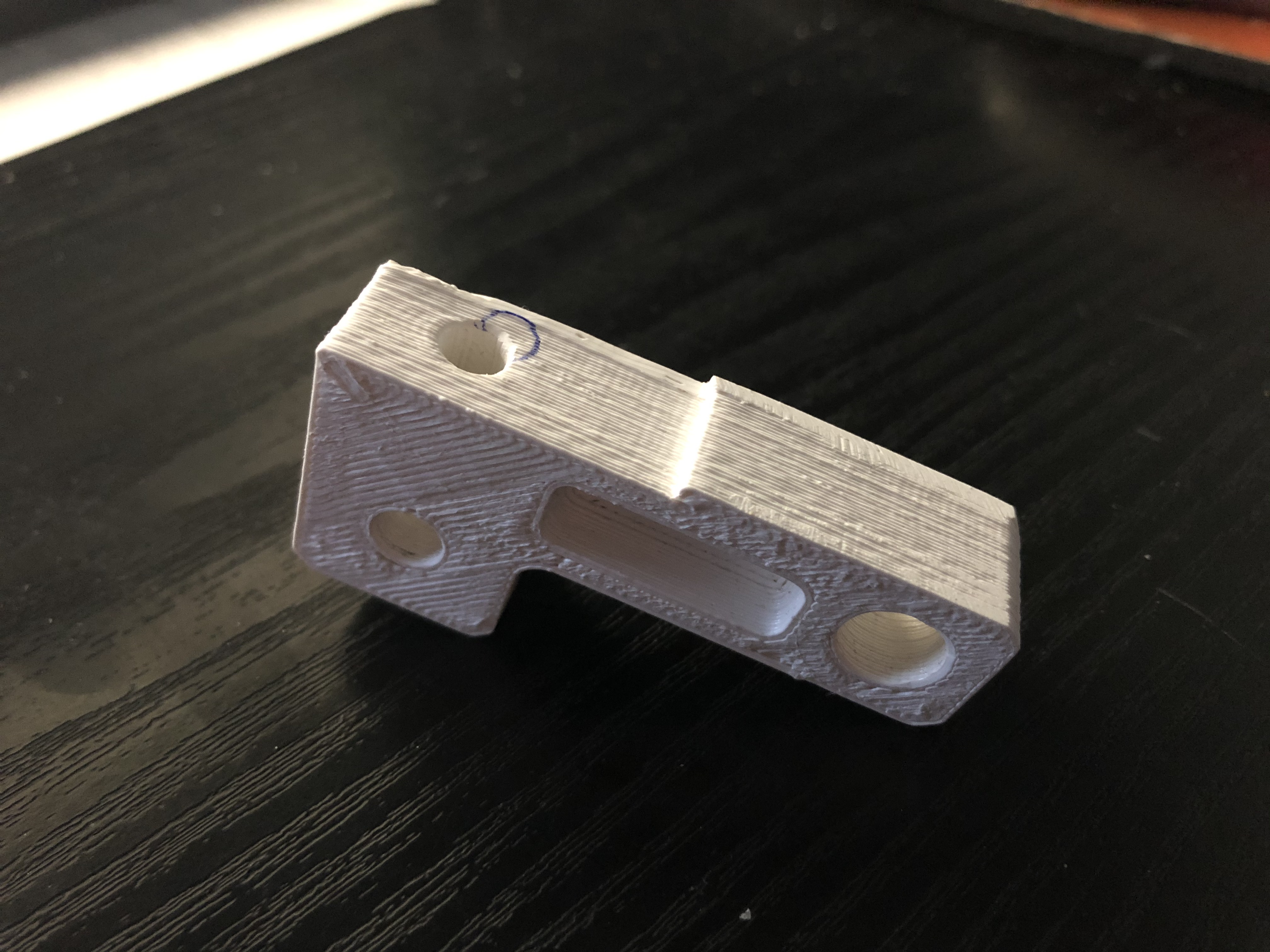

Here’s my first attempt at a seat lock. I got the vertical M6 screw hole in the wrong place. I suspect the bracket on my frame is just a wee bit, slightly bent.
So here’s the second attempt with a few adjustments.
Having printed it in ABS it feels quite sturdy. I was toying with the idea of having a spring loaded pin like Tomforde’s but after seeing Al’s wing nut mod, I just might stick with the nylock nut.
