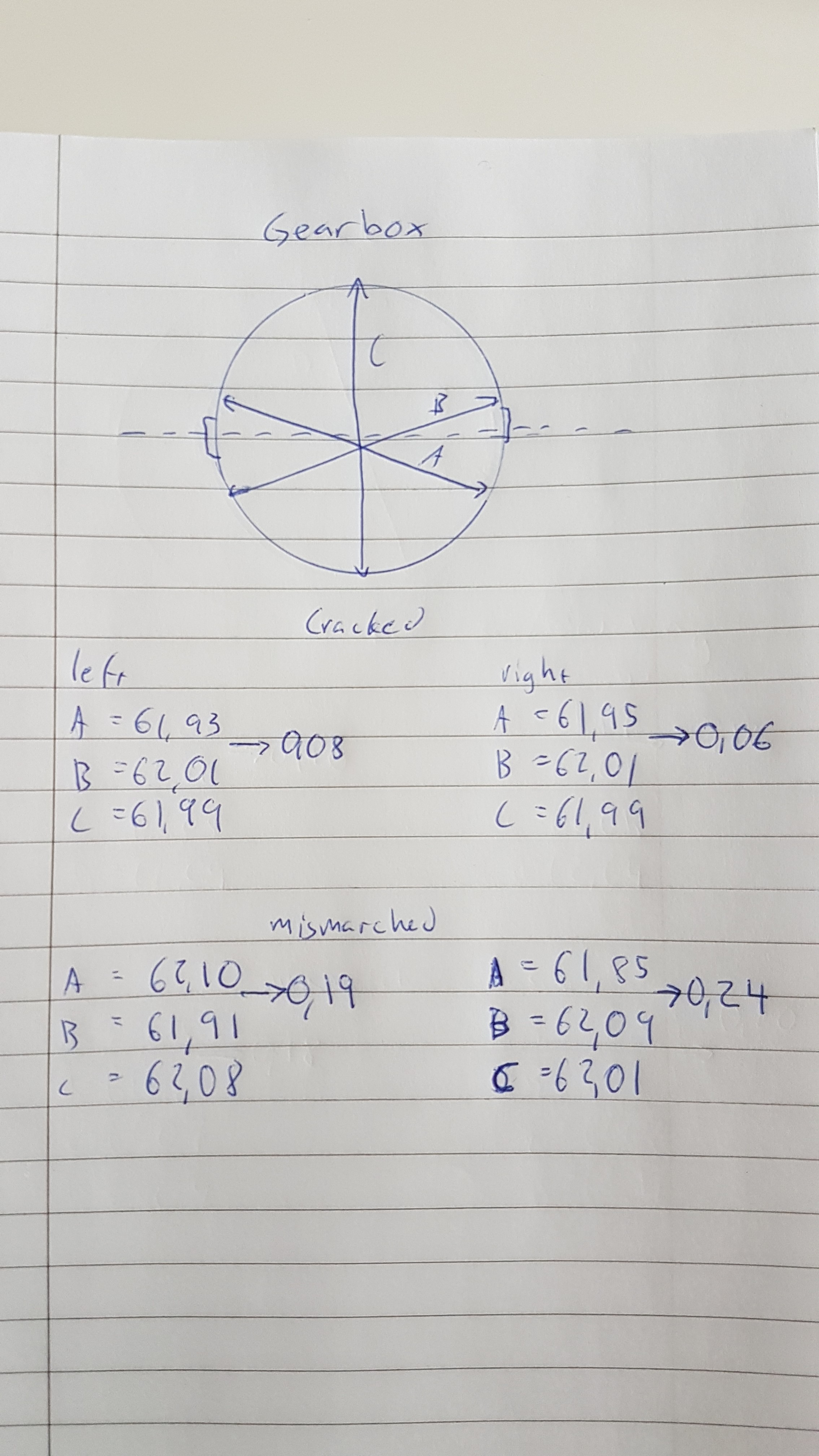

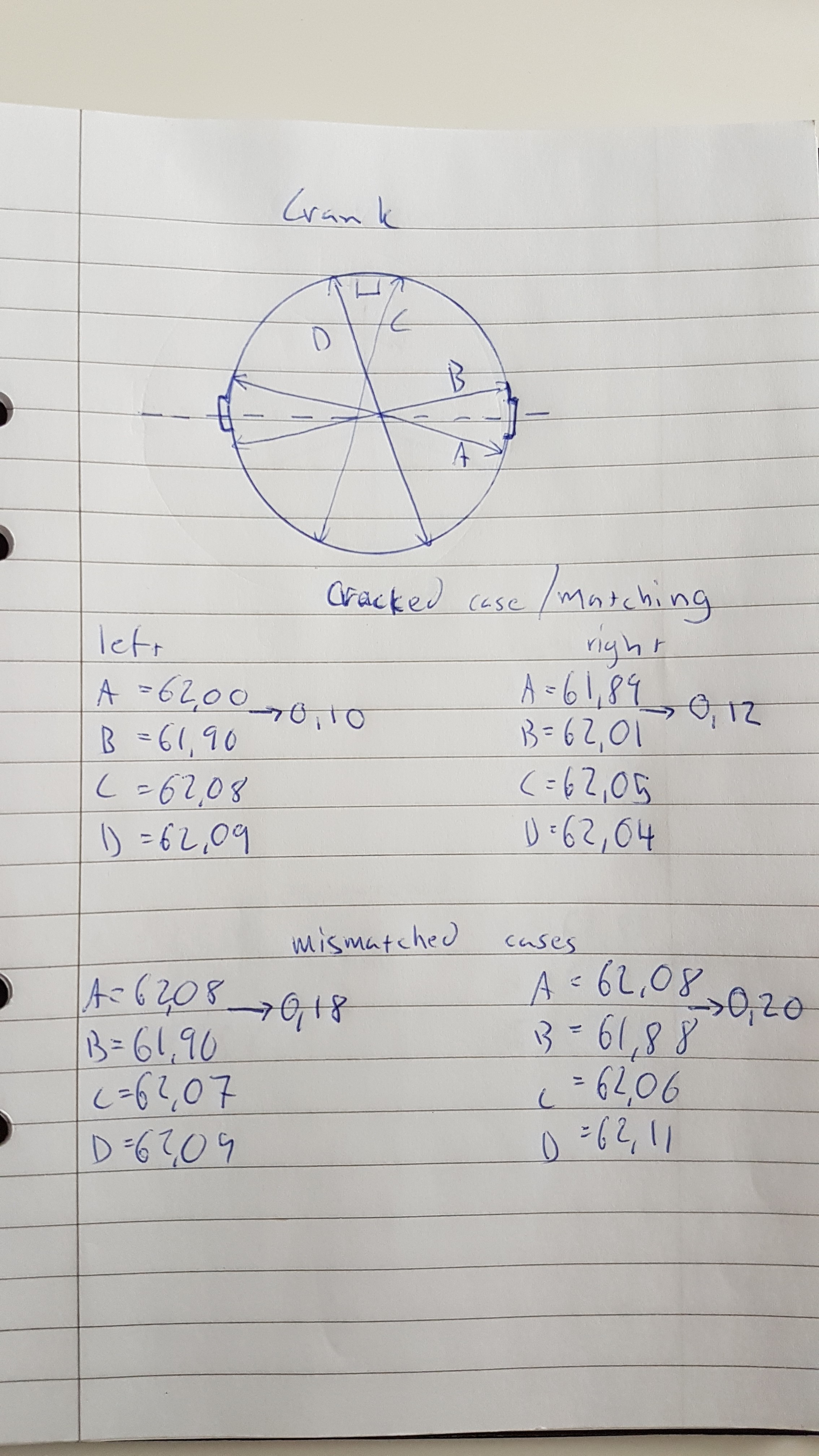

#9 PostAuthor: FreddaAbborre » Mon Mar 13, 2017 8:38 pm
Finally got the last measurements.
The mismatched cas has a bit larger offset compared to the matching case.
Left crank side: 0,18mm vs 0,10mm left
Right crank side: 0,20mm vs 0,12mm
Please see scetch below to see how I measured. A vs B above
And the result for the gearbox. Simular to above.
Does the mismatched case pass?
Should I use the center crank clamp from the mismatch case? So the forces from the cases on the crank will be in line?

#10 PostAuthor: zed1015 » Tue Mar 14, 2017 12:02 am
Looks like you are good to go.
Use the centre cap that matches the upper case.
As you can see even the matched cases are not perfect , height wise (D / C) they are very close and not tight which would be the main issue,the run out measurements in other axes are comparable to the mismatched ones.
I would dry assemble with the crank and gearbox and bolt it all up as a final check and ensure that the outer gasket faces are reasonably aligned.
Again check this by bolting on the outer cases, clutch cover etc without gaskets to see how they sit.

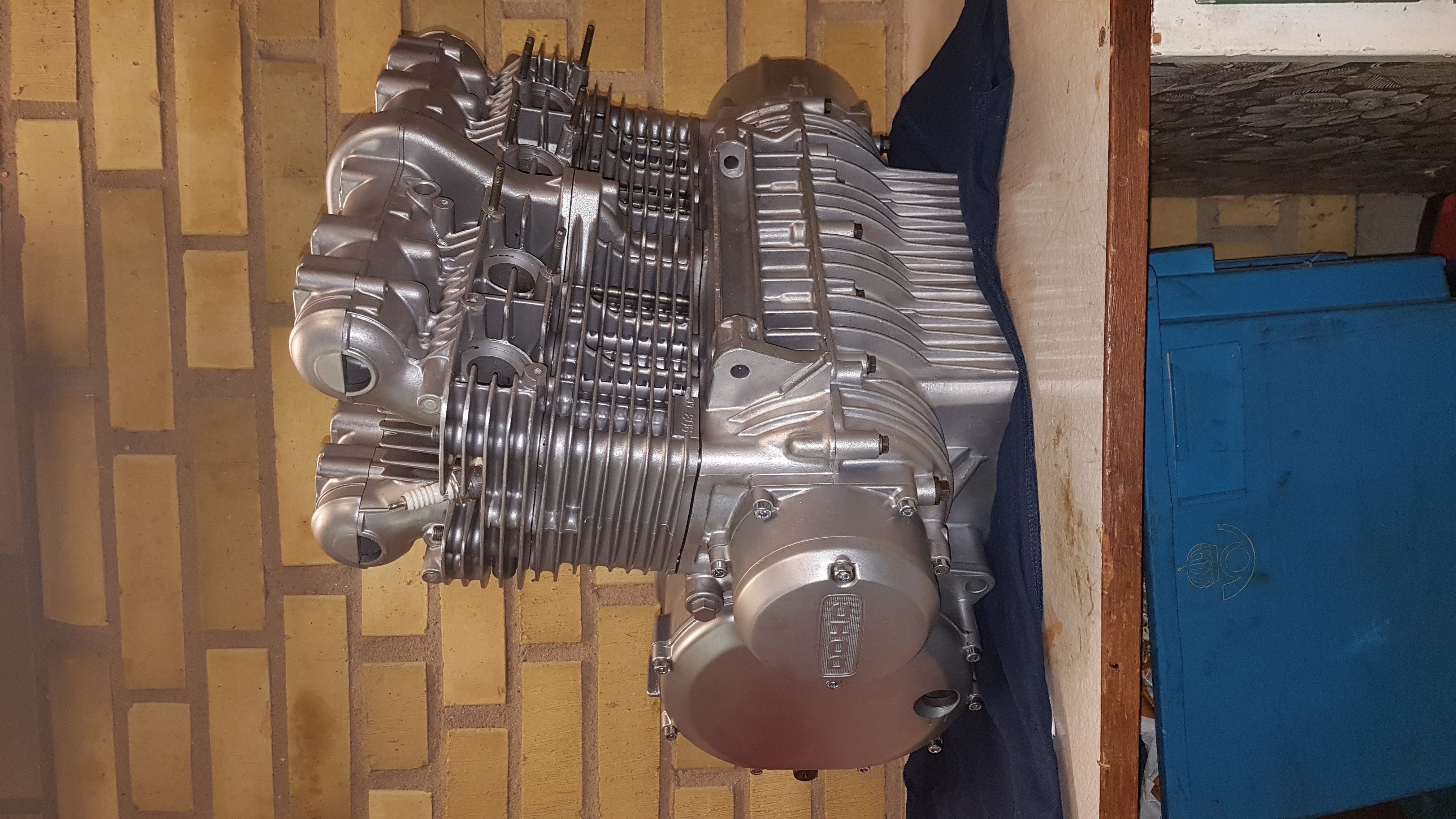

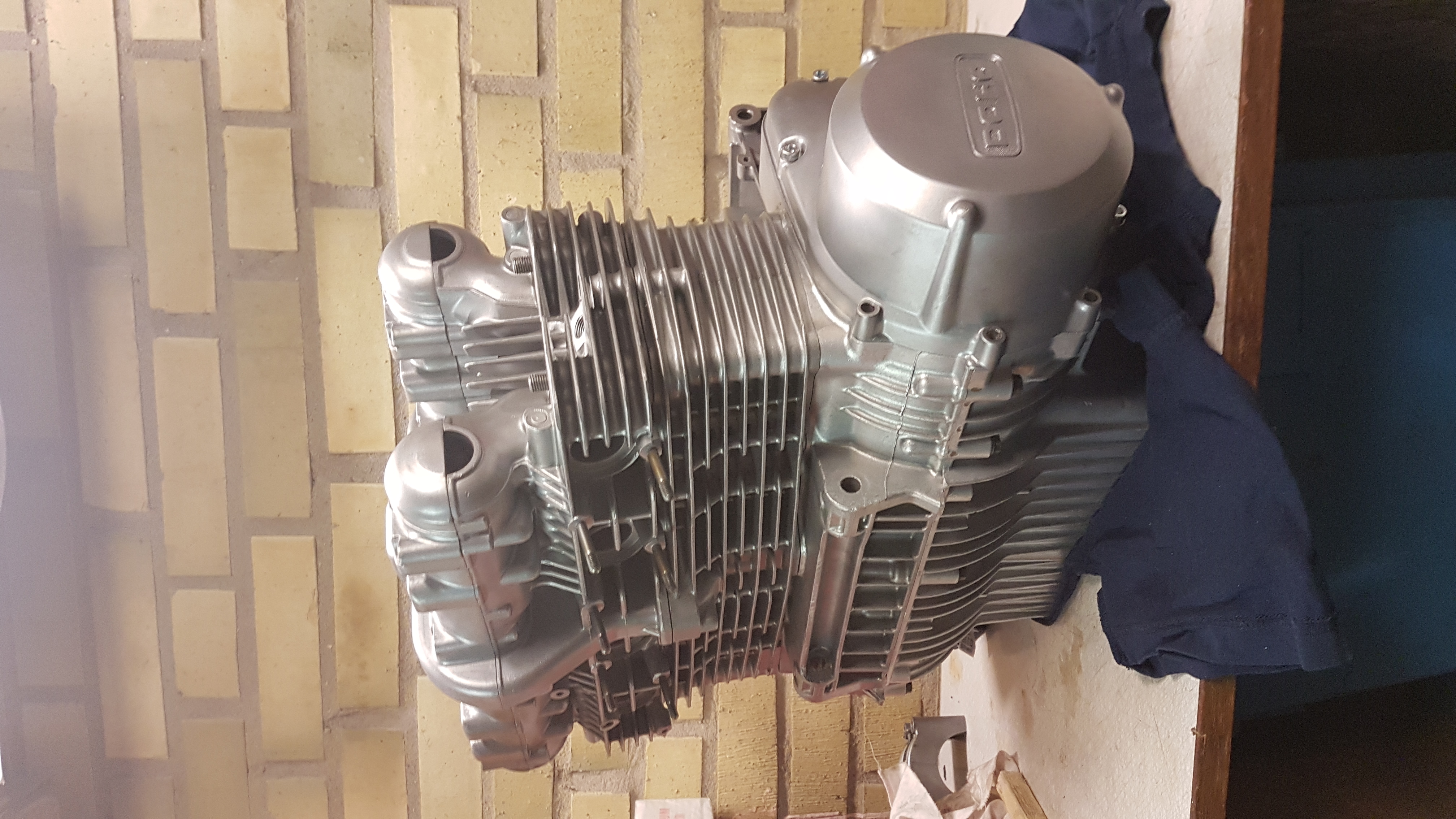

And having the engine almost mounted I couldn't resist to put on cylinder, head and cover to see how it looks. Pretty good in my somewhat biosed opinon...
Thanks for all the useful help!
