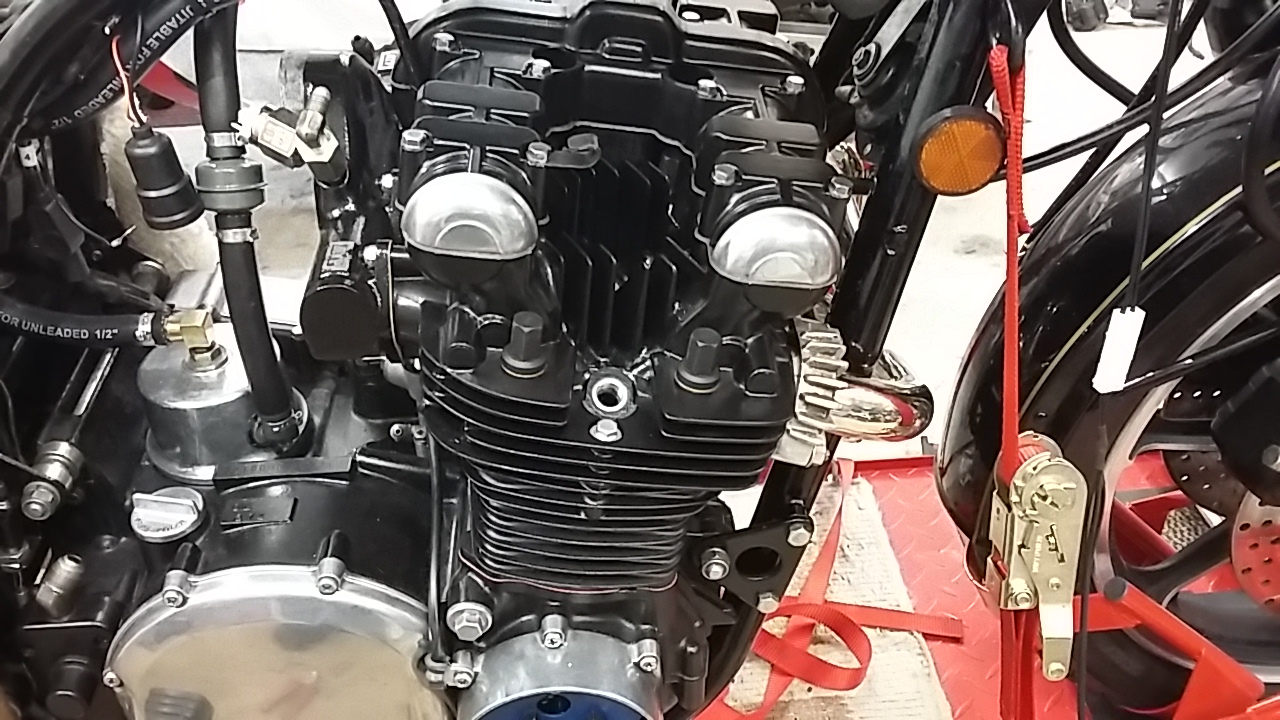

Yes Simoniz all the way.
I've just painted the top end on this Molly Z1R-TC and it's beautiful as always.
