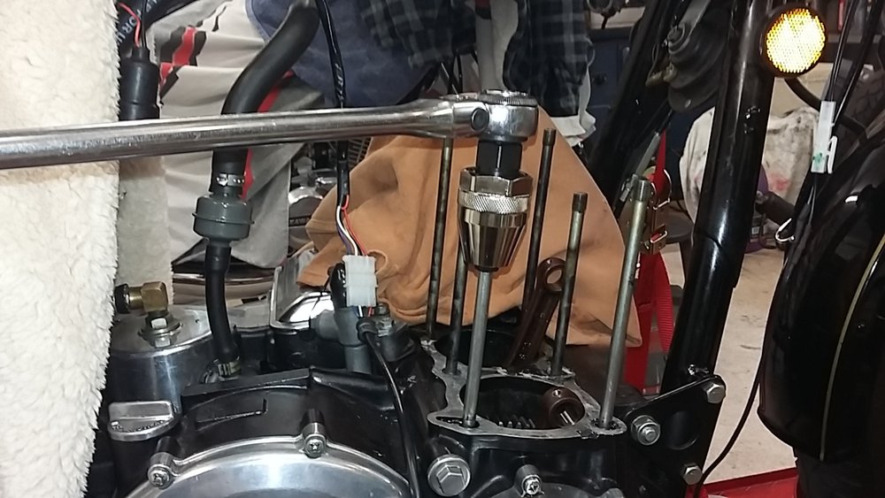

No point in removing them unless they are being replaced by HD ones or NOS in which case it doesn't matter if they get destroyed.
I used a Britool cam type stud extractor to wind them out and I place it as close to the bottom of the stud as possible to prevent the stud twisting and snapping.
It does leave deep knurl marks on the studs but I never re-use them once removed.
If you want to protect the studs plating from the blasting media (if they are not already rusty) the simply mask them off with some rubber tubing.

You need to use an extractor as described that grips the stud close to the crankcase .
Using 2 nuts risks snapping the studs.
