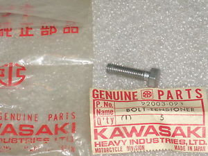

#10 PostAuthor: z1bman » Thu Nov 02, 2017 12:35 pm
this is the bolt for the automatic tensioner

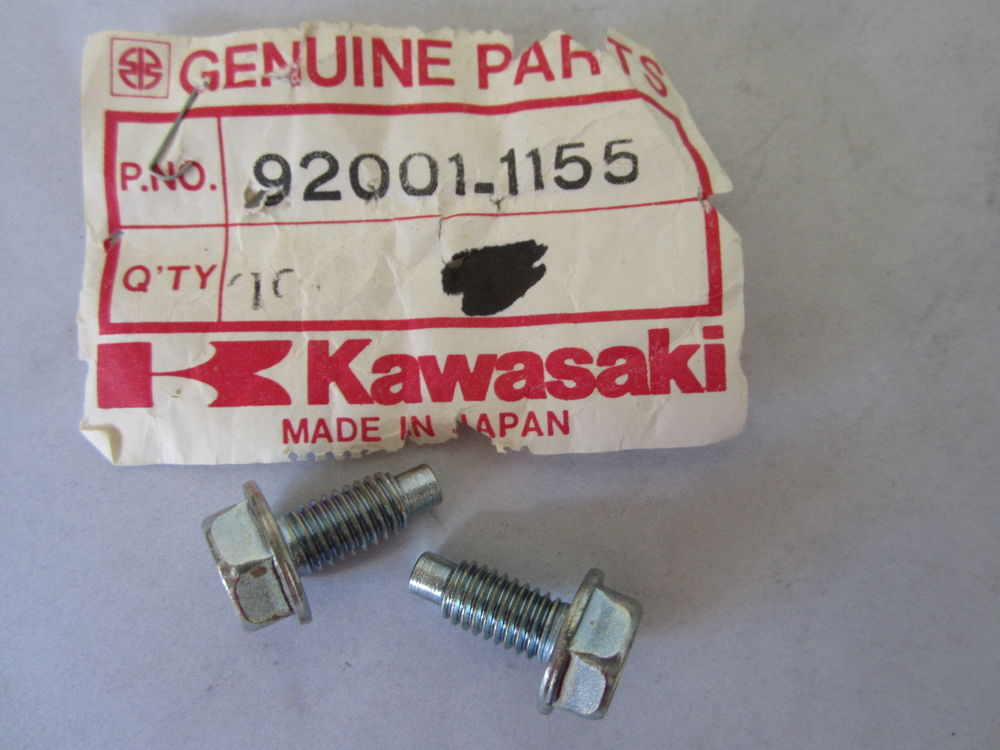

#11 PostAuthor: z1bman » Thu Nov 02, 2017 12:39 pm
this is what you should have for the a1 manual tensioner

#12 PostAuthor: ChrisB » Thu Nov 02, 2017 6:53 pm
yep, that's what i 'should' have. What i've got is a 30-45mm allen headed M6 bolt!
