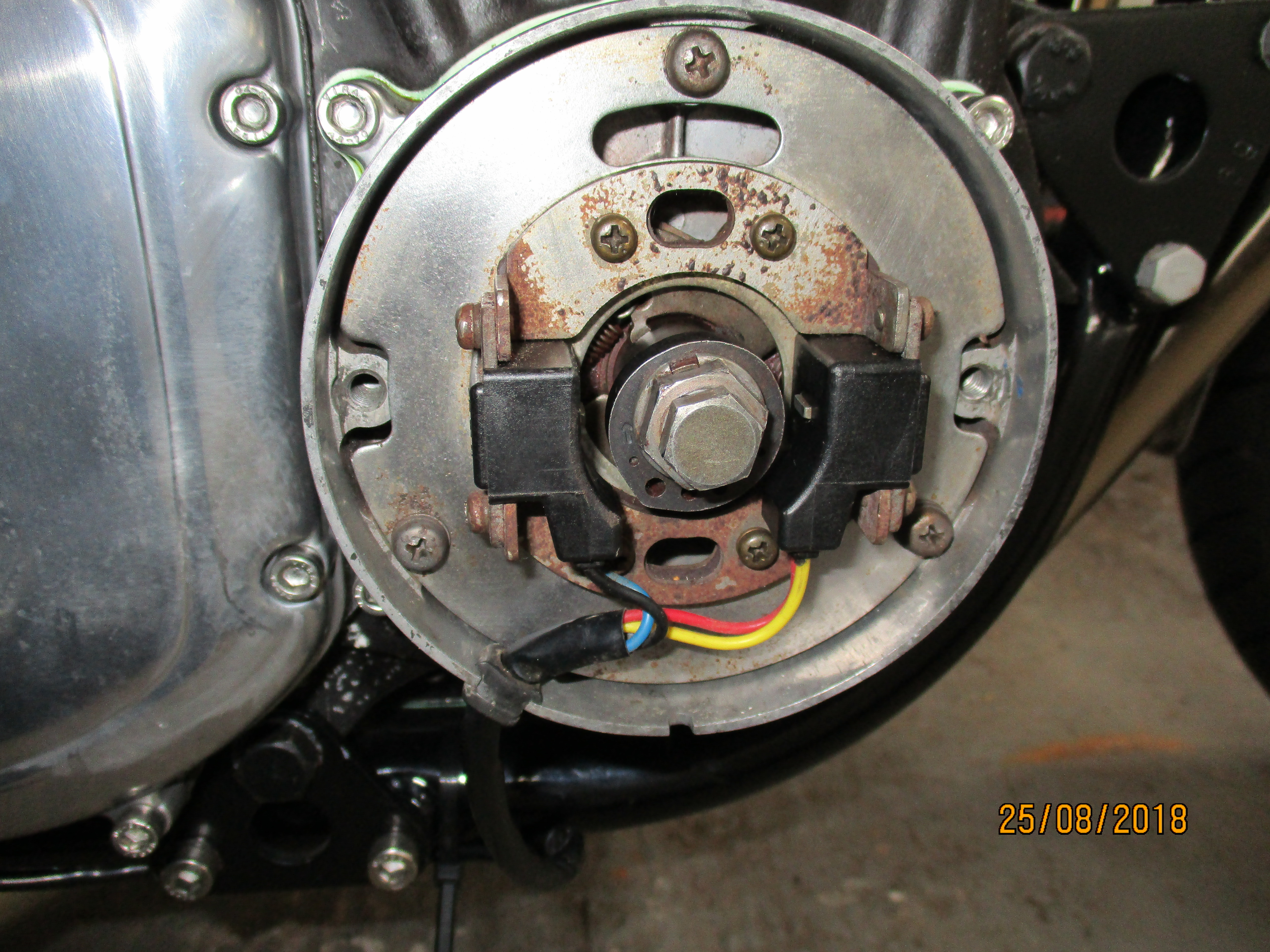

I have put new throttle cables on and resealed the in let rubbers. I checked the ignition cam rotor and the bolt was loose. The bike is going for an mot re test tomorrow, i am hoping this is the problem.

#4 PostAuthor: Dunlop4 » Sat Aug 25, 2018 11:49 am
I still have the problem of the revs holding at 3000 RPM, decelerating whilst riding. The ignition rotor was loose, i have tightened this. there is an noticeable improvement in that the revs hold at 3000rpm and not 5000rpm.
Apart from this the engine is running well

#6 PostAuthor: Philippe » Sat Aug 25, 2018 2:39 pm
Hi Dunlop4
remove the timing advancer, disassemble it, clean out the old grease, clean it again, put new heat resistant grease inside and reassemble. Tighten the mounting bolt to 2,5 kg-m (18,0 ft-lbs) of torcque. Things might be better...if not, you can be sure that the timing advancer is not the cause.
