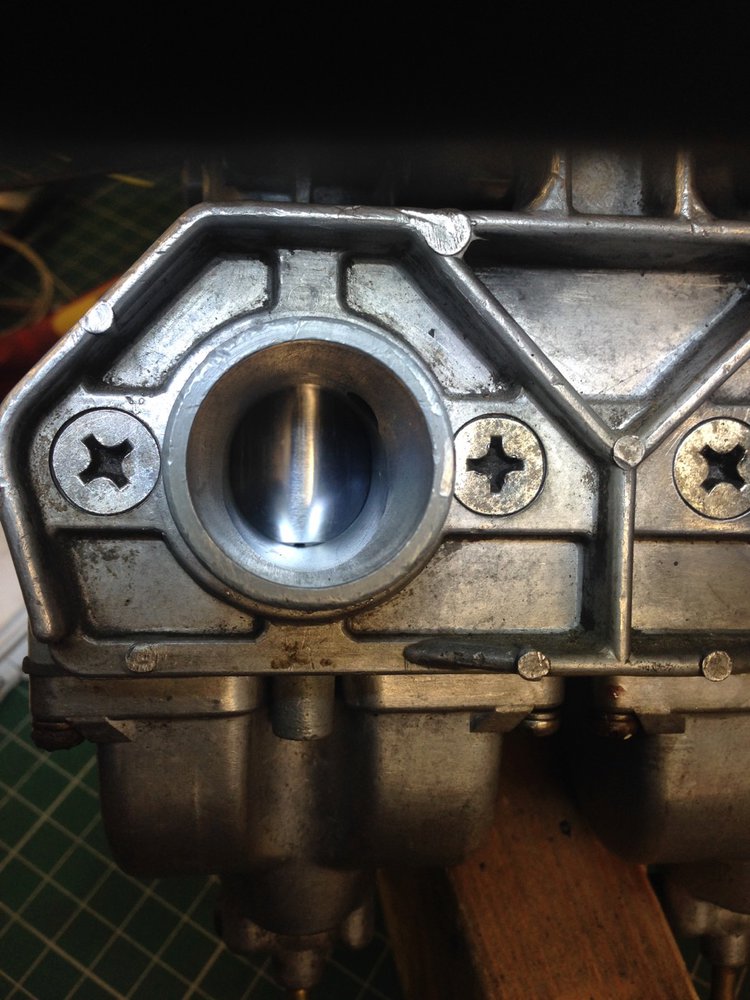

Still a bit stuck, so returning for more help/ideas!
I did this initial wire method, measuring fro the side nearest the engine.
I got the gaps to be all the same, around .75mm.
That page I showed in my first post shows the locknut to tighten.
The problem is that the screw isn't in far enough for the lock nut to catch on the top of the body.

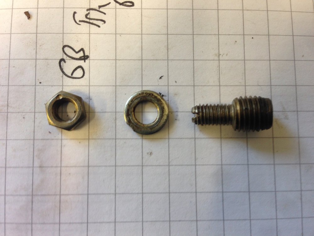

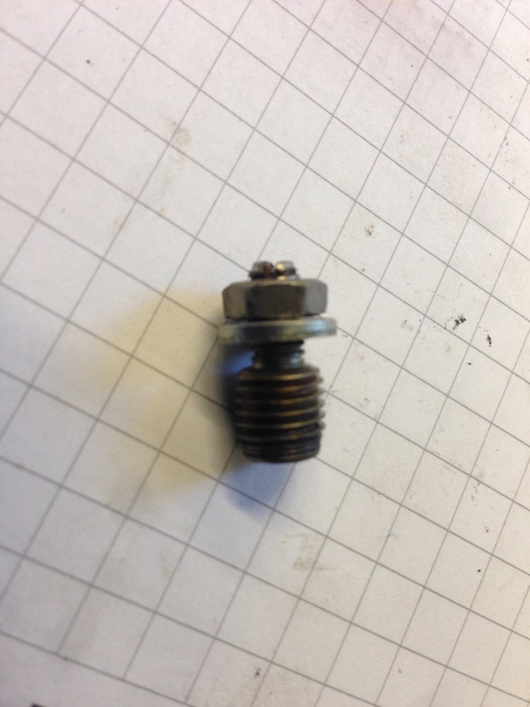

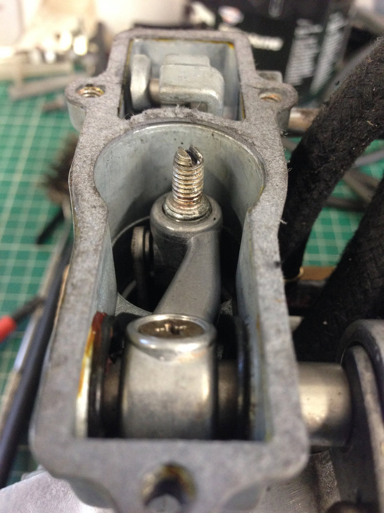

Here's pictures of where my adjustment screw has ended up (for the nut to lock those the thicker thread needs to be lower?), and photos of the screw and locknut & washer to explain better than I can type.
Currently, if I open the throttle, all slides clear the top of the bore by a small margin, and all seem about the same height.
Can't figure out what I've done wrong. I don't THINK I've assembled that linkage wrong, there's not much I could have messed up...?!

You need to start with the adjuster screws turned a few more threads in so that the top of the larger thread is below the surface before you start and then level the slides with the wire method and make sure you only turn the screws clockwise from their initial position.
That way the nut and washer will be able to lock on the top of the throttle arm .
Use the idle screw on the cable reel to lift the slide bank up far enough to allow the slides to hang in their bores so you can do this.
The slides will still lift clear of the venturi at full throttle.

Re: Carb adjustment query
Kwackman wrote:
Ta for the reply Zed1015.
If I start with the adjuster screws turned in so the lock nuts can do their work, the gap decreases and the wire won't fit in. The adjuster screws control the gap.
No! The adjuster screws only adjust the slides in relation to each other.
It is the idle screw that runs on the cable reel that the controls the gap ( slide heights )
You are starting with the slides too low in their bores with the idle screw backed off that far that it isn't lifting the slides first.
Use the idle screw to lift the slides enough so that you can drop the slides back down on their adjusters to get the required gap and also the nuts to lock on top of the arms.
