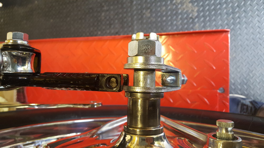

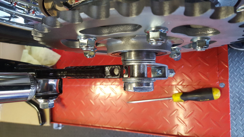

#4 PostAuthor: Wrigers » Sat Jan 26, 2019 2:36 pm
Best explained with a couple of photo's I think.
The rear end came with a concoction of spacers, I've already replaced the right one, now correct.
When the full wheel is offered up to the swinging arm, it won't go in by around 5mm. That's why I think the spacer is wrong and possibly from another model.

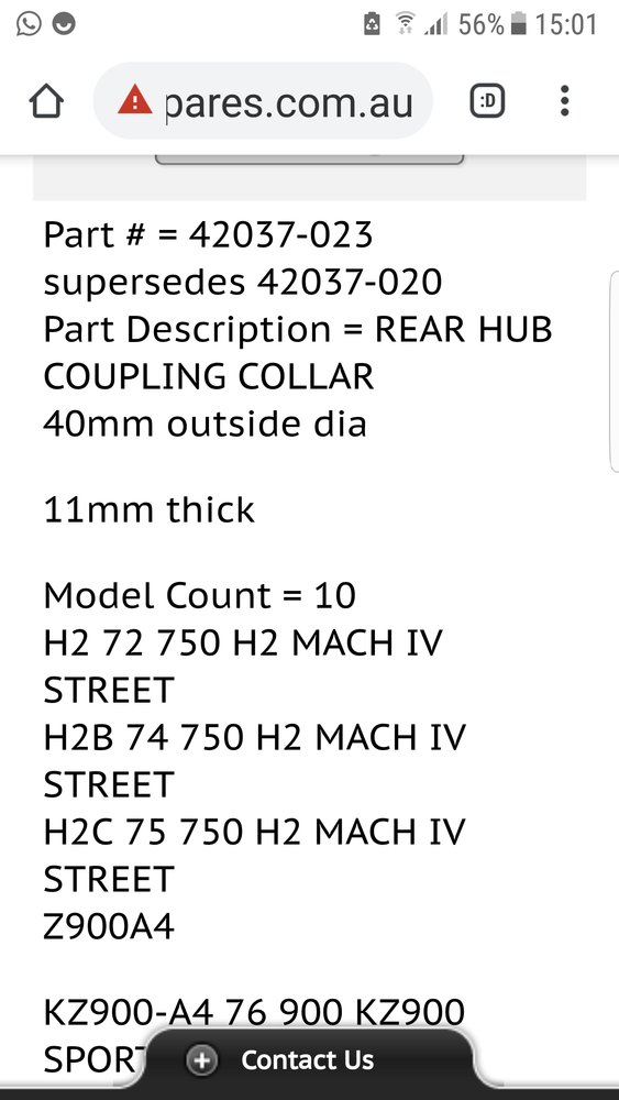

Think I've sorted it. Found this info on Z1 Part Aus....
Thinner than mine by around 5mm.

As Phillippe said take off your sprocket & turn the spacer around the one that has a collar on it ,my spacer only comes out of the sprocket 5mm yours appears to be about 10mm

the spacer of a z900 is 10 mm thick (n° 42037023), the spacer of a Z1000 is 15 mm thick,(n°42032071) I think you have a Z1000 spacer.
Sorry about my previous mail :blush
Took one out of my spares box, was a Z1000 spacer...
