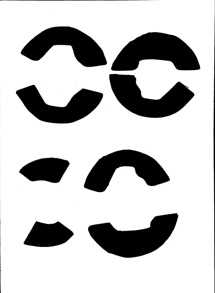

Cheers Cas, I plan to get a set from Dave although the foam is in a bad way and disintegrating rapidly with every touch. Was wondering if it might be worth cutting out some correct shapes from 'funky foam' and resticking?

I've tried cutting foam draft excluder in the past to save money, very tricky :oops:

One of the guys on here did some from sticky back foam for me I photo copied them as templates so print this full size a4 and use them as a template.

Many thanks for that, Ive gone and bought some 5mm sticky back foam from Ebay, a 10mm hole punch and a scalpel today- total around £15. You'd think there would be a specific part what with all the Zed specialists out there these days!
