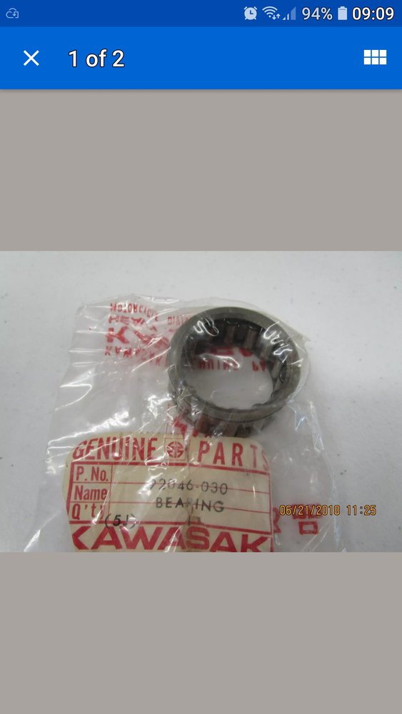

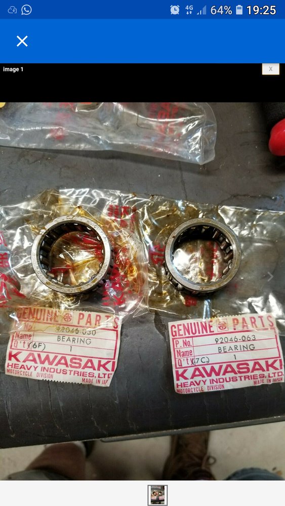

Hey guys I need your knowledge on this one. Long story short I damaged the end roller bearing on my crank yesterday and I need to replace it but the illustrations don't show bearings on the D1 crank will this fit in my crank and which one the 030 or the 063 type?

Can't help with the part numbers as i'm currently away from the workshop but the D1 crank takes the same bearings as all Z1, Z900, Z1000 through to Z1R D1.
The D2 , ST and MK2 all use the later "Square cam cover" motor that uses a beefier crank and slightly different bearings.
I suspect the bearings in your pic are one each of a crank main and a bigend.

92046-063 superseeds 92046-030 both the same but 063 is the newer part
