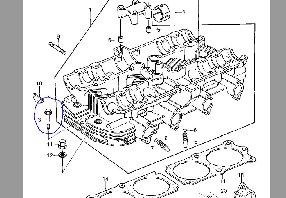

One of the M6 side bolts (See pic) has stripped the thread in the barrels. So won't tighten properly, get so far then slips.
Does anyone have a recommendation for this?
Regular Helicoil insert? OR tap out and use oversize bolt?
I've heard some differing opinions so thought I 'd ask the forum.

Definitly go for the helicoil option.
Depending upon your level of competance you might be able to fit a helicoil in situ, but really the best option would be to remove the barrel to fit the helicoil. Once fitted correctly a helicoil thread will be stronger than the original tapped hole.
I woud never drill out something like this to fit an over-size bolt.

Hi CAT3
OK thanks for your thoughts.
I've got to take the barrels off anyhoo so that's no problem. Leaky base gasket!

OK helicoil. May even do both as they seem a bit prone to this.

Has to be Helicoil or time sert.
There's a hollow steel dowel that locates the head on the barrel in that location so an oversize bolt is not practical.
And yes! do both as the other is guaranteed to strip when you put it back together if you don't.

Take it from one who has learned the hard way.... its hard to drill accurately through the stripped hole perfectly square from all directions with a hand held drill, especially if the head is fitted to the bike.
If at all possible get the head off and drill the hole out using a pillar drill - you risk it all going horribly wrong if you don't.
Olly

OK thanks - Yes bound to strip on the other side.

Also worth noting 6 or 7 ft/lb is plenty for these some of the manuals state 12 ft/lb which is too much and why they tend to strip, same with cam cap bolts.

Just had to do this on latest ‘72 engine build.
If you can go the Timesert route as a superior
product to helicoils but tooling isn’t cheap.
I’ve got one side that I used a Timesert and the
other was oversized so required an insert, I used
an A2 Self tapping M6 ST ST insert supplied by a
company called ACCU
www.accu.co.uk punch in the A2 text above.
Cheers Mike
company called ACCU

Mike, been using them a long time where there is sufficient wall around them, they are good.
