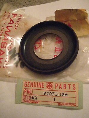

Reference the damper, i don't have one. What is the part number for that. My sequence is.....

it should look like this
