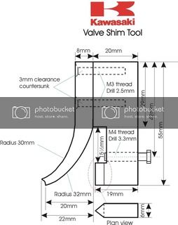

dimensions can be found here
viewtopic.php?t=22706&start=15

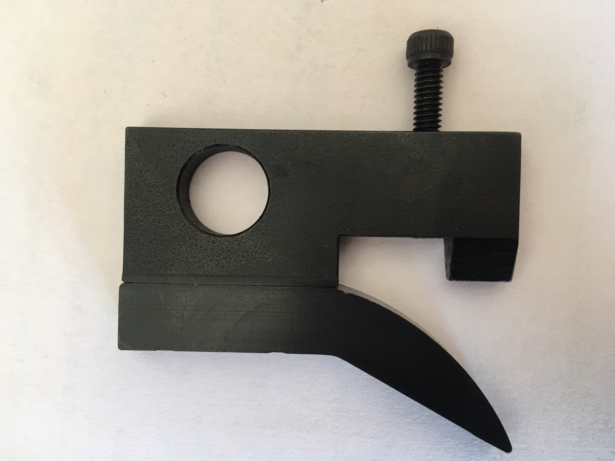

Here is the tool Z-Power sent me. It looks exactly the same as the drawing BUT appears to be too small to reach the valve lifter. It fits but does not hold the valve down.
Is it possible that what they sent me is for a smaller bike - do they do one for the Z650 for example?

Hi,I bought a Z Power tool a few months ago to do the shims on my Z1000A1.
Initially it would not reach the valve lifter, but a mate told me to remove the cam cover gasket (which being mean, I was trying to preserve :oops: ) - and that little bit of clearance made the difference, let it seat correctly, and to my relief the tool do its job.
Not sure if you might have a similar problem ?

#11 PostAuthor: Philippe » Sun Apr 26, 2020 3:28 pm
Hi 1340fxd
like Tonto mentioned before, you must take the gasket off. Before you put the tool in place, turn the buckets so that the cut out points towards the middle of the cylinderhead. It's easier to put a tool under the shim in order to take it out.

Thanks for the suggestions but sadly I have already removed the cam cover gasket so that's not the cause of the problem. Very simply I cannot fit the tool so that it reaches the lifter bucket - so it's not able to do its job. Any other ideas welcome. :??

#13 PostAuthor: warren3200gt » Sun Apr 26, 2020 7:12 pm
Just for info 650s use under bucket shims so cams must come out for those shim changes. There is only one size of tool like that so must be operator error. I dont know what it is your doing wrong as I use the lever type tool to do my 900 and and 1000 and have never tried that type of tool.

1340fxd wrote:Thanks for the suggestions but sadly I have already removed the cam cover gasket so that's not the cause of the problem. Very simply I cannot fit the tool so that it reaches the lifter bucket - so it's not able to do its job. Any other ideas welcome. :??
The picture of the tool looks to be correct, why not post a picture of your set-up with the tool on cylinder head so we can try to spot anything looking incorrect.

#15 PostAuthor: Al » Sun Apr 26, 2020 9:02 pm
I have shim under so havnt done this for ten years but remember there being a cast boss associated with each valve. Does the tool you have seat neatly with those cast lumps on the outside of the head?
