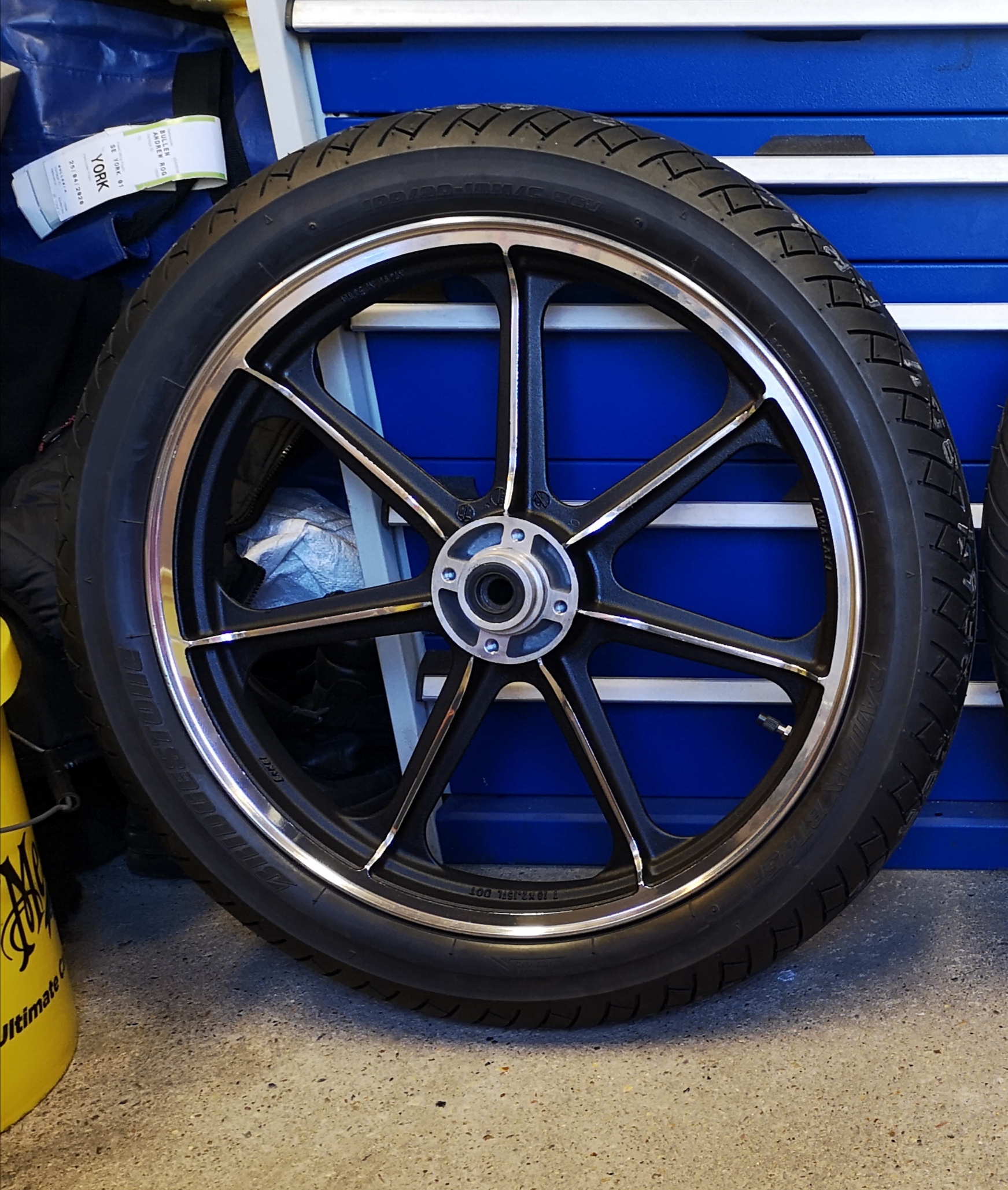

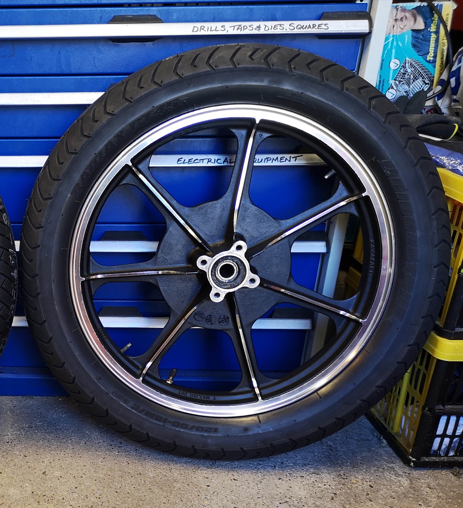

#9 PostAuthor: bulldogbobby » Thu May 07, 2020 7:41 am
Polished and Painted.
Pleased with the results - let's see how they hold up :D

#10 PostAuthor: ADRIAN H » Thu May 07, 2020 1:16 pm
bulldogbobby wrote:Polished and Painted.
Looking Good. :D :D

#11 PostAuthor: bulldogbobby » Fri May 08, 2020 10:53 am
Looking Good. :D :D
:D :up
Thanks mate
