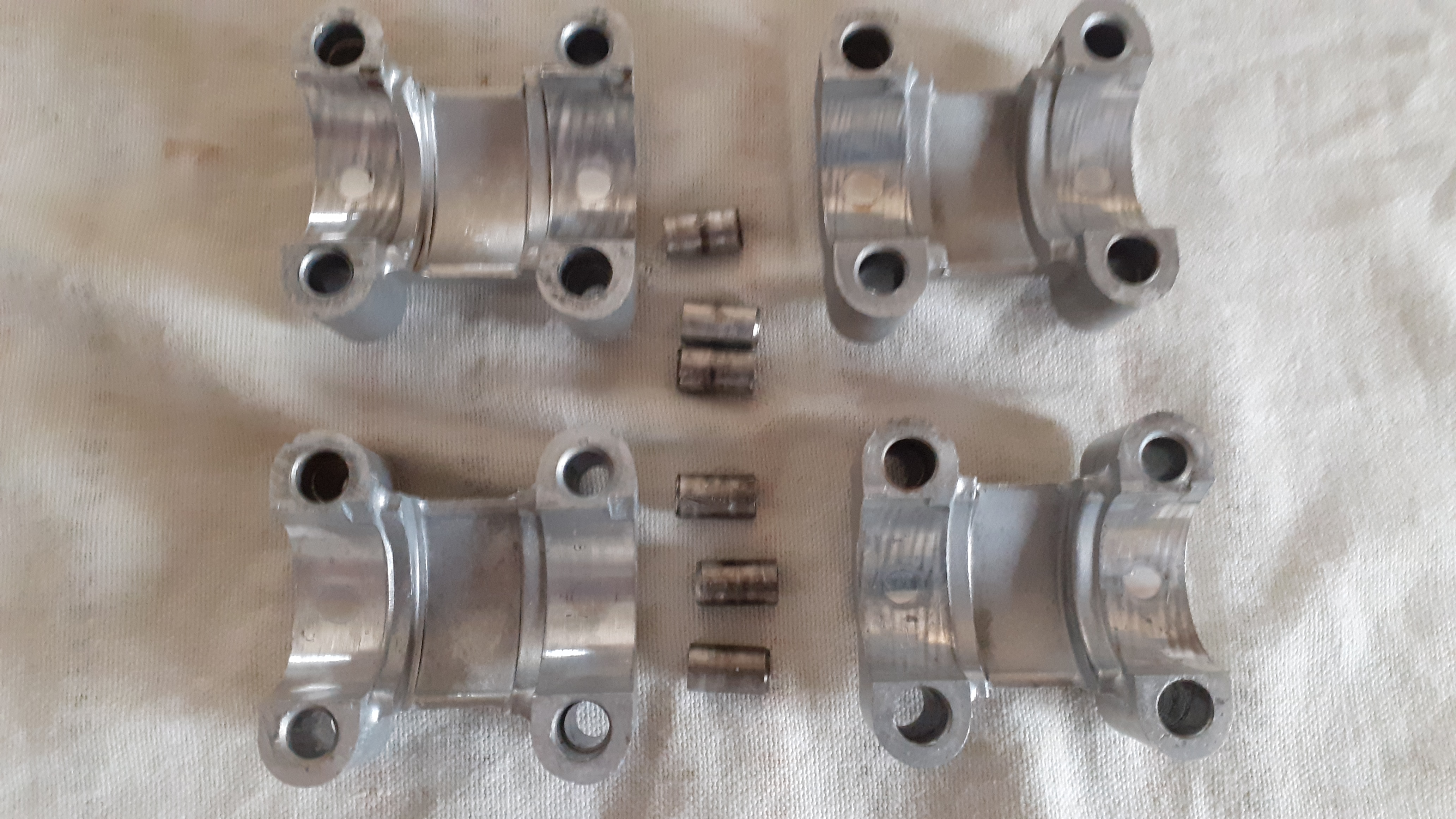

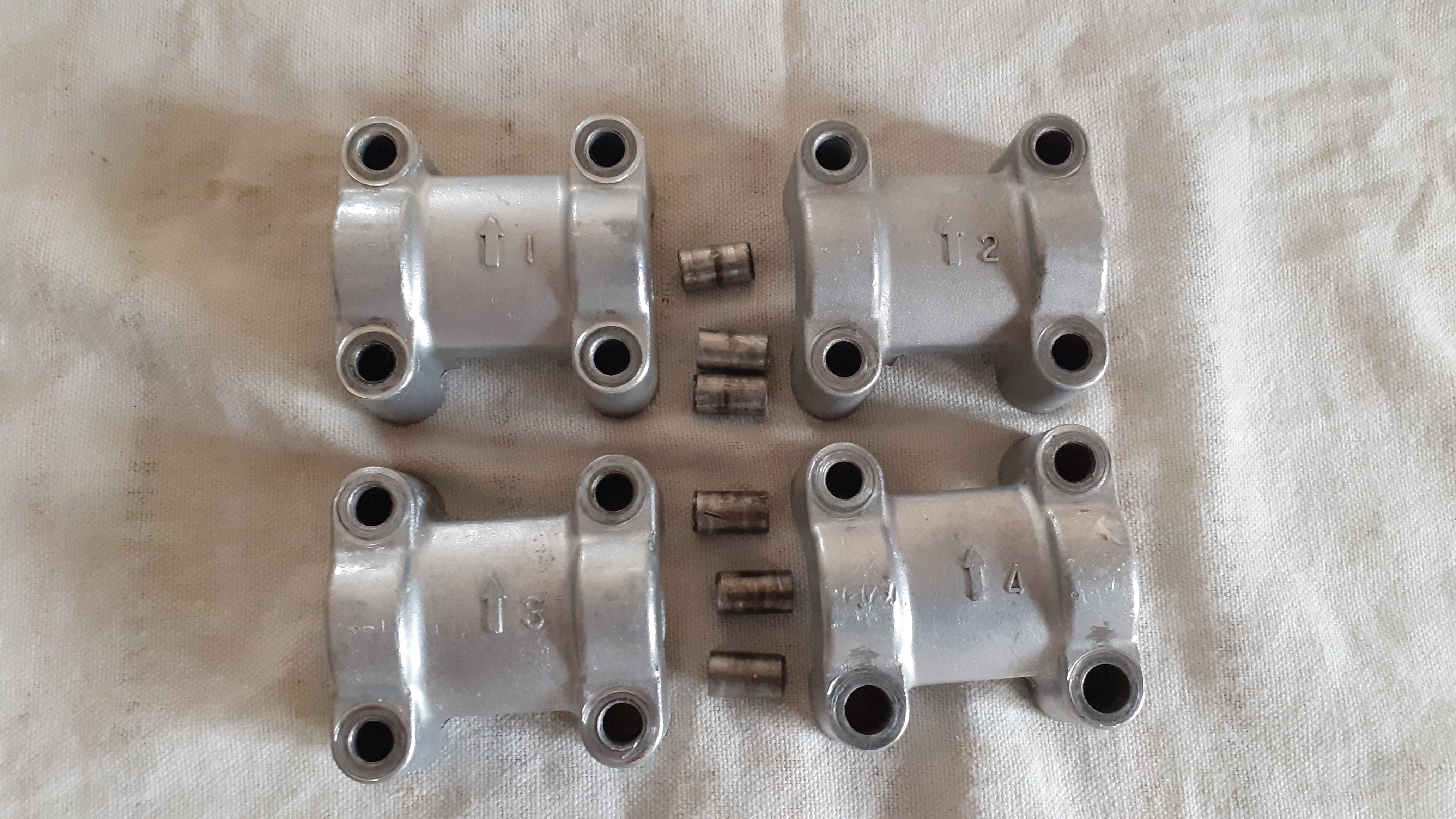

#8 PostAuthor: kev edwards » Wed Apr 29, 2020 8:27 am
P.M'd, number 4 has had 2 holes enlarged.

#10 PostAuthor: IanM63 » Mon May 04, 2020 8:14 pm
Big thanks to Kev for getting his caps to me so fast.
I've now got no.2 & 4 which seem OK but 1 & 3 still not great.
I can get them spinning pretty good with no dowels but clearly that's not ideal.
If anyone else has any 1's & 3's that I could have I'd be eternally grateful. Happily swap for the ones not working for me.
