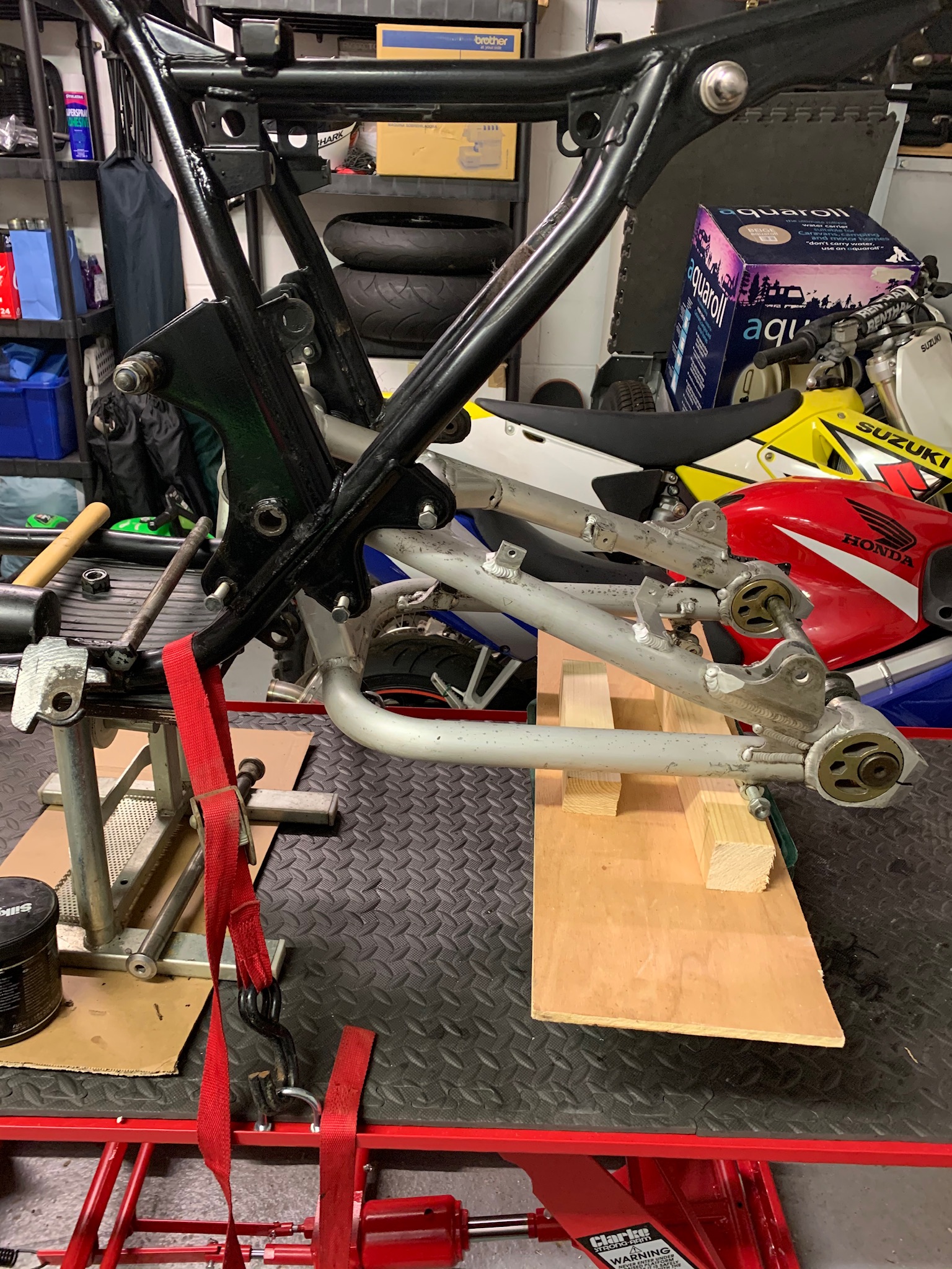

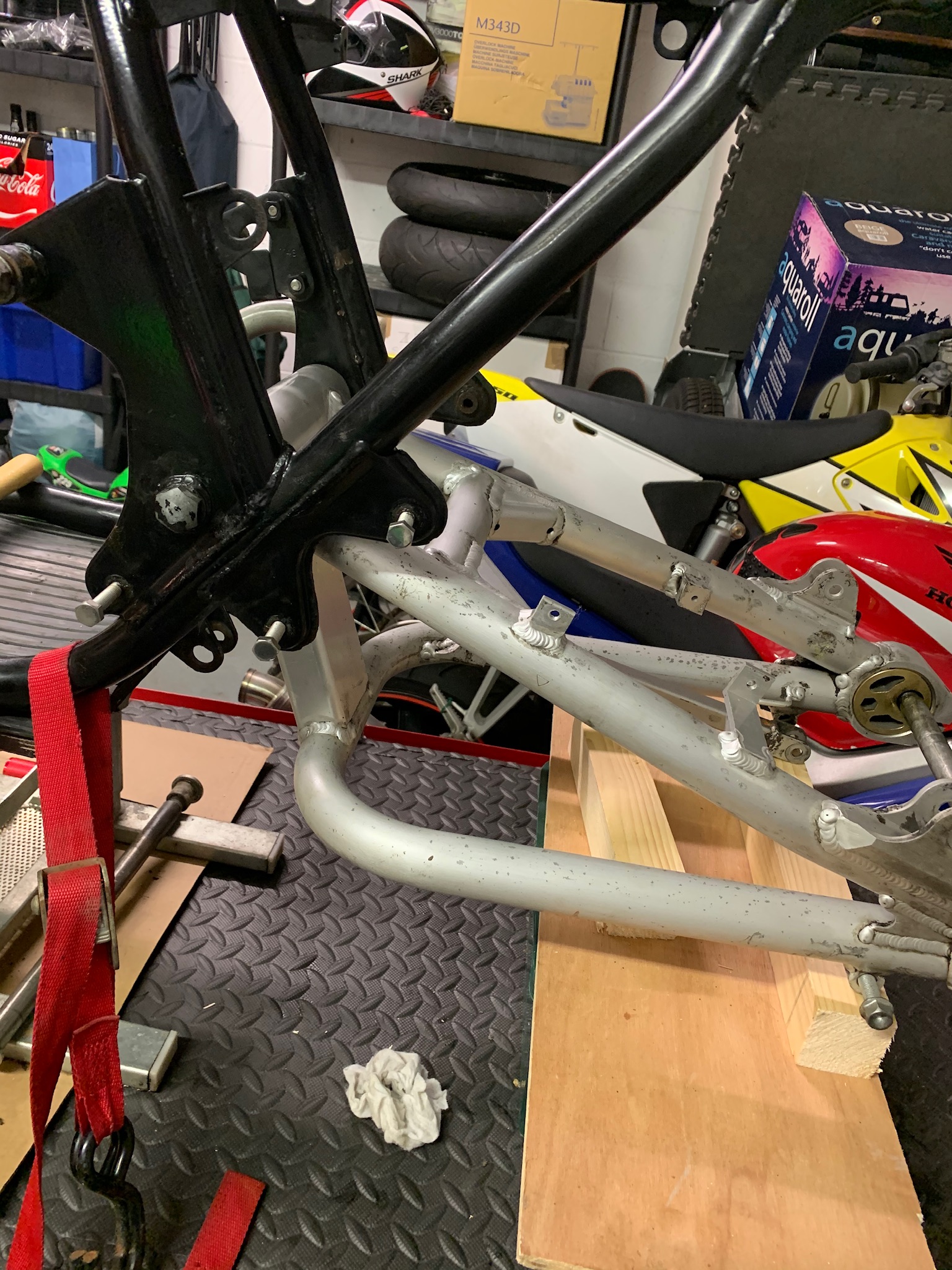

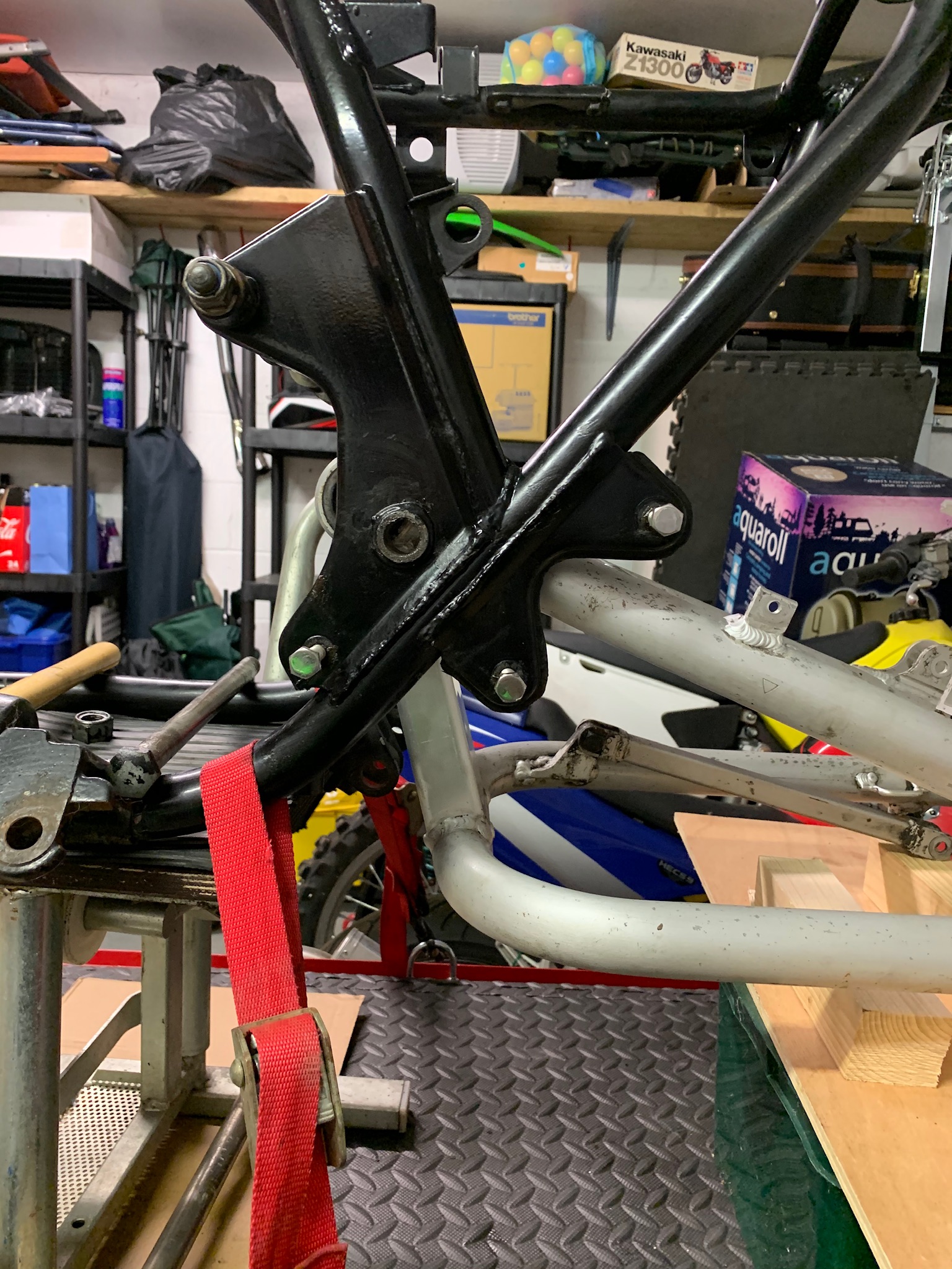

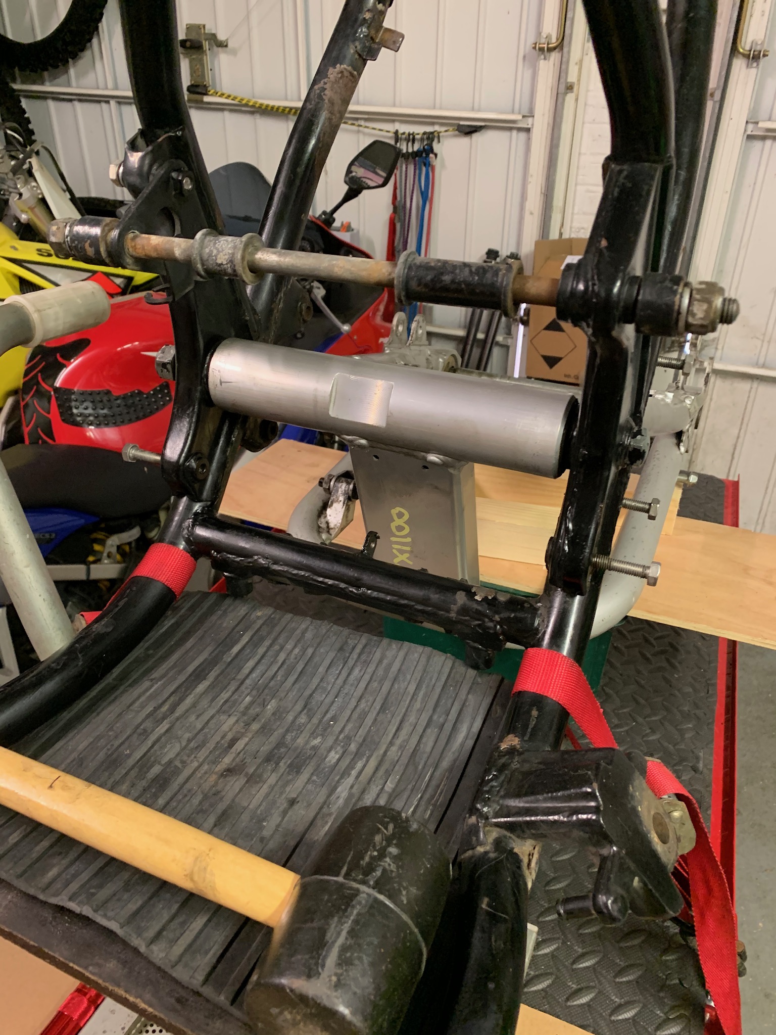

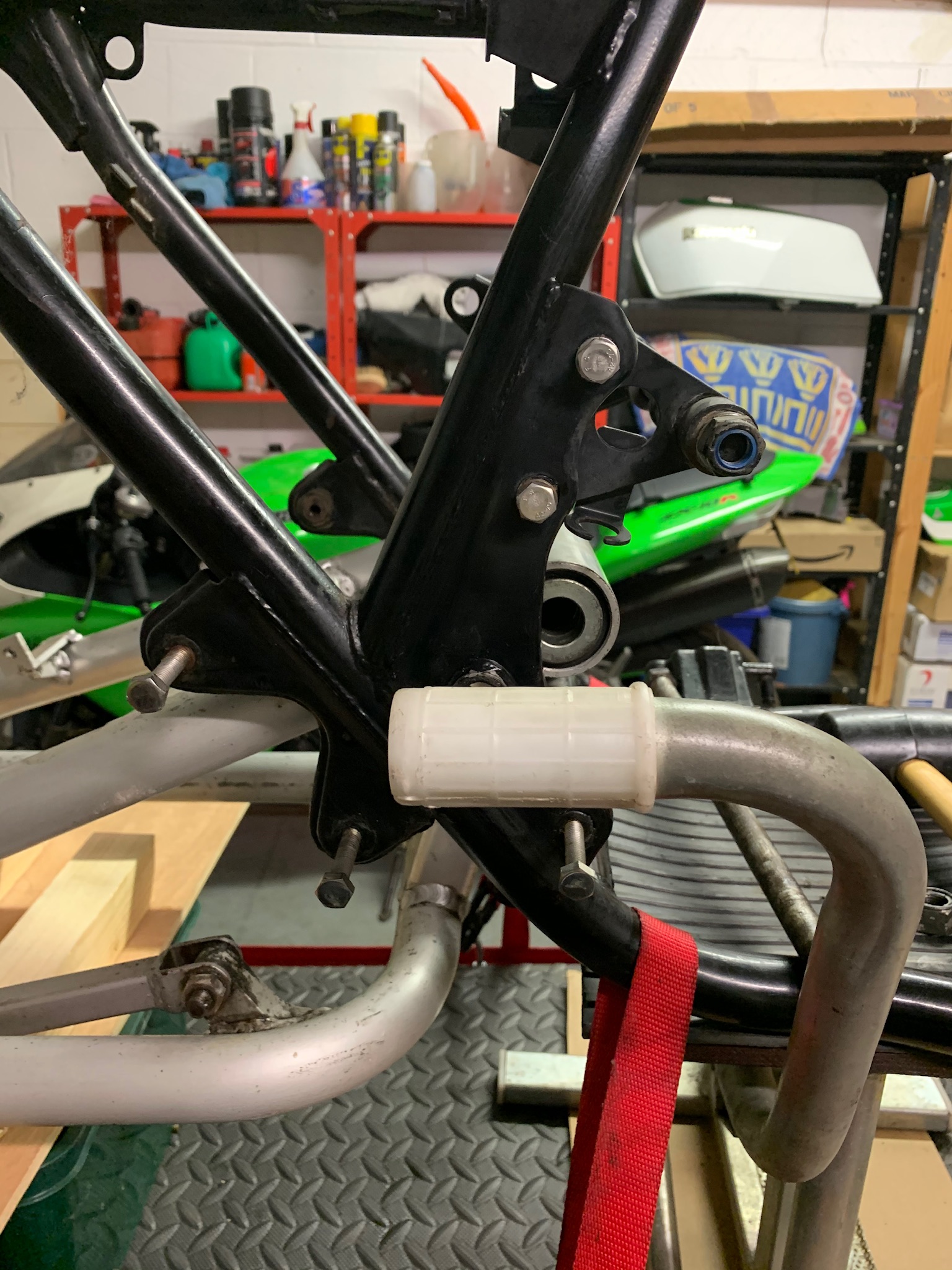

The J is stripped now and I have a bare frame, first thing was to test just how ‘fits straight in’ the ZRX arm actually is. And the answer is not quite.

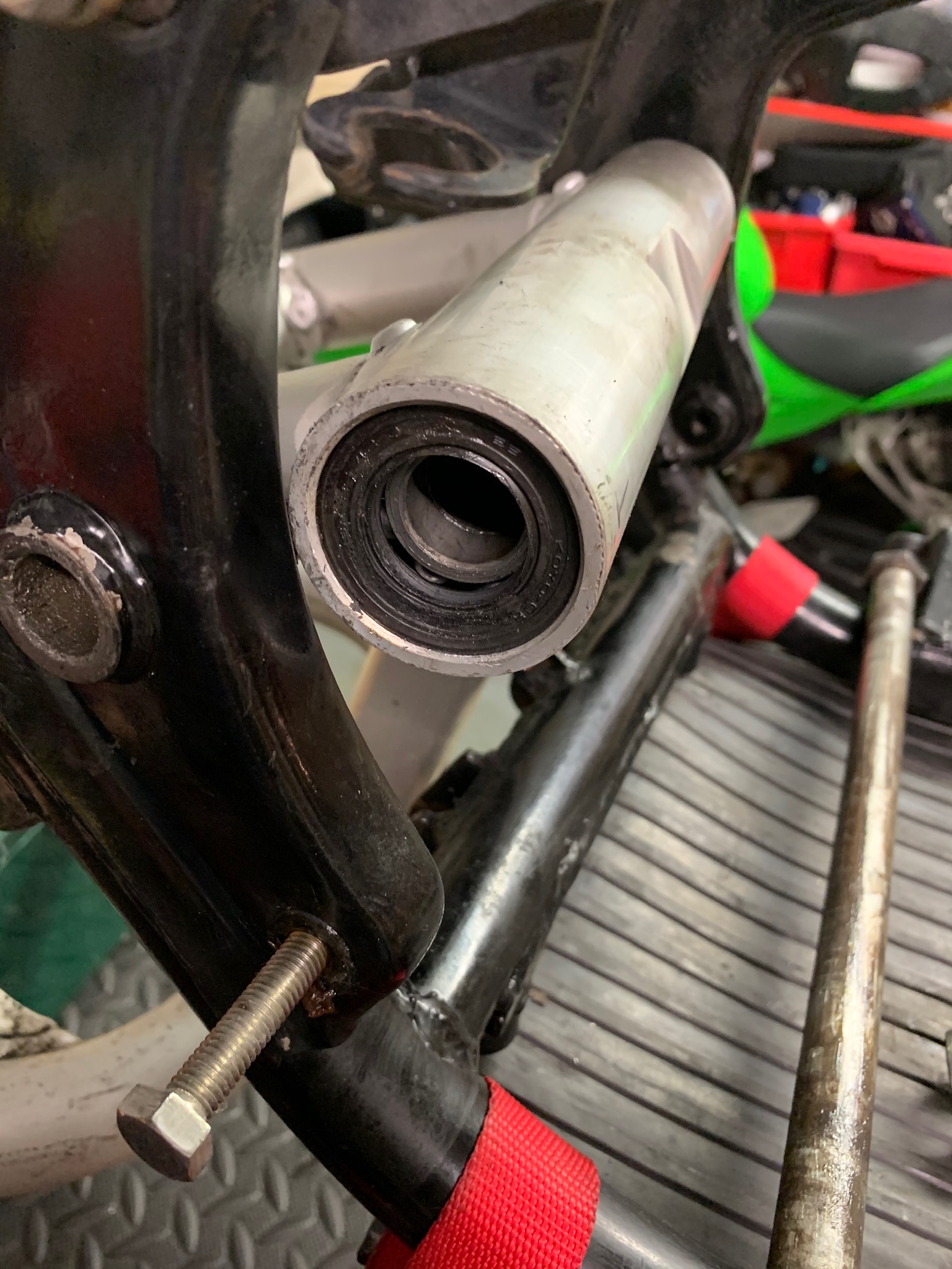

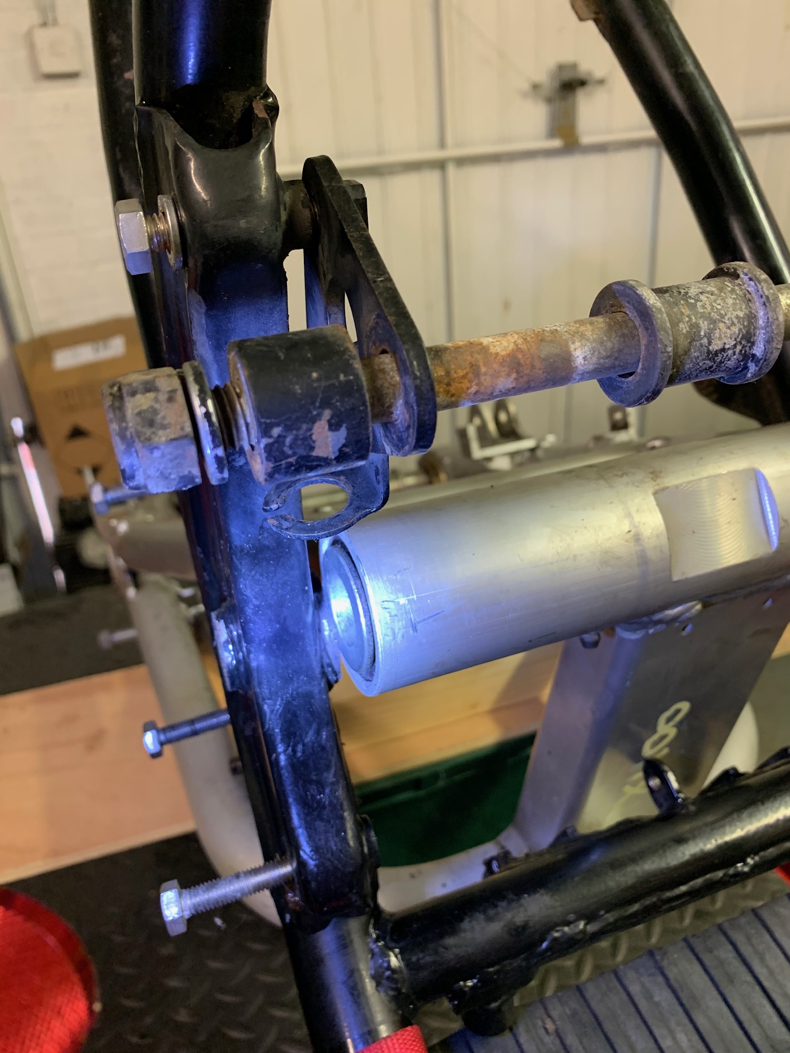

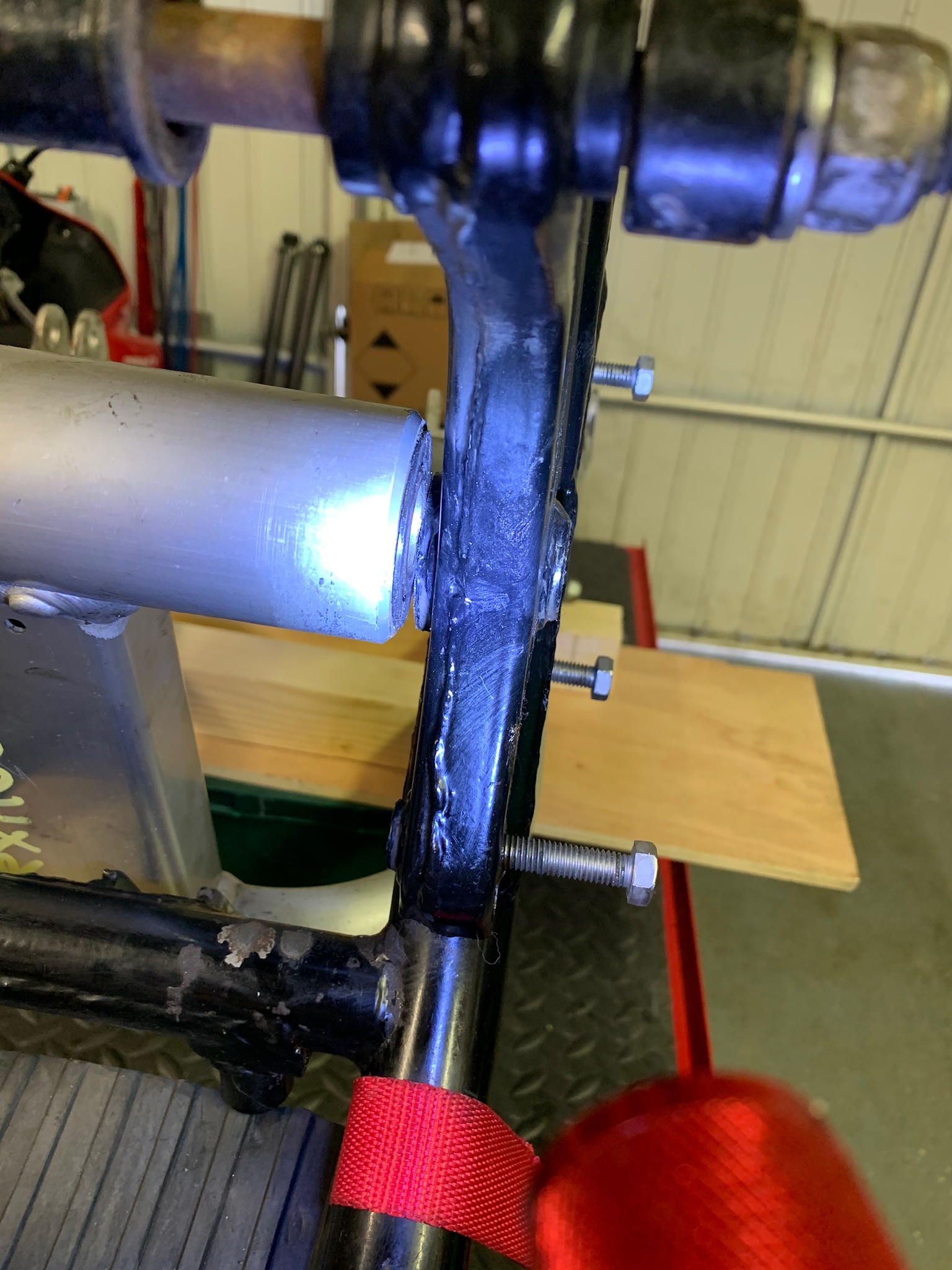

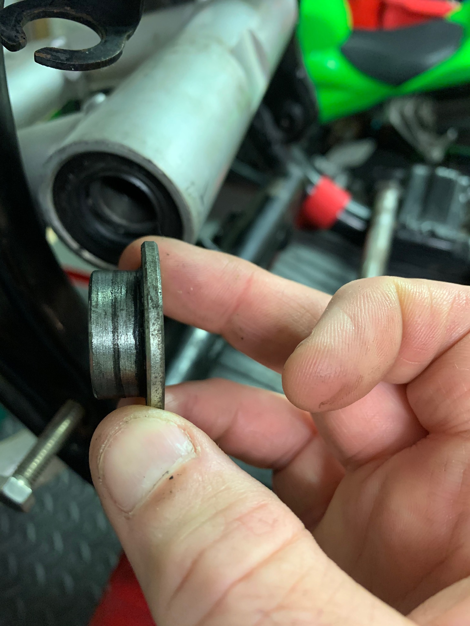

The next pictures show the rhs end of the arm.
With the bush out the arm fits with a small amount of play.
The thin outer face of the bush is almost 4mm.
Question is am I oversimplifying this by thinking a can get another bush with a thinner outer face
Or am I looking at an altogether different solution?
All help and wise words gratefully received. This is all new territory for me.

Simple answer is yes!.
You can dispense with the wider outer face as it doesn't control end float.
Just use a spacer of the same diameter to fit the seal but of the length you require.
Not having done this exact swap myself i don't know if that keeps the wheel true central in the frame so some adjustment of the wheel spacers to correct that may be needed or equal amounts may be needed to be removed from each of the swingarm spacers to keep it central.
