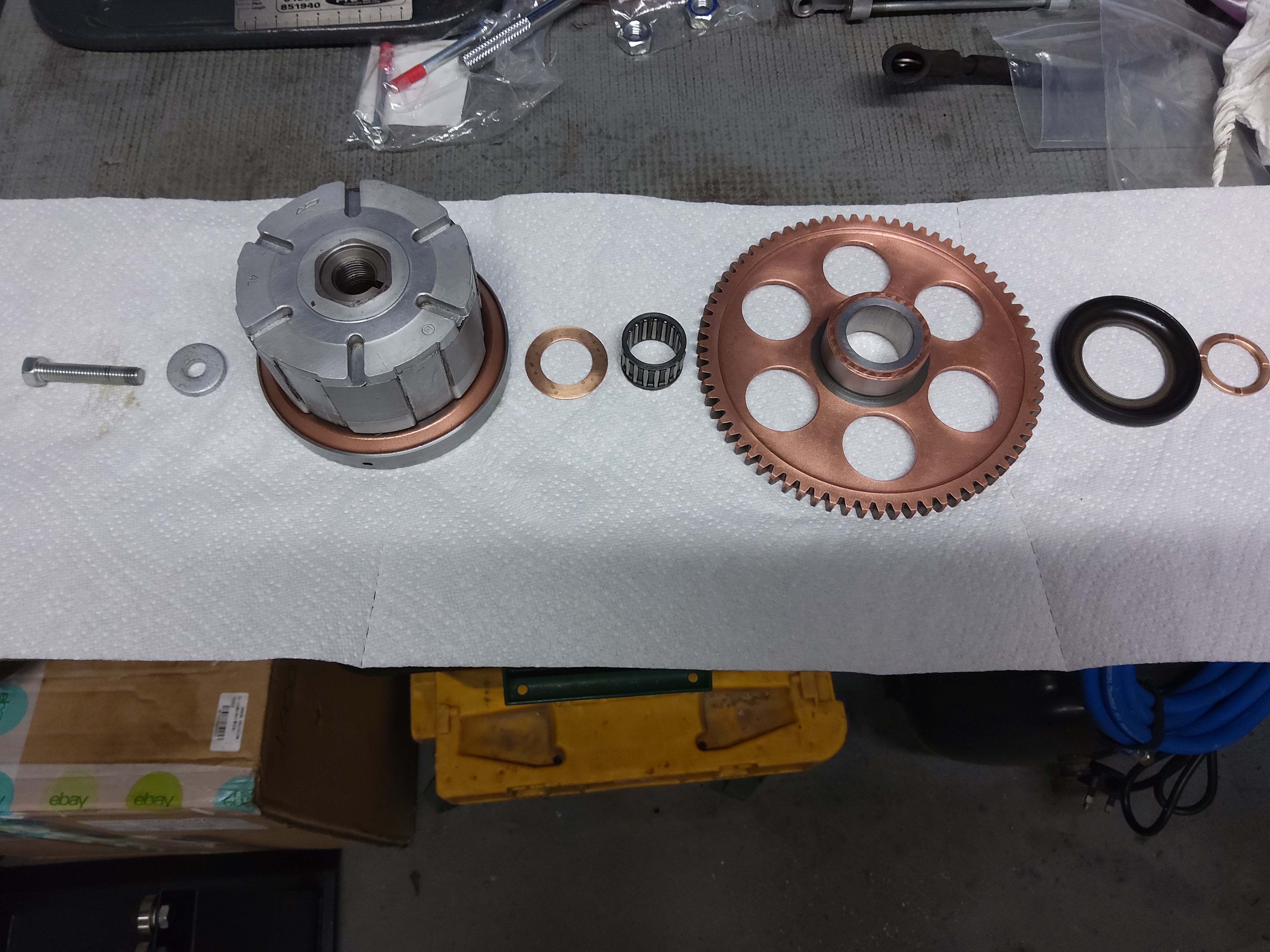

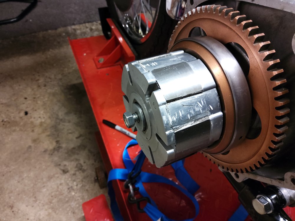

Having lost the original rotor bolt I ordered a replacement from Cradley Kawasaki. The original was 114G0840 which has been replaced by 115BA0840. I had already checked the thread in the crankshaft with another M8 x 1.25 pitch bolt and found it to be very tight. I thought this was probably due to crud build up over 45 years so reckoned I would have to tap the thread out to clean it up. Upon receipt of the new bolt I checked it to make sure it was indeed M8 x 40mm, 1.25 pitch, which it was. It was also a tight fit only going into the end of the crank a few threads. I then started to tap ouut the crank but found I needed much more effort than I would have expected, to the point where I thought I'd jammed the tap in the crank, it needed so much force. I managed to extract it by heating up the crank end although it did make that horrible clicking noise as it came out. I installed the rotor assembly onto the crank and screwed the bolt in as far as I could by hand before it started to really bind but found the head was about 4mm short of the thick washer. I've attached a pic of the gap between the washer and the bolt head and also a pic of the whole assembly, which I'm sure I've installed correctly, with the concave face of the damper facing inwards. I'm loath to continue tapping the crank in case the tap jams again. Barring shortening the bolt can anyone advise what's going wrong?

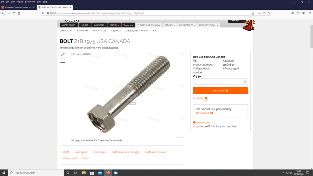

Which tap did you use? Start, middle or finishing tap? What came out on the tap? Was it metal or chewing gum type snot? If it was the later, it may be that someone has loctited the bolt in previously. If so, heat can often be used to soften some loctite varieties to make it easier to get out.Its a job to see but if that is a 40mm bolt then it is 1.25mm pitch. (32 threads showing per the length). If you have a co-responding 1.25mm die, i would run that up on the bolt thread because, although difficult to see, the first few threads look mangled. Looking at the parts diagram on CMSNL for the Z1B the bolt is only threaded half way and relieved the rest of the way. A fully threaded bolt will have a significantly higher friction effect than the original type. If the bolt is of good quality it should be OK but if its one of those nasty rolled threads the 32nd thread may not be the same distance apart from the 1st as it would be with a good quality tap. Meaning they go out of mesh fairly soon.
I believe the effective length of a thread is one and a half times its diameter. Only 12mm of an 8mm bolt it engaged (pulling) with the co-responding hole thread. If the thread in the crank is good i would maybe look to remove the damaged part at the end (first couple of threads) and see how that goes. Failing that, an original format one, if one can be sourced. :cry:

What i was looking at was the CMSNL site and it said something other than that which you had written!

Al - the CMS site also states that the bolt has been superceded by 115BA0840 which is also what Cradley Heath listed and sent me. The CMS bolt you show is a 115 head ('Upset' head). John Brookes notes in the 6th edition of his parts book that "There are 3 types of 'Upset' head screws supplied by Kawasaki, namely 112, 115 & 116 but only the 116 version was used on the Z1 - Z1B." So if John Brookes is correct (and I have no reason to doubt him) the CMS bolt could not have been fitted to any Z1 as original equipment although they state that it can. It may well physically fit but that's another matter. The original bolt is a type 114 which is a plain hex head, not an Upset. The 115BA0840 bolt that Cradley Heath have sent me is the correct size, length and pitch. The problem I have is the crank thread itself. I have viewed the thread internally with an endoscope and although the focus is not that great at this distance (about 1mm) I can make out quite a bit of reddish crud which I believe may be locking compound. It may also be rust. The next stage is to order a TC tap and heat up the crank end to soften up the crud and hope that works. I've now removed the pistons, which I'd previously installed prior to hitting this glitch, so I can put a bar through all 4 little ends to lock the conrods and give me some purchase for the tap (unless someone thinks that's a bad idea re stressing the conrods?).
