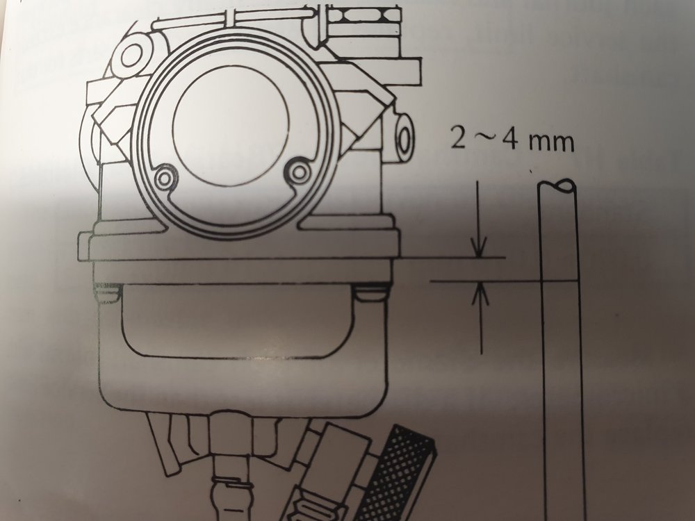

Just setting the float levels using the pipe method. Is the level between these marks or exactly on the base of the carb body?
Many thanks

#2 PostAuthor: Bill P » Tue Nov 03, 2020 8:46 pm
I always set mine as close to middle as i can :)

#3 PostAuthor: kev edwards » Wed Nov 04, 2020 9:26 am
Like bill says,I have always set mine midway between the marks, firstly i measure the float levels with a ruler to get a rough position.

#4 PostAuthor: Ultim8pc » Wed Nov 04, 2020 10:12 am
Measure and set the float height as per manual and then check the actual fuel level. Set in between the lower and upper edge of the bowl as shown and you'll be good to go.

#5 PostAuthor: drydockdavies » Wed Nov 04, 2020 1:21 pm
Many thanks, three just below carb body, one too high. Set and adjusted using zpower tool. Set the carbs up in the bench vice, still managed to cover myself in petrol!! :roll:
