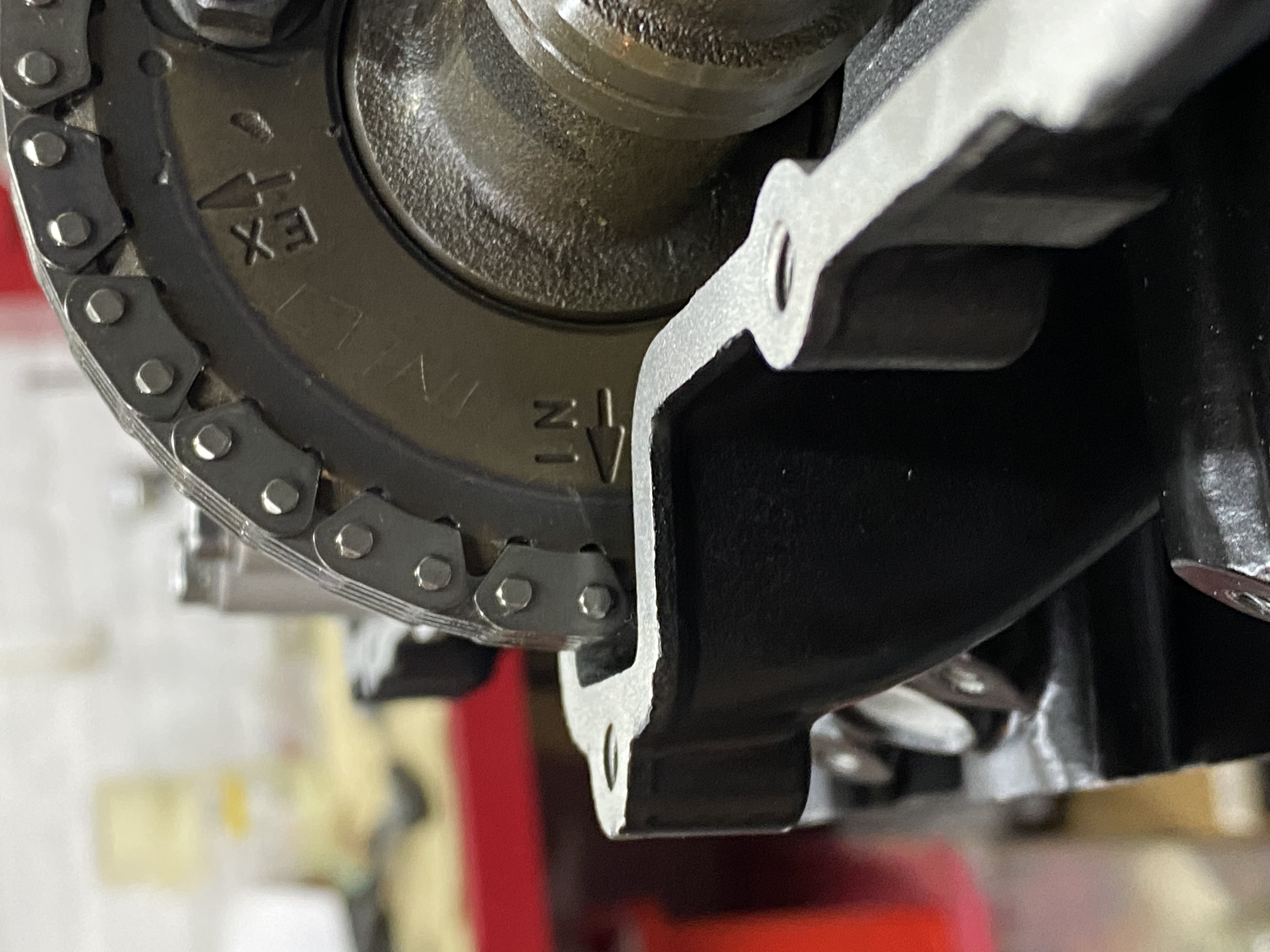

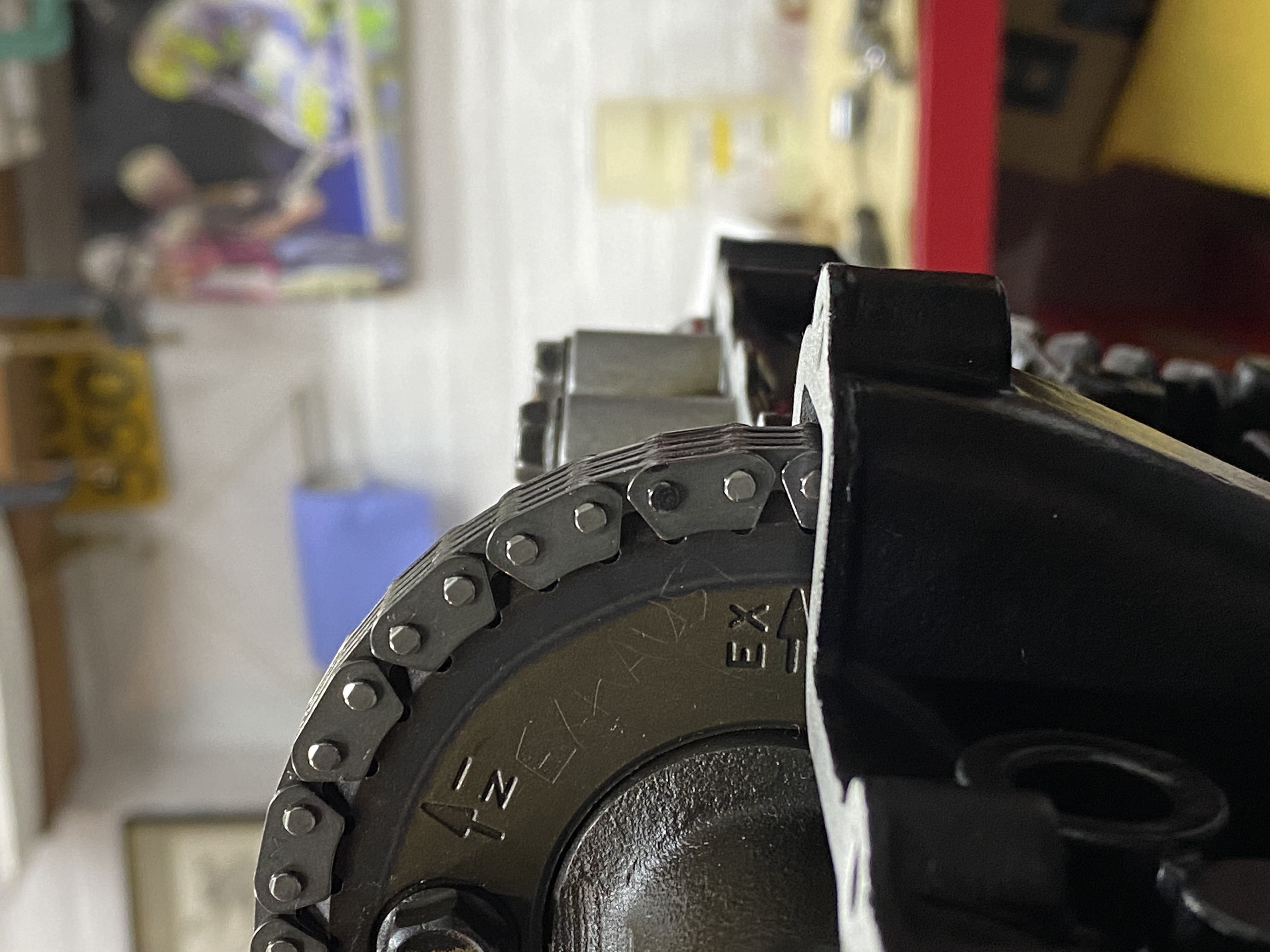

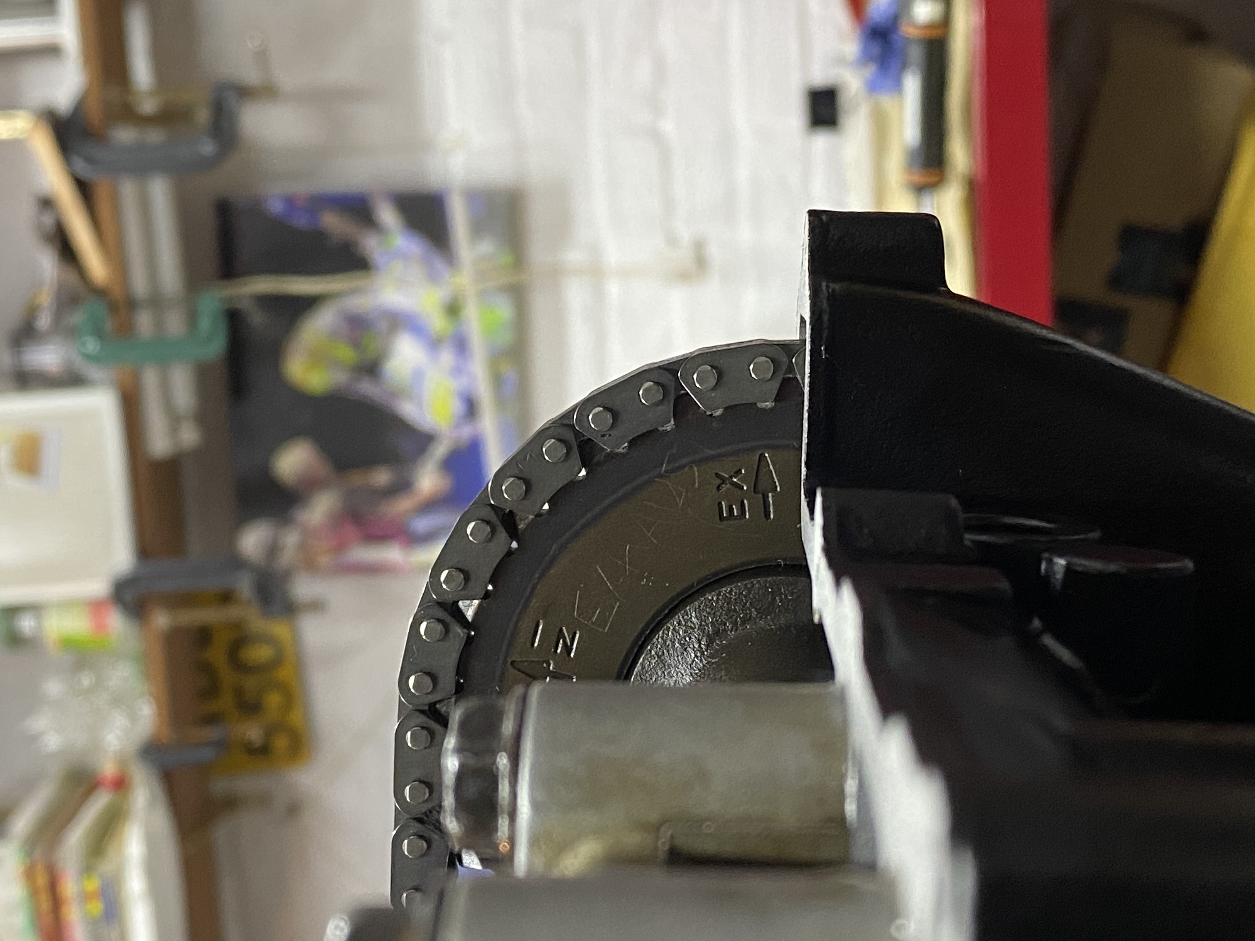

Tonight I put the camshafts back in the engine.
I followed the manual aligning the cam shaft marks when the timing mark was on 1 4 T. Then I set the exhaust cam as per the manual 44 pins back. All looked good.
After tightening it all up I fitted the tensioner and turned the engine all the way round back to the 1 4 T mark.
I now doubt it is right.
It looks like both cams might be one pin back on the chain but if I take it apart and rotate the cams clockwise by one pin it might look like they are too far clockwise.
Hope that makes sense.
Also it’s a brand new cam chain.
Any suggestions ?

The EX cam mark should be closer to the gasket face but that is determined by the the deck height and whether the head has been skimmed etc.
I would move it to the next pin and have it slightly below the gasket face as this is less degrees out than current and almost certainly the correct position with the new chain .
The inlet timing at 44 t back from this will be correct in relation to the exhaust but not in the correct position until the cam cover has been fitted as this pushes the chain down and pulls the inlet sprocket clockwise.
The tensioner must be removed before fitting the cover .

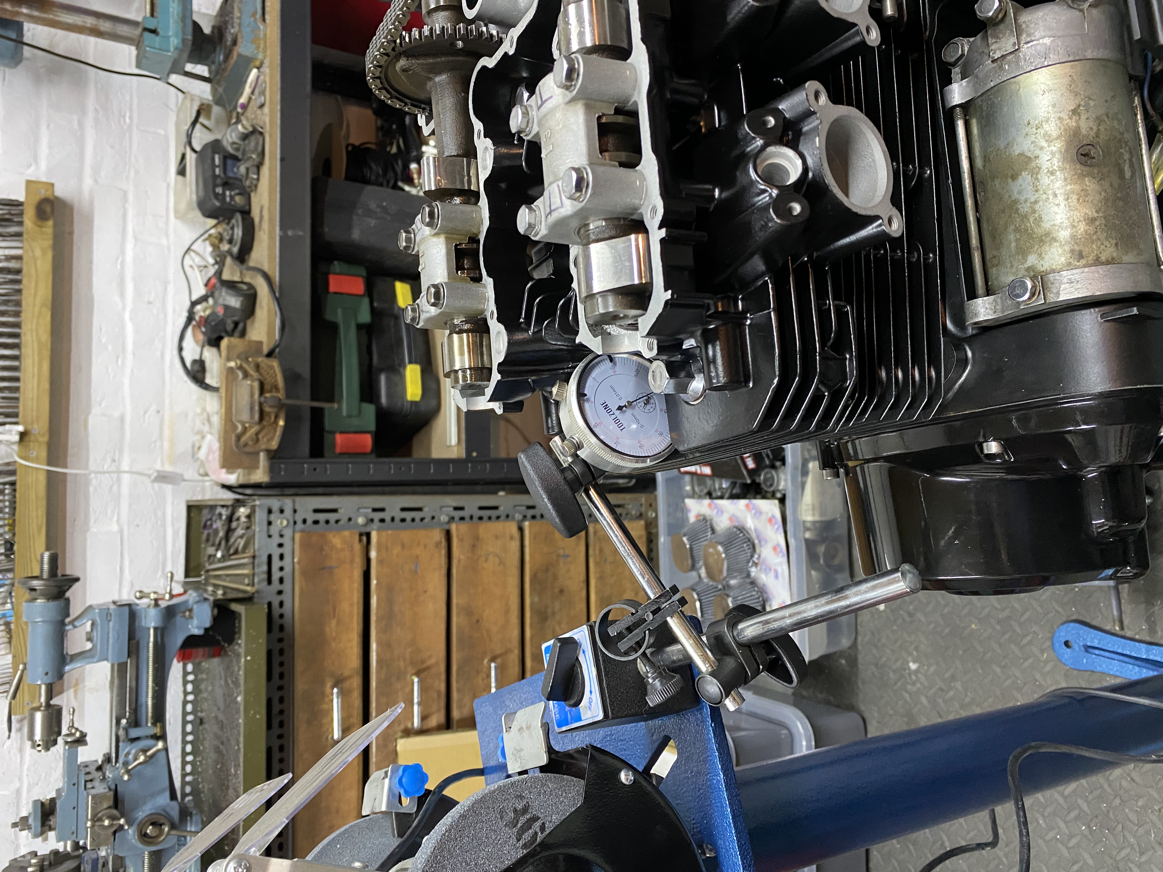

My head has been skimmed by 0.5mm and has slotted cam sprockets, where not in the photo is the DTI in the plug hole to determine true TDC (as you suggested), a second DTI on the cam I was timing at the time, and the degree disc on the crank with a marker.
As you say you can get away without the top guide if using unslotted sprockets and a stock unskimmed head, but with the guide fitted you can at least make sure that the slots in the cams align correctly, and you don't run the risk of the inlet sprocket jumping teeth when you turn the motor over to recheck the timing.

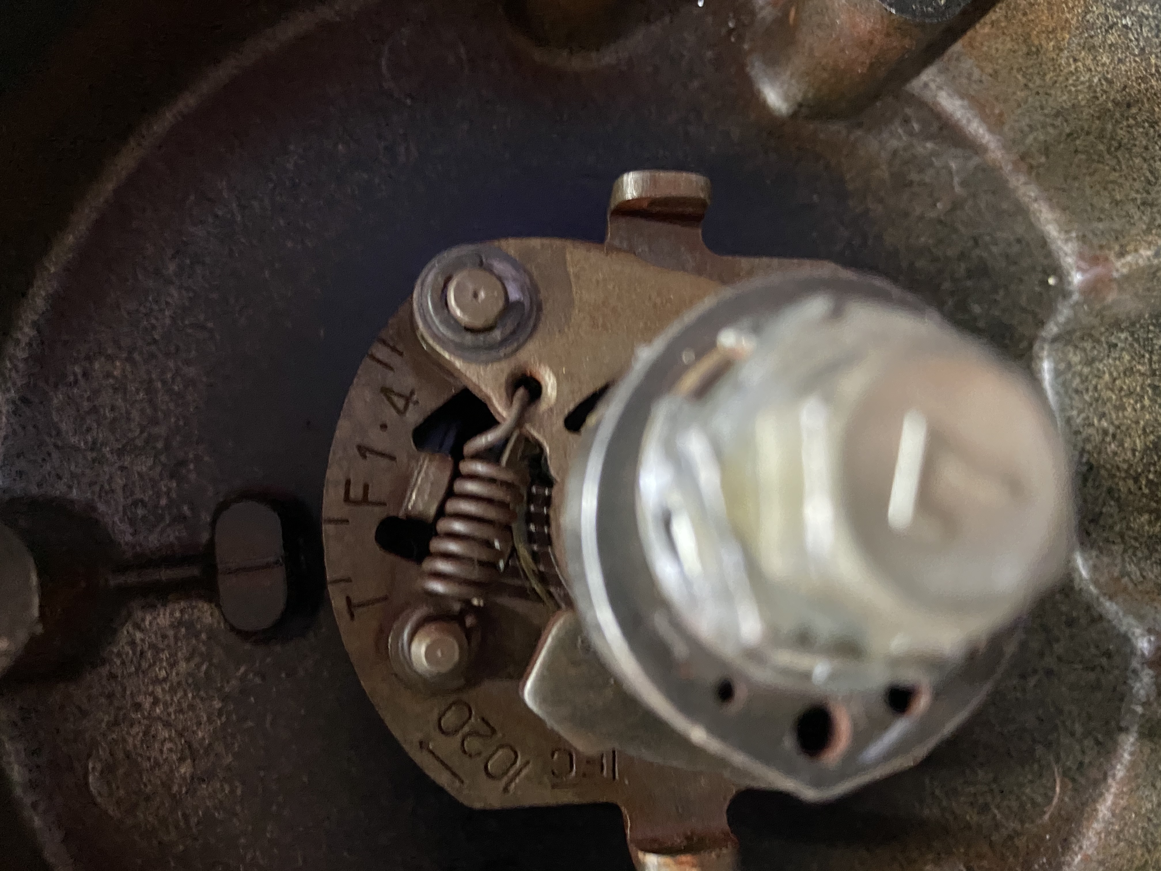

I used a dial gauge in number 1 plug hole to find TDC. Then found there was a bit of play in the timing advancer.
Then I tweaked the position of the timing advancer so when the T mark lined up it was TDC.

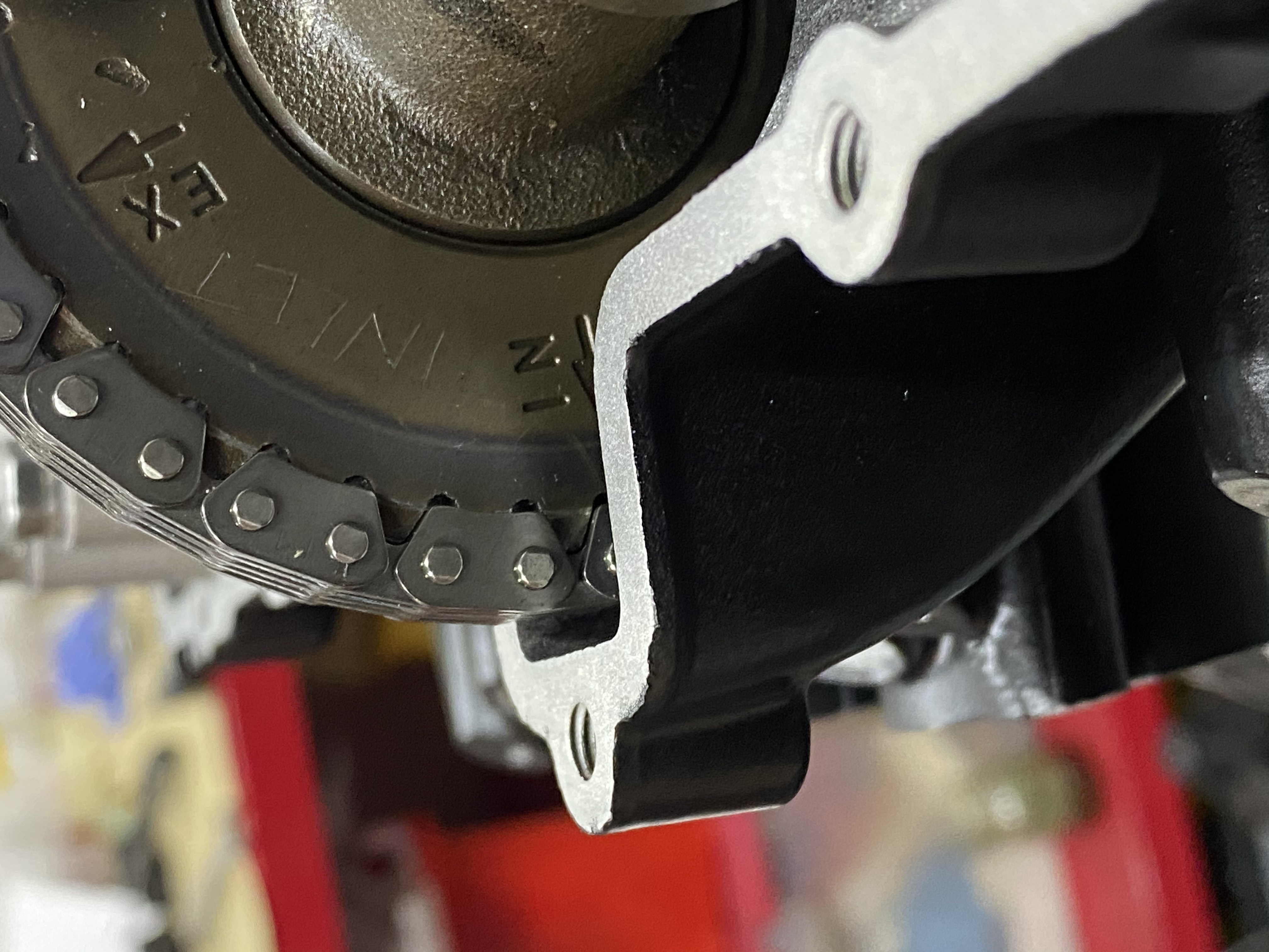

After that I shifted each cam shaft clockwise by 1 pin and it all lines up

This is where the T mark was when actually at TDC before I tweaked it
