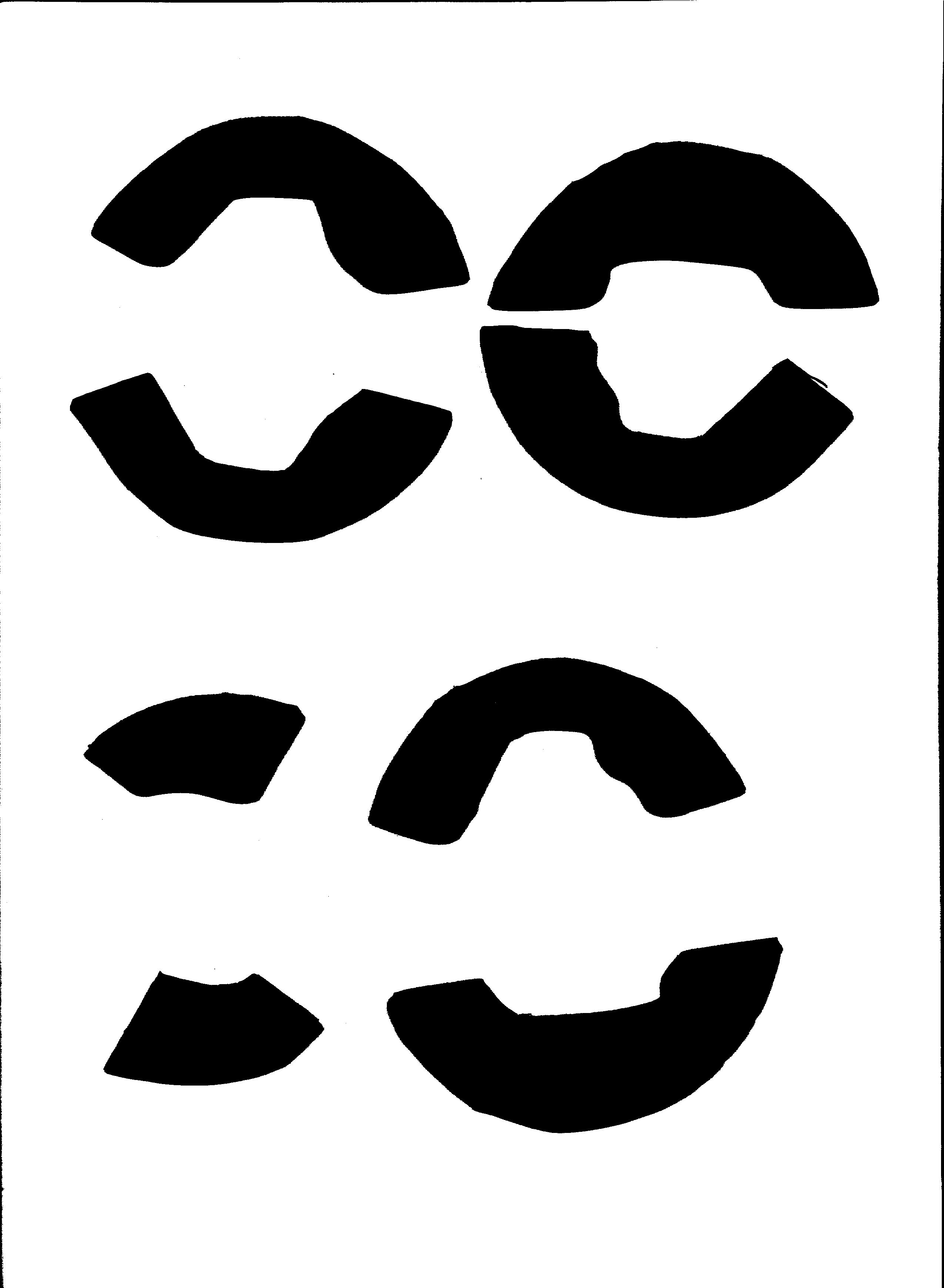

One of the guys on here did some from sticky back foam for me I photo copied them as templates so print this full size a4 and use them as a template.

Many thanks for that, Ive gone and bought some 5mm sticky back foam from Ebay, a 10mm hole punch and a scalpel today- total around £15. You'd think there would be a specific part what with all the Zed specialists out there these days!
