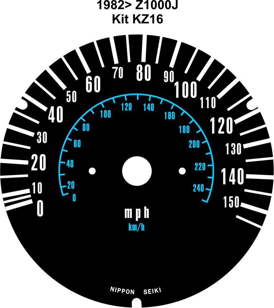

If you're willing to uncrimp the crimp ring then you could always fit one of my gauge faces to it.
The "wine gums" jewels would first have to be removed from the OE face, then one the 0.4mm thick vinyl face has been applied, you then cut out the jewel apertures before adhering them back in.
