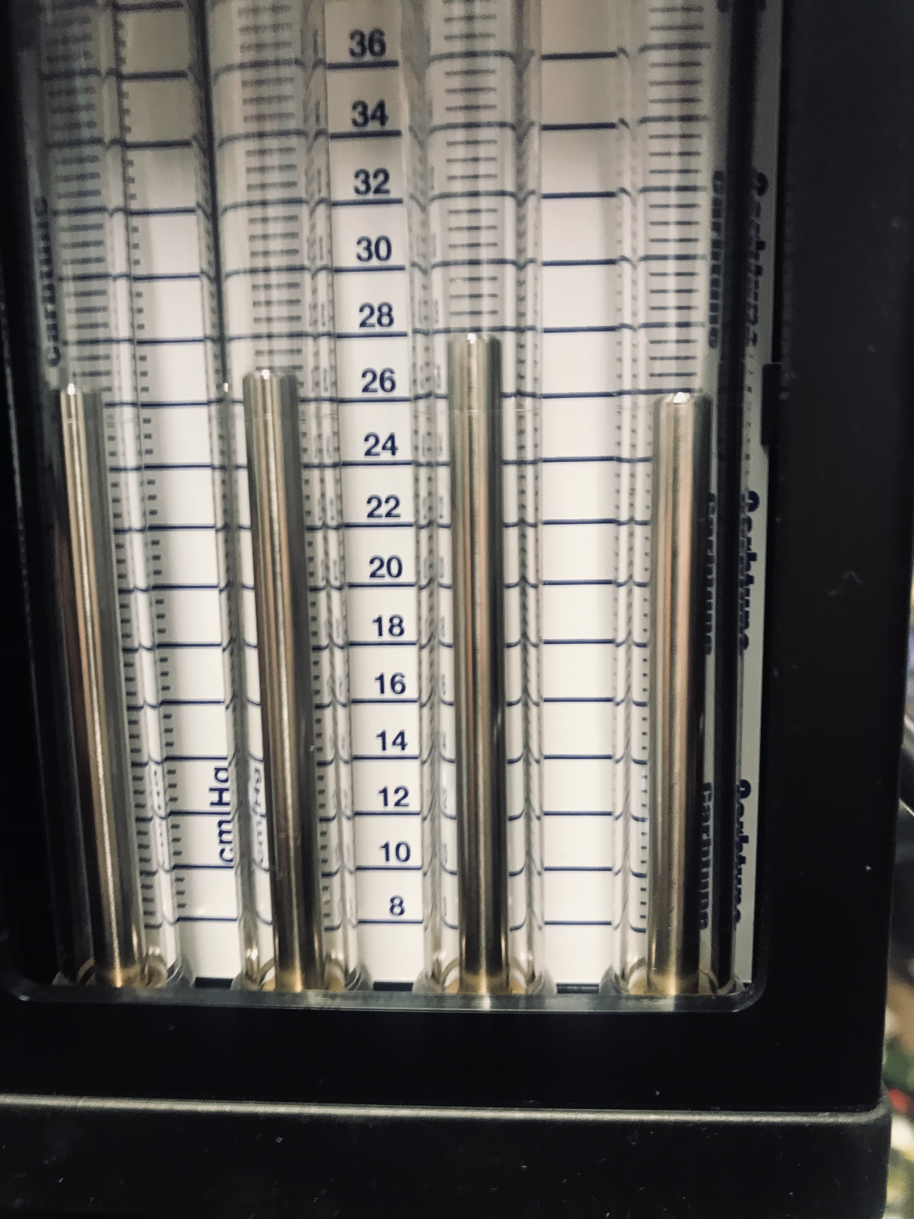

#5 PostAuthor: Jfc » Sun Jan 30, 2022 6:59 pm
Carbs stripped, and all pilot airways blown clean with carb cleaner, 117.5 pilots. Timing done with strobe at idle and 2500+ rpm. Set the carbs up with a 4 way manometer, all within 2cm ish Hg at 1500 rpm
Bike starts and runs much smoother and is now drivable, really smooth to around 2500. Hesitates around 2500 - 3000rpm but throttle is opened wide runs fun.
Could it be wrong pilot size, could it be too much/little air on the top end of the pilot jet range. Any thoughts on what to try would be much appreciated.
