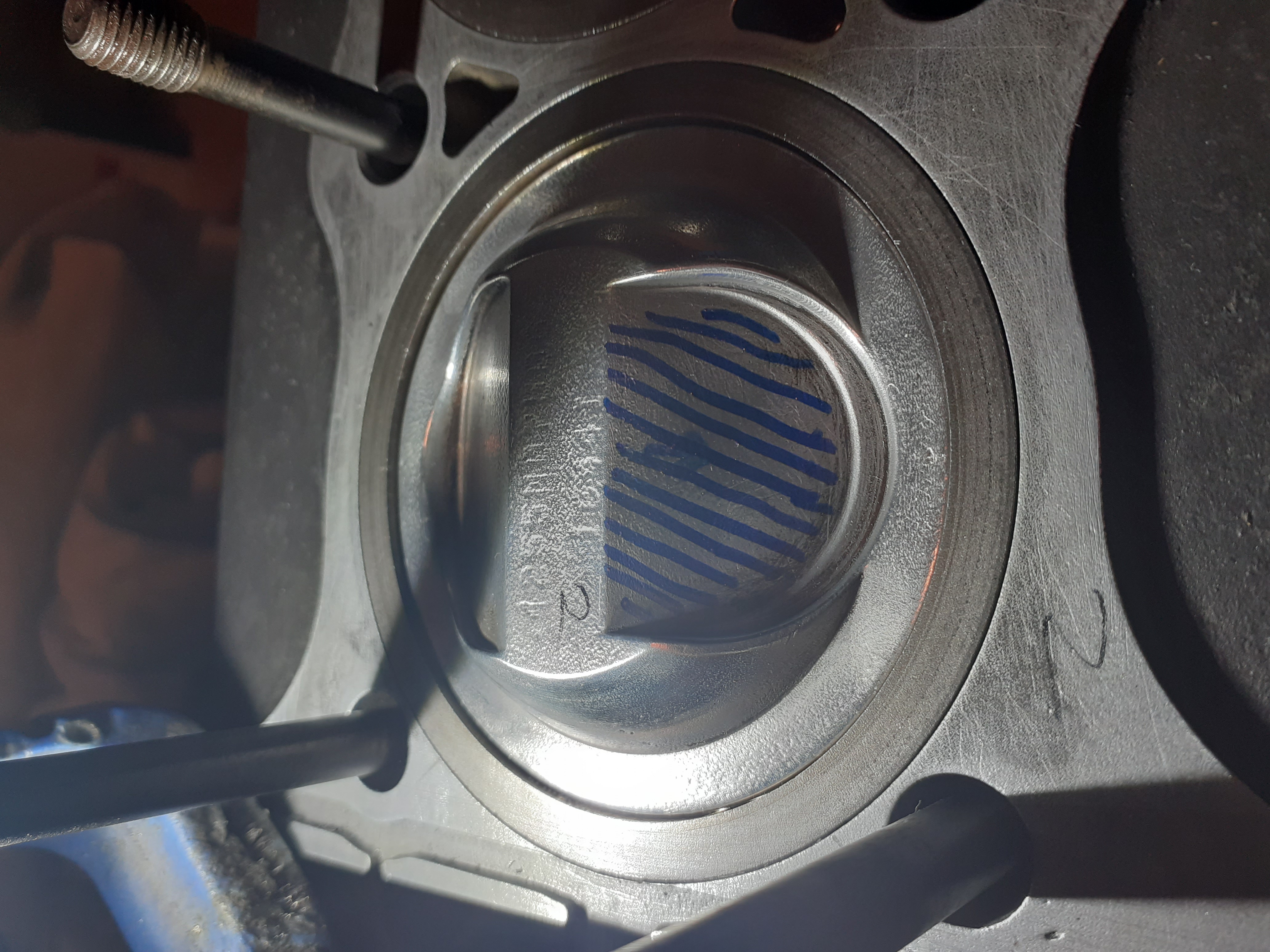

Re: GPZ bathtub head on early engine
The area highlighted in blue is the area of the pocket that needs to be cut for the different angle on the Unitrak exhaust valves.
The slender elipse at the bottom of the pocket was the original cut from Wiseco.
These are 10.5:1 1170 Wiseco 17mm J pistons designed to be used with the J head's combustion chamber diameter. Hence the massive land round the circumference.
Al wrote:The area highlighted in blue is the area of the pocket that needs to be cut for the different angle on the Unitrak exhaust valves.
The slender elipse at the bottom of the pocket was the original cut fromWiseco.
Thanks Very helpful
