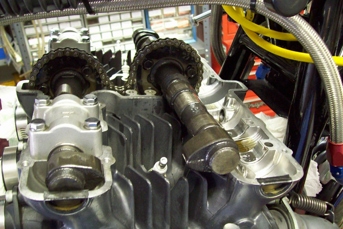

#4 PostAuthor: zed1015 » Sat Feb 25, 2023 3:57 pm
Cam cover and cap bolts are the same.
Kawasaki part number 92003-092 - m6 x45mm.
Depending on year the bolts were either chrome, zinc plated and then black.
Chrome usually on the earlier models.
That goes for cover and cap bolts.
And at 10ftlb max you aren't going to snap them anyway no matter what grade they are.
Chrome cam cap bolts
Re: Cam Cap Bolt Spec ?
#5 PostAuthor: ADRIAN H » Wed Mar 01, 2023 10:05 am
They are prone to stretching. Best to replace with genuine from Zpower or Cradley Heath kawasaki
