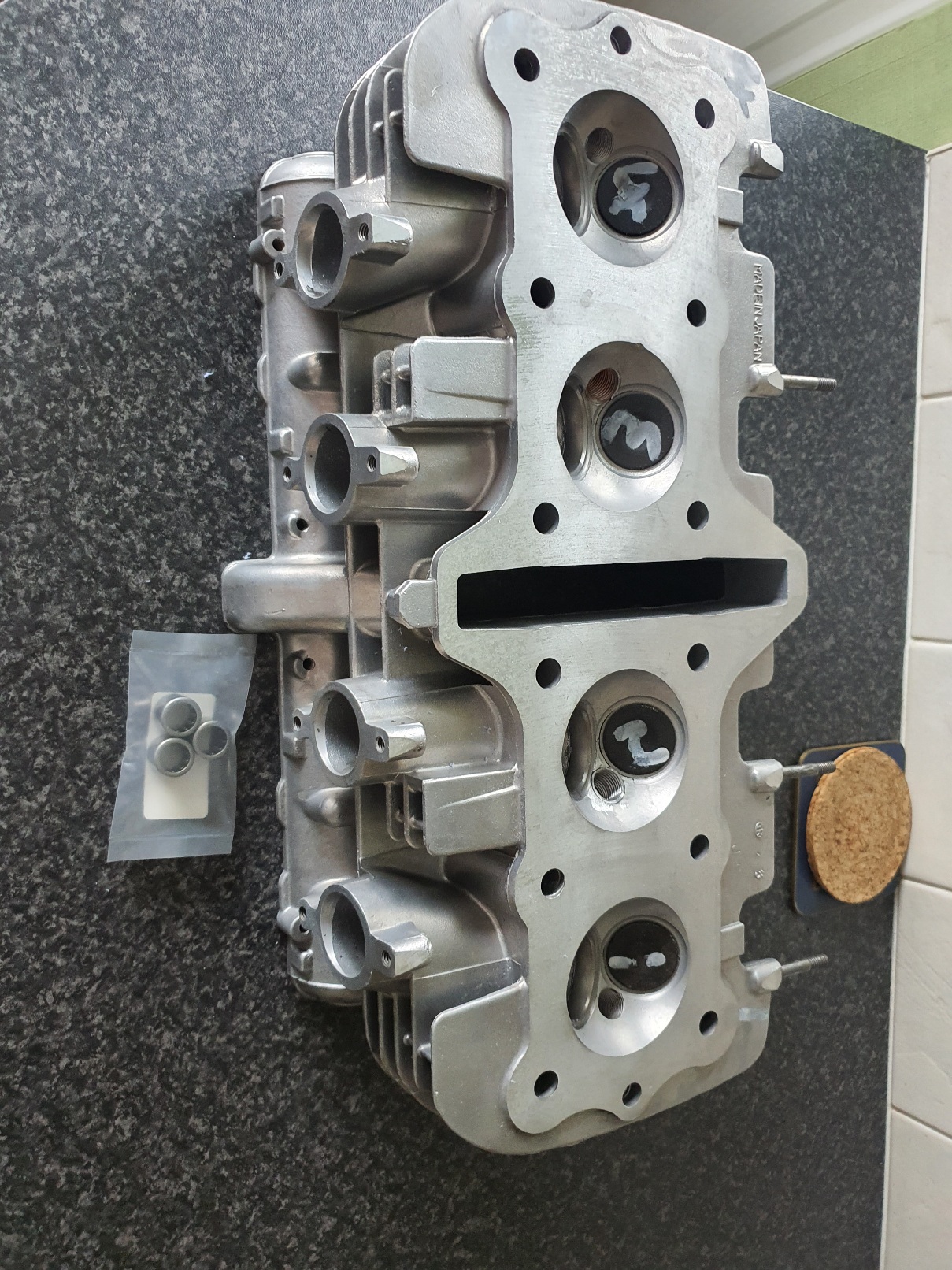

Hi Guys, well just got cylinder head back from engineering company.
Work carried out: fit supplied valve guides (from Zpower) re cut valve seats, lap valves in, skim head, pressure test, remove badly fitting helicoil (standing proud) and fit 2 new timeserts, 1 for the duff helicoil and the other to remove micro fracture on plug thread seen in original photo. Alas 1 exhaust stud snapped when being removed they have drilled it and re tapped to 6mm so i now need a new stud, apoarently they had to remove them to allow skimming. Anyway its back.
Also in foreground on photo the 3 cam roller bearings have arrived, i asked for INA as per Zeds recomendation but got IKO, which according to Google are better but ?
Lots of work now to keep me busy, got everything i need to complete engine rebuild. Just got the dreaded shim clearences to sort out.
On a plus note they have ground ba k the valves heads to be the same tollerance as before the work started, so with luck may not need any new shims, time will tell on that one.
On another note they asked if engine ran, which it did, they said it would have not lasted long as the plug helicoil had been glued in and probably would have leaked, when i look closely whoever did it ran a double washer on plug to take up distance, dreadful, what a bodge!
Any way will keep you all posted on my progress.
