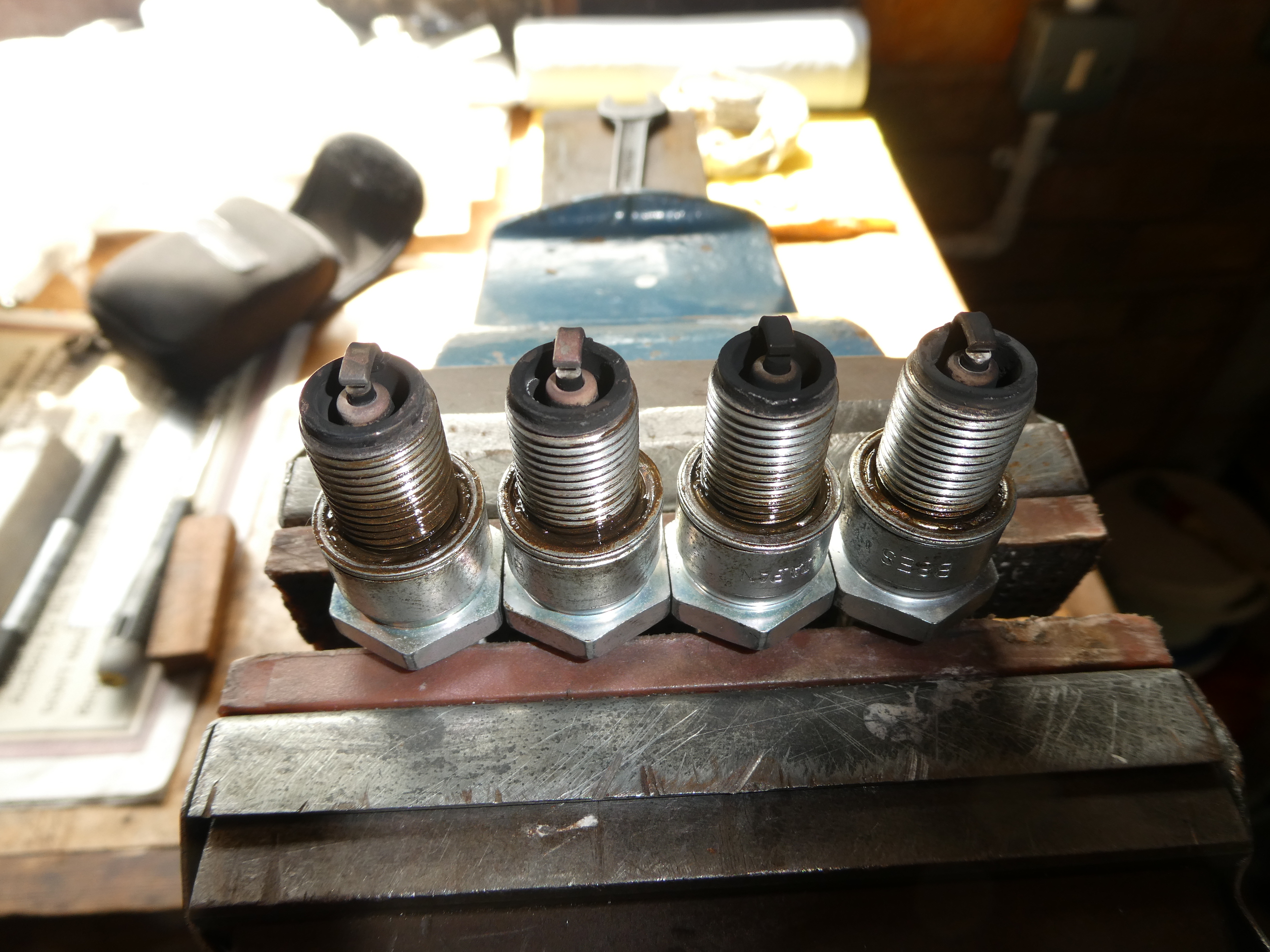

That 3rd plug looks like burnt oil fouling.
- warren3200gt
- Posts: 3110
- Joined: 13th Jun 2014
- Location: Dartford Kent
Re: Z900A4 float levels
Rob, how much does the fuel level really affect plug colour. Couple mm enough to really soot a plug to the point of failing?
warren3200gt wrote:Rob, how much does the fuel level really affect plug colour. Couple mm enough to really soot a plug to the point of failing?
No!
A very rich pilot mix will foul a plug but only if on tickover or stuck in slow moving traffic a while.
Once moving it's enough to burn it off.

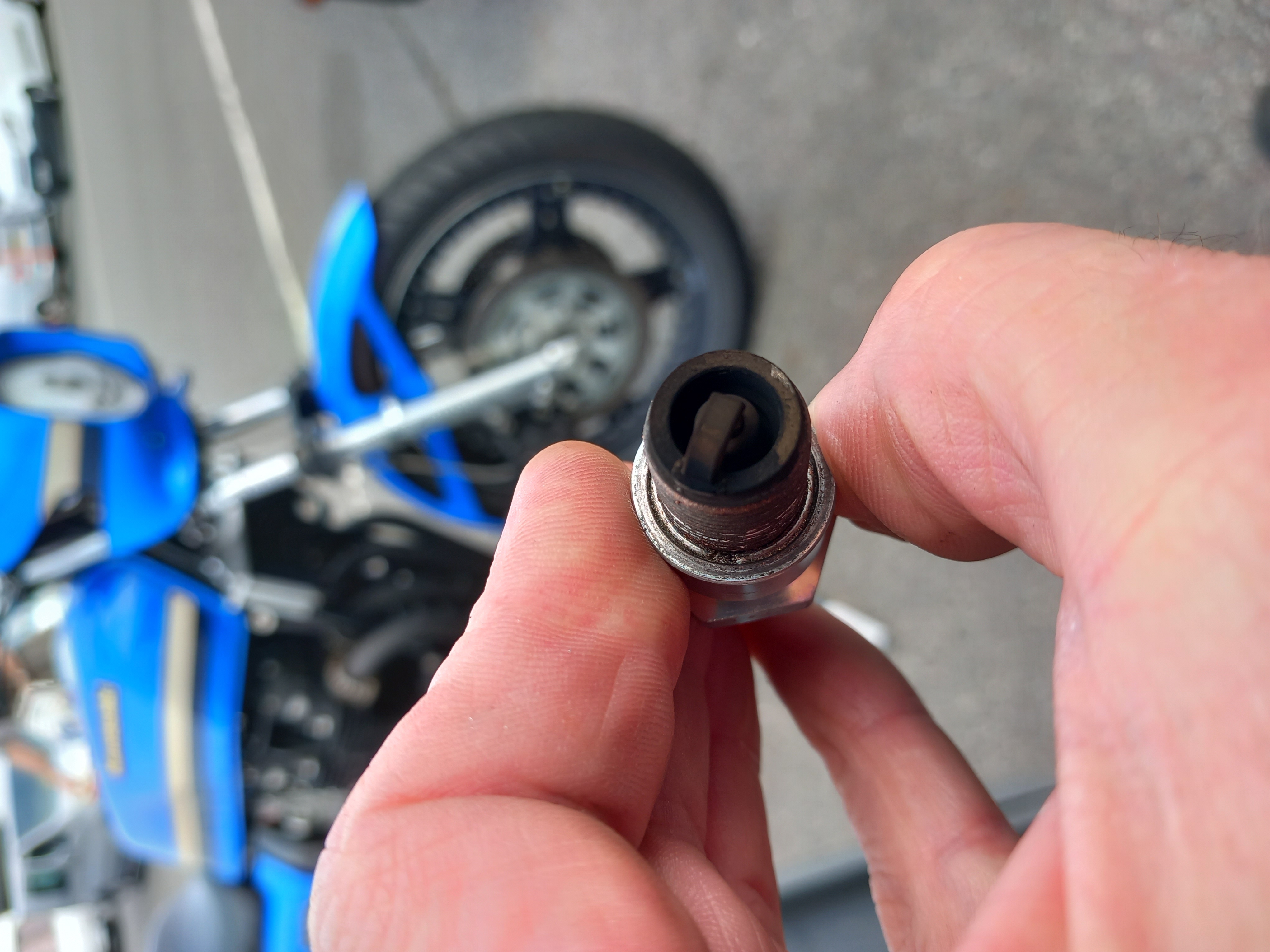

Transferred all the jets, seat, valve, float pivot pin and float from No 4 to No 3 and all of No's 3 to No 4. However, I also fitted a new float to No 4 which went it without any tang adjustment.

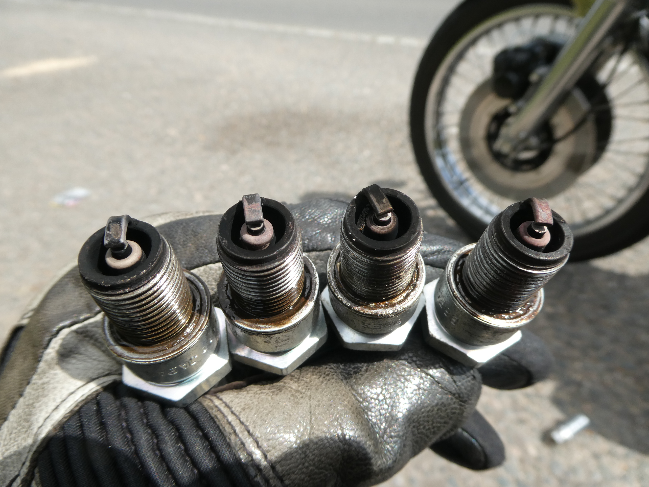

Did another plug chop at 60 mph, see gloved photo. 1st time the insulator of No 3 has had a slightly normal colour.
On return home killed engine and did not let it idle.
Checked float levels on all carbs and they have all remained at correct levels.

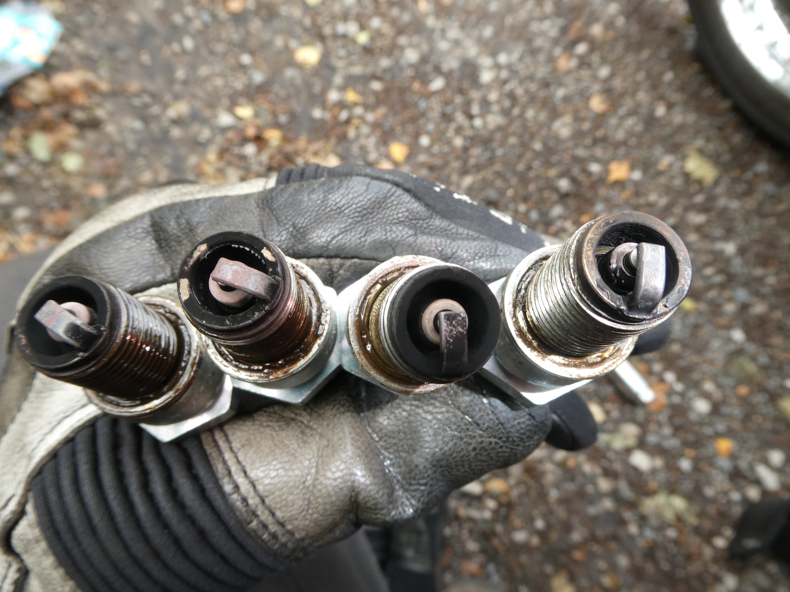

Removed plugs, see attached. No 3 still very sooty but again insulator is not totally sooty as previously.
No 3 air screw currently 2 turns out.
Bike rides down to 25 mph and will pick up from there fairly smoothly.
Will try dropping the No 3 needle by one groove and test with and without air filter when I have to time.
first pic, gloved hand, 60MPH;
#1 A little rich but heat range and temp. perfect. Colour change is on radius of groundstrap which is where it should be.
#2 A little rich and running hot. Colour change nearing the base ring and top threads showing signs of reddening. I still think this is a weak or failing coil issue.
#3 Too rich. Maybe fault with main jet, needle jet, jet needle assembly being; worn, scored, bent, drilled out, stepped etc. Drop needle one groove and see.
#4 No idea. Is it even running? It looks like its not firing and just getting washed by fuel!! That said, it was showing signs of oiling in previous photos and again to an extent in this one. It looks 'wet' inside!
Second pic, home again, no idle;
#1 Still looks a little rich
#2 Still looks a little rich and a little hot but not so obvious from this side.
#3 Still too rich and one needle groove, clip movement may fix that.
#4 Looking a little blotchy but better than at 60 MPH. Still could be taken to be oily but so hard to see from just a picture.
Speaking for myself i would address the 'number three' running rich situation first to get them all the same. If you run it without the air filter keep an eye and ear on number 2 so as to not let it get too hot and cause any problems for you there.

Plugs of No 3 and No 4 were swapped as I do not have the ability to thoroughly clean plugs, nor a new supply to keep changing every time I do a test.
So I cleaned No 3 as best I could and put it into No 4 and moved No 4 to No 3, which is why it probably looks so bad, all pots were firing OK.

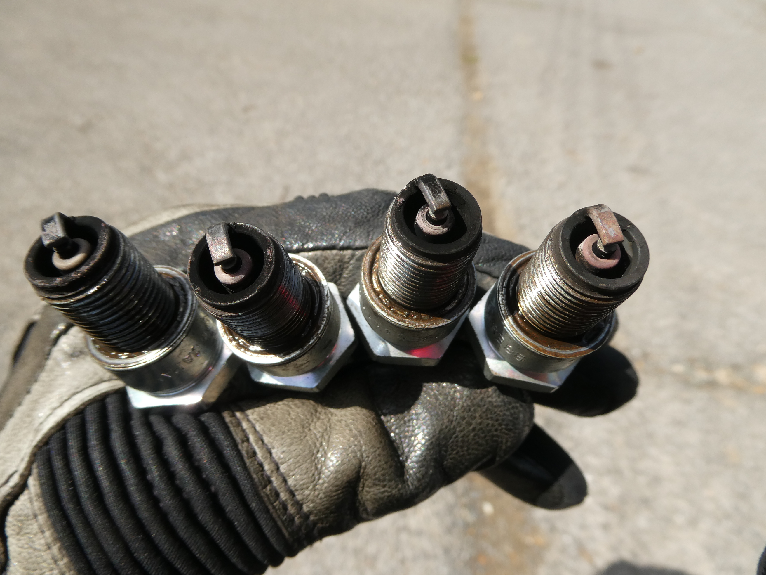

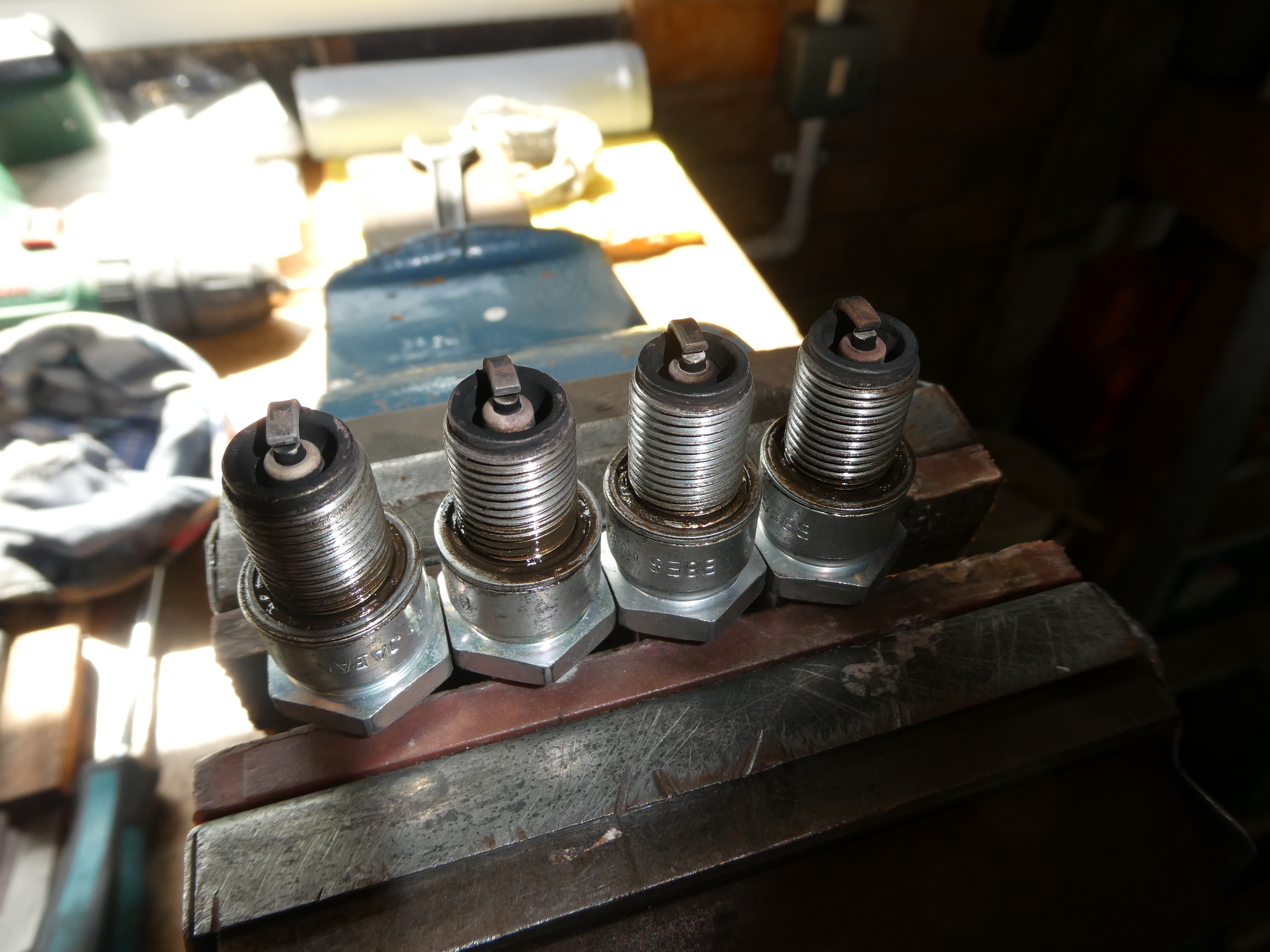

Took the bike out again today on which the No 3 carb has had the needle dropped by one groove.
Air screw on No 3 set two turns out to weaken the mixture even though it colourtuned around 1 1/2 turns out.
Plugs are No 1 to right to No 4 on left.
1st photo done with 60mph chop and is with air filter fitted.
2nd photo done with 60mph chop and air filter removed.
3rd photo is done on returning home with air filter fitted and no tickover.
I am not looking for ultimate performance and perfect running, I have modern bikes for that, I just want to use it for pottering around the back lanes between 50 and 60 mph.
If No 3 needs the needle dropped by one groove it does not bother me as long as it runs OK and is not going to cause the backfiring and missing it previously had.
