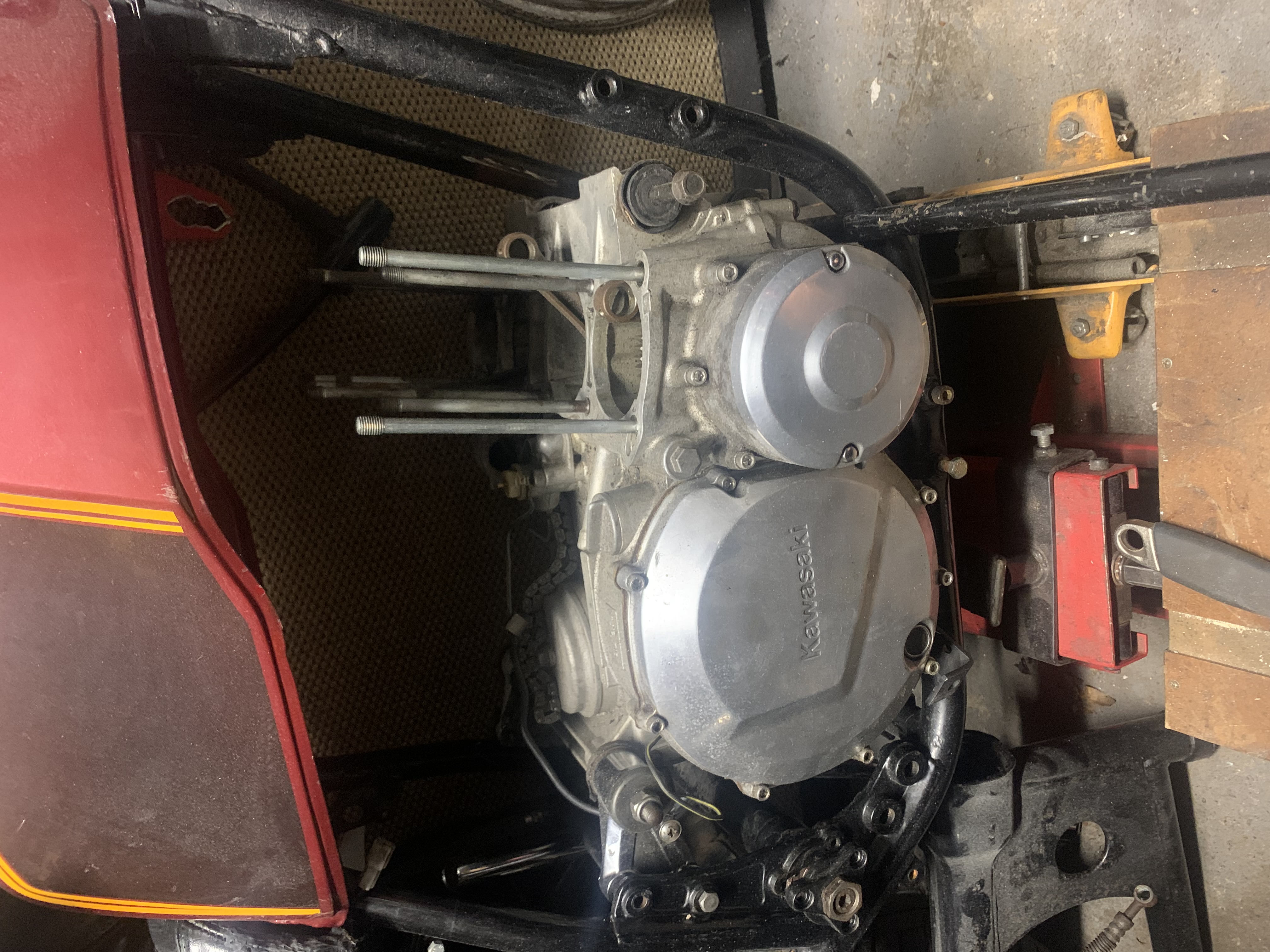

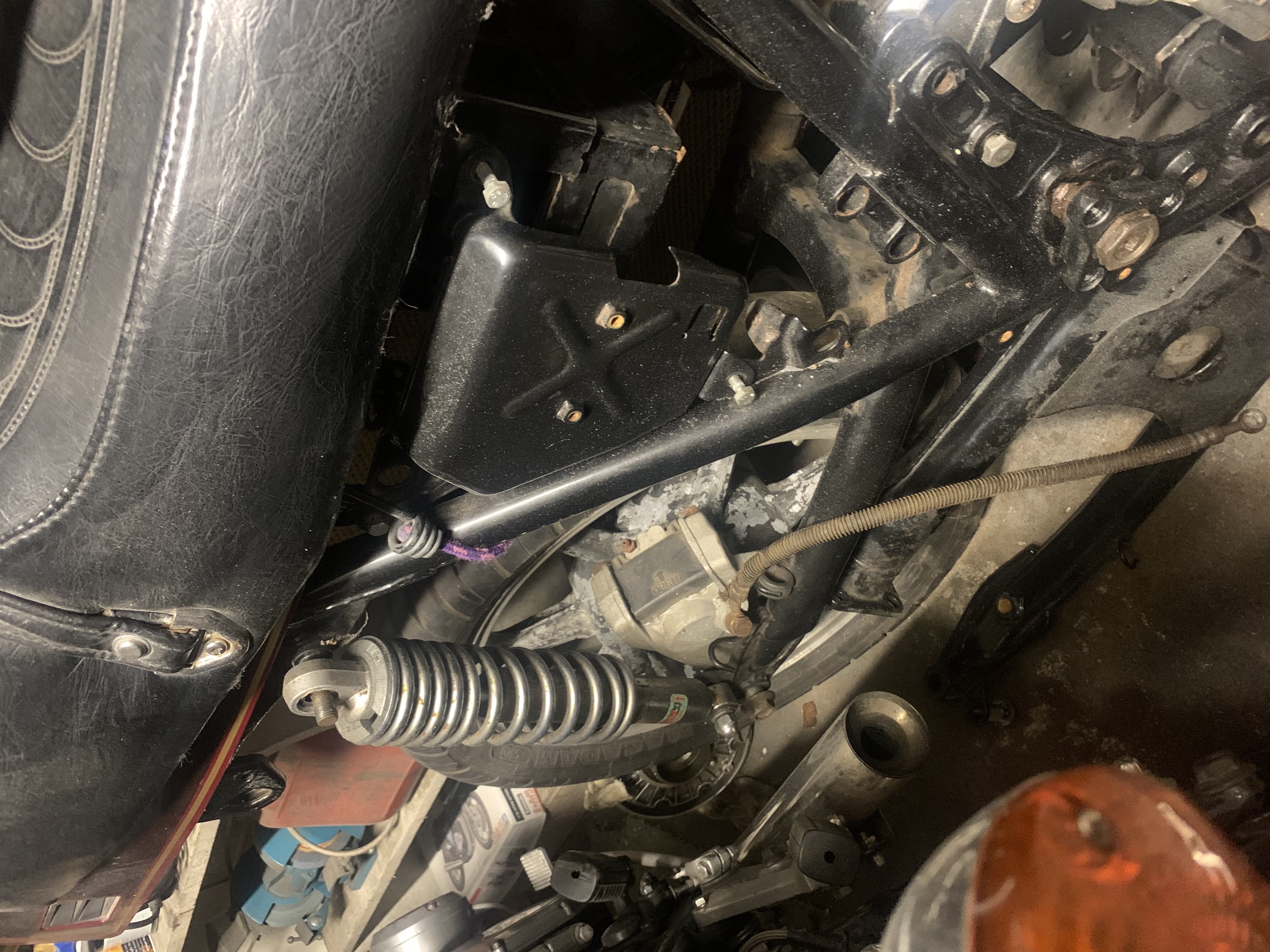

Just measured the little ends and they are 17mm which makes life easier (I hope)
Pictures attached of the mock up so far.
The rear 1100 engine mounts line up perfectly, just need to drill out the frame bolt holes to take the slightly larger 1100 bolts.
Shaft/swingarm is fitted to the back of the engine so no issues there.
