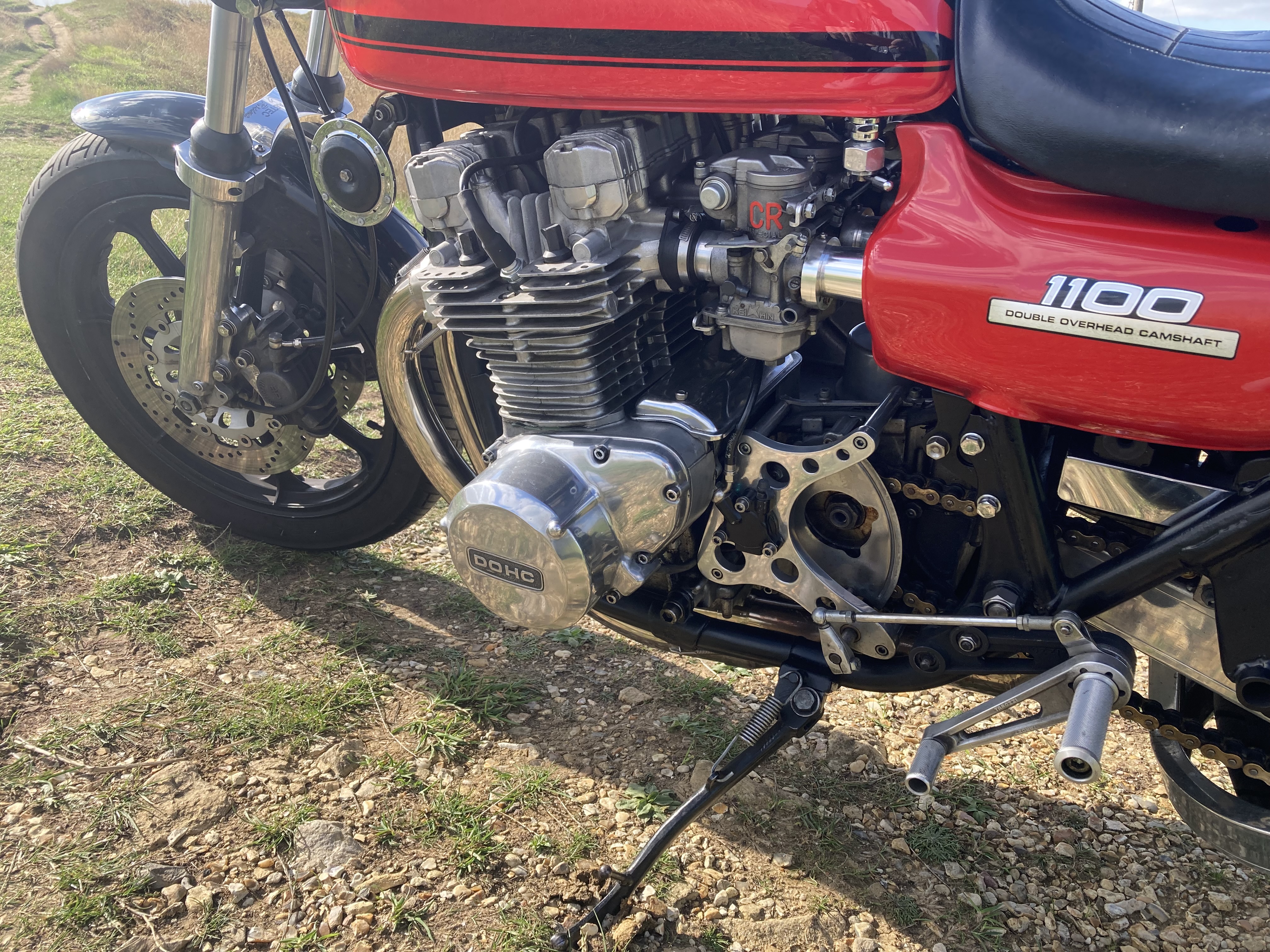

Like Zed said there i used an out riggger plate and a gsf1200 slave as i had one on my Bandit 12 i bought a Nissin master from Webike. Getting the distance in spacing and the length of the push rod right was a chore but works a charm now.

Z1streetfighter71 wrote:Like Zed said there i used an out riggger plate and a gsf1200 slave as i had one on my Bandit 12 i bought a Nissin master from Webike. Getting the distance in spacing and the length of the push rod right was a chore but works a charm now.IMG_2718.jpg
I have a very similar Plate made by Spectra Engineering but using an Oberon Slave Cylinder
