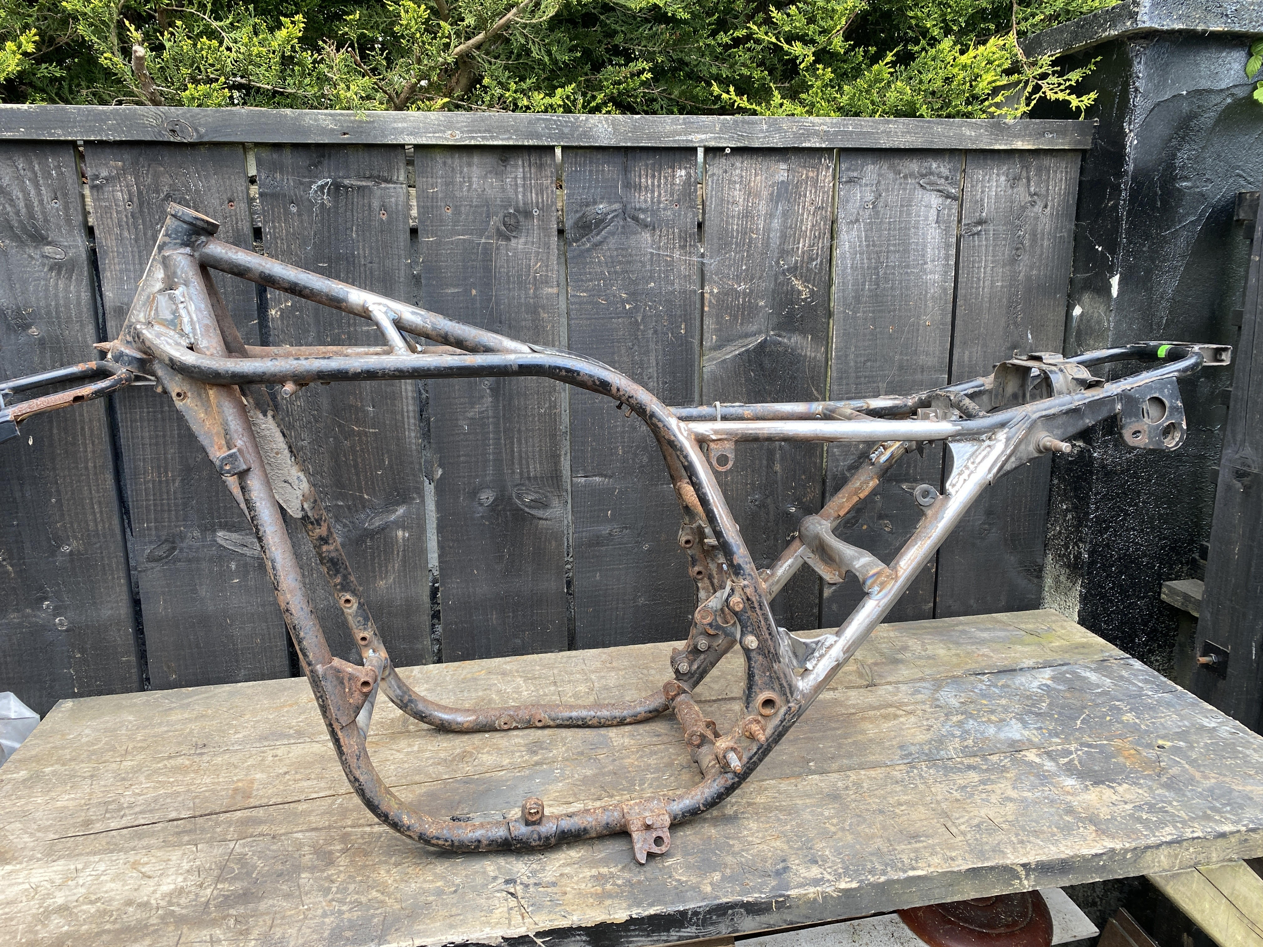

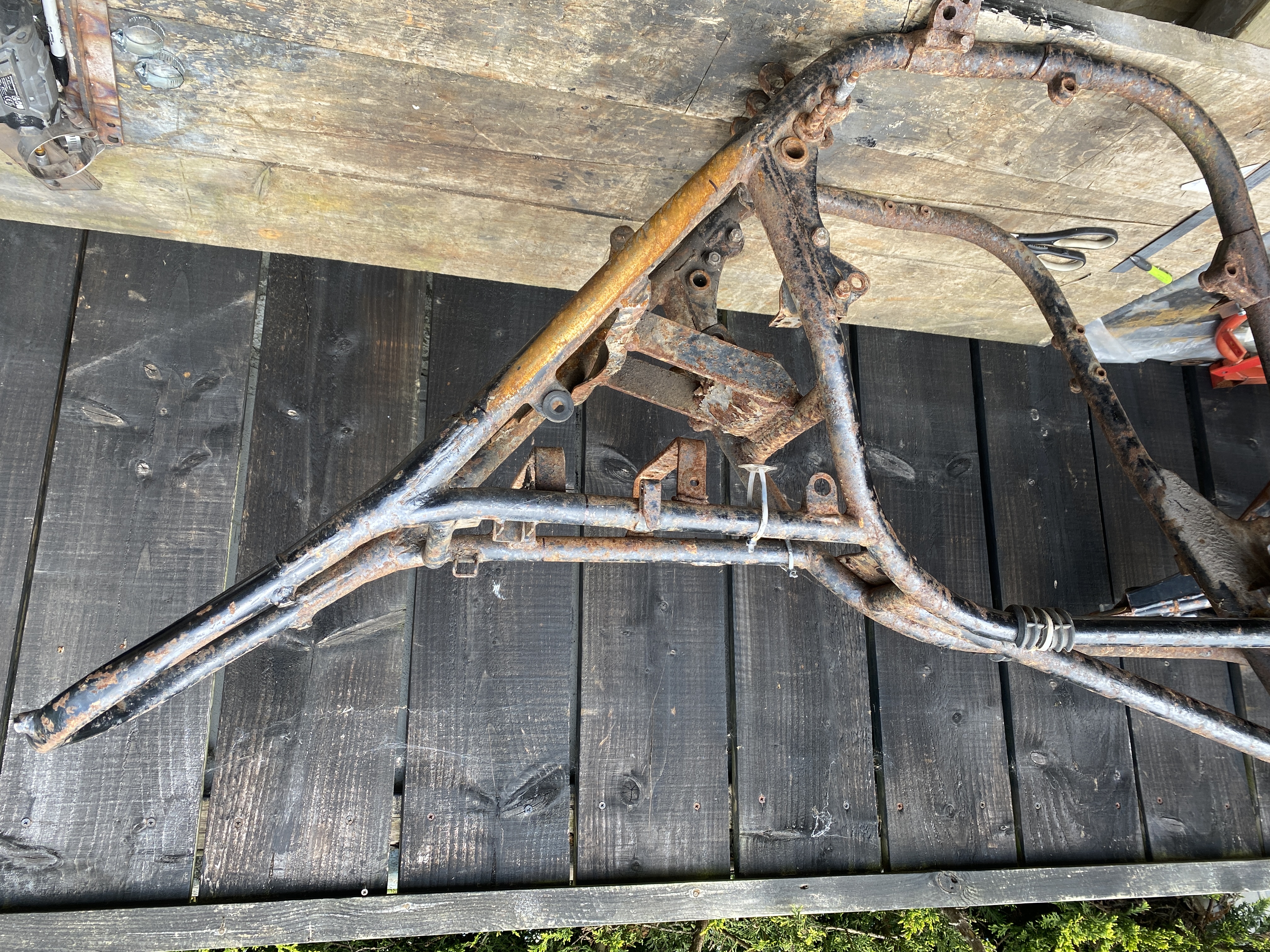

What kind of damage are you talking about? twisted... bits missing? I repair frames all the time. from this.
To this.
Can you post pics and an explanation of whats up with the frame? It might cost way less to fix than replace and keep the value of the bike too keeping the frame ans engine in range. Plus im sure its less of "rules" and more of "the law" when it comes to swapping numbers on frames...

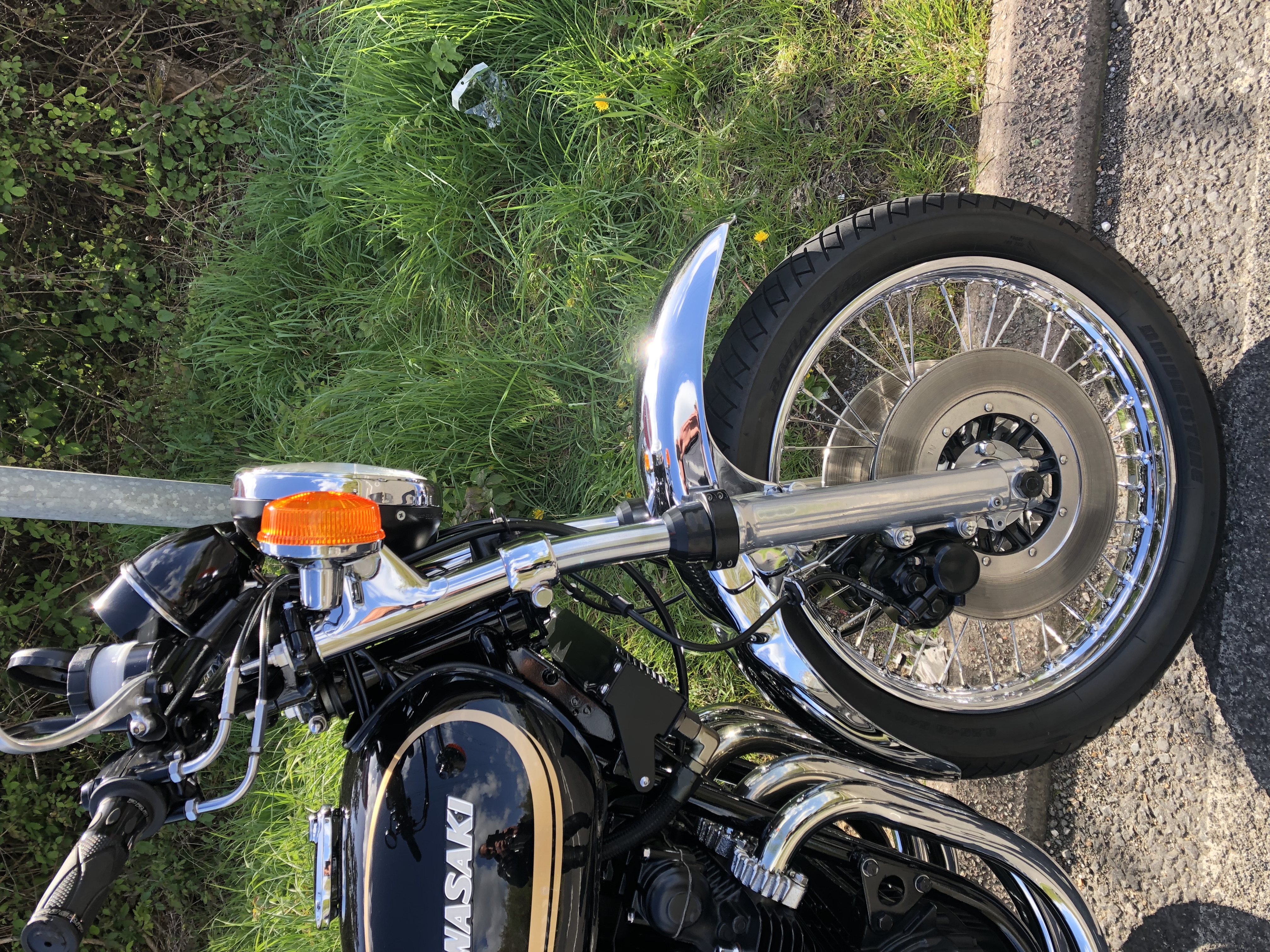

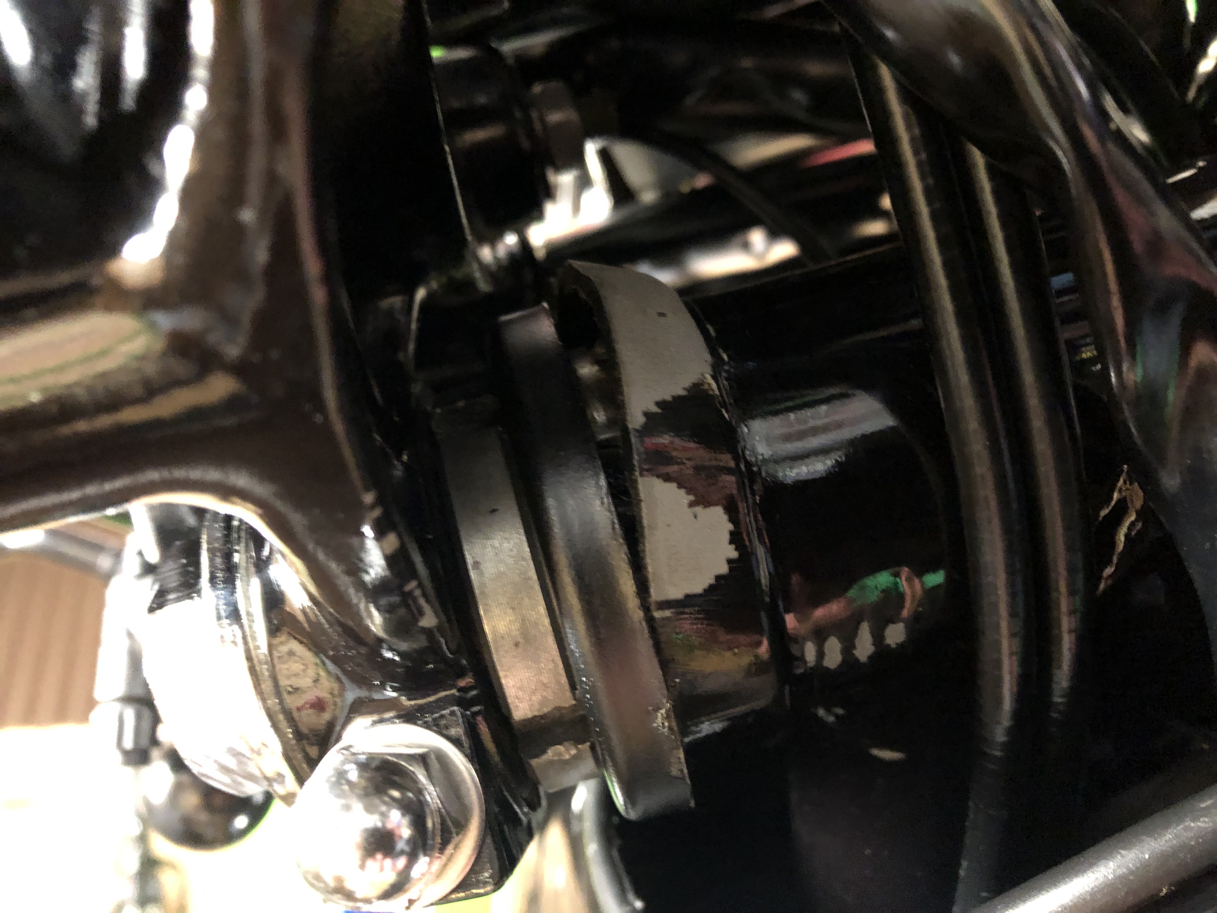

#7 PostAuthor: scott » Thu Apr 25, 2024 7:41 am
Thanks for the replies, gratefully appreciated. It’s going to Motoliner for repair. Head on collision into back of a car. Forks are bent. The headstock is damaged. The top bearing cup has deformed….it’s now pushed forward. Motoliner think its an easy repair.
Posts: 1030
Re: Replacing frames
#8 PostAuthor: Z1streetfighter71 » Thu Apr 25, 2024 8:29 am
scott wrote:Thanks for the replies, gratefully appreciated. It’s going to Motoliner for repair. Head on collision into back of a car. Forks are bent. The headstock is damaged. The top bearing cup has deformed….it’s now pushed forward. Motoliner think its an easy repair.
Yikes, hope you wer'nt the one that was on it and if so you are good and healthy. Yep thats a damaged frame that is best left to the professionals. Hopefully it will work out cheaper than a A2 frame theses days.

#9 PostAuthor: scott » Thu Apr 25, 2024 9:36 am
Yes, unfortunately it was my crash…..usual story, car stopping at roundabout, then let’s off the brakes…..then stops again. My fault for anticipating that he’d moved on. Hit the back of car, then thought I was doing some tests for Boeing, rolled over the roof etc. no broken bones just a damaged bike. Remarkably very limited damage, looks like frame, forks and yolks(I’ve got forks and yolks now), front mudguard (they’ve increased in price!!), brake lever, one mirror, slight scratches on points cover, slight scratch on brand new exhaust. All other parts are fine, no bent bars or headlight or indicators etc, tank is fine etc…….in all very lucky. Still alive and kicking. If the frame is written off then it’s yours Rob.

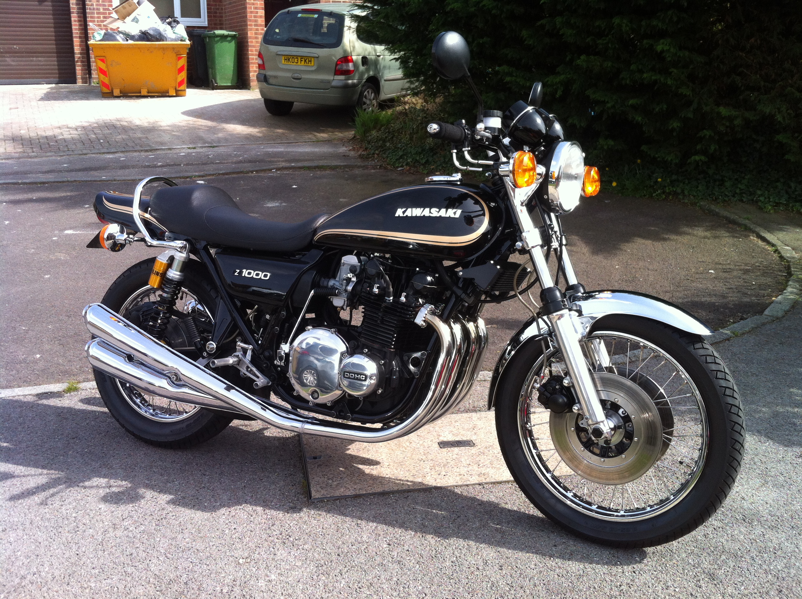

#11 PostAuthor: Z1streetfighter71 » Sat Apr 27, 2024 12:02 pm
That is a sweet looking if not slight bent A2, one of my top 3 paint schemes, black and gold. It looks loke a pristine bike before and will be again no doubt.

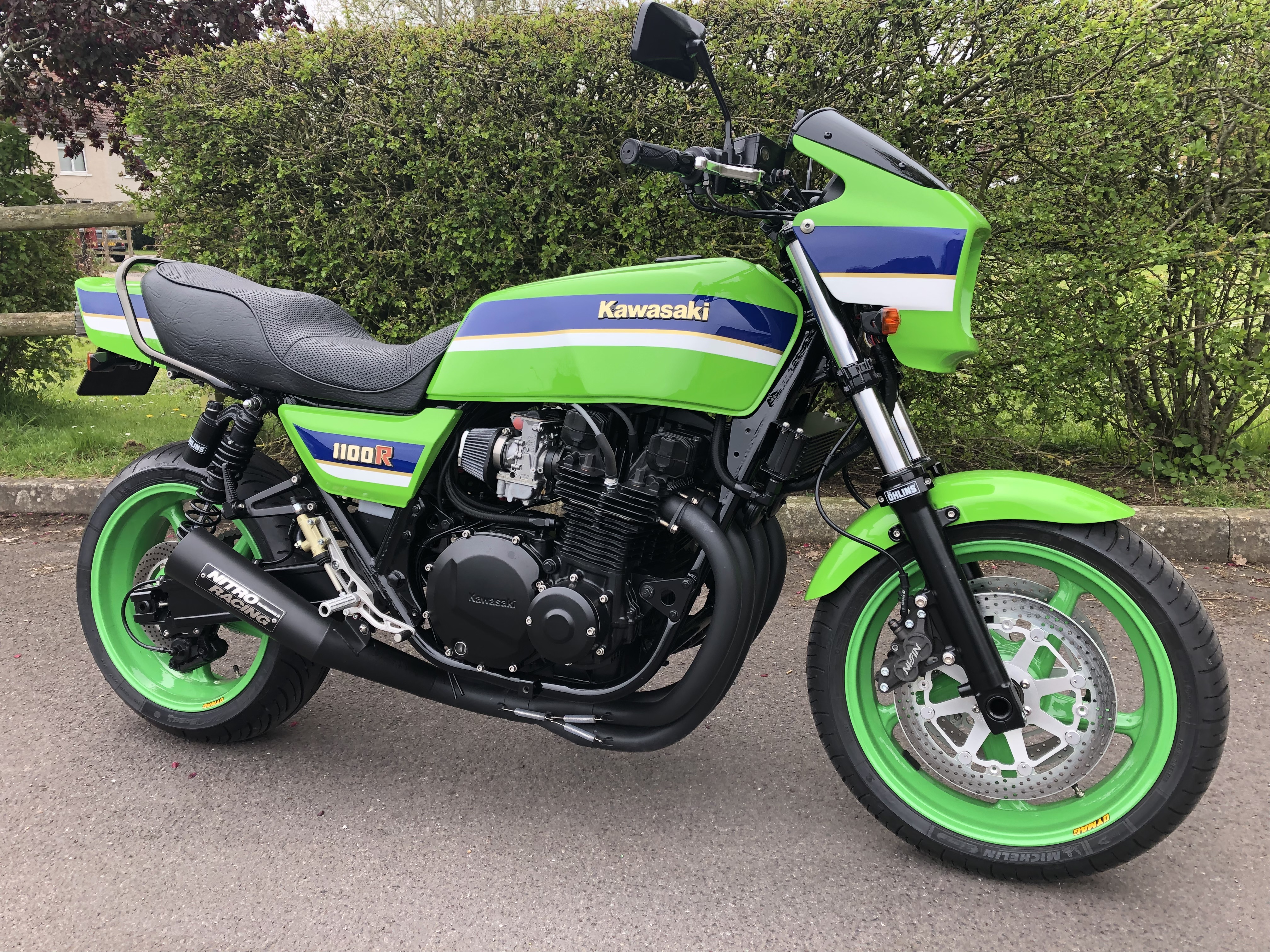

#12 PostAuthor: scott » Sat Apr 27, 2024 12:19 pm
Hopefully it will be like this again, Its been in this rebuilt condition since 2007.....until last week :roll:

#14 PostAuthor: scott » Sat Apr 27, 2024 3:02 pm
It will be good again, just going to take a bit of time unfortunately. I've not long finished this 1100, so at least I've got a bike to ride.
