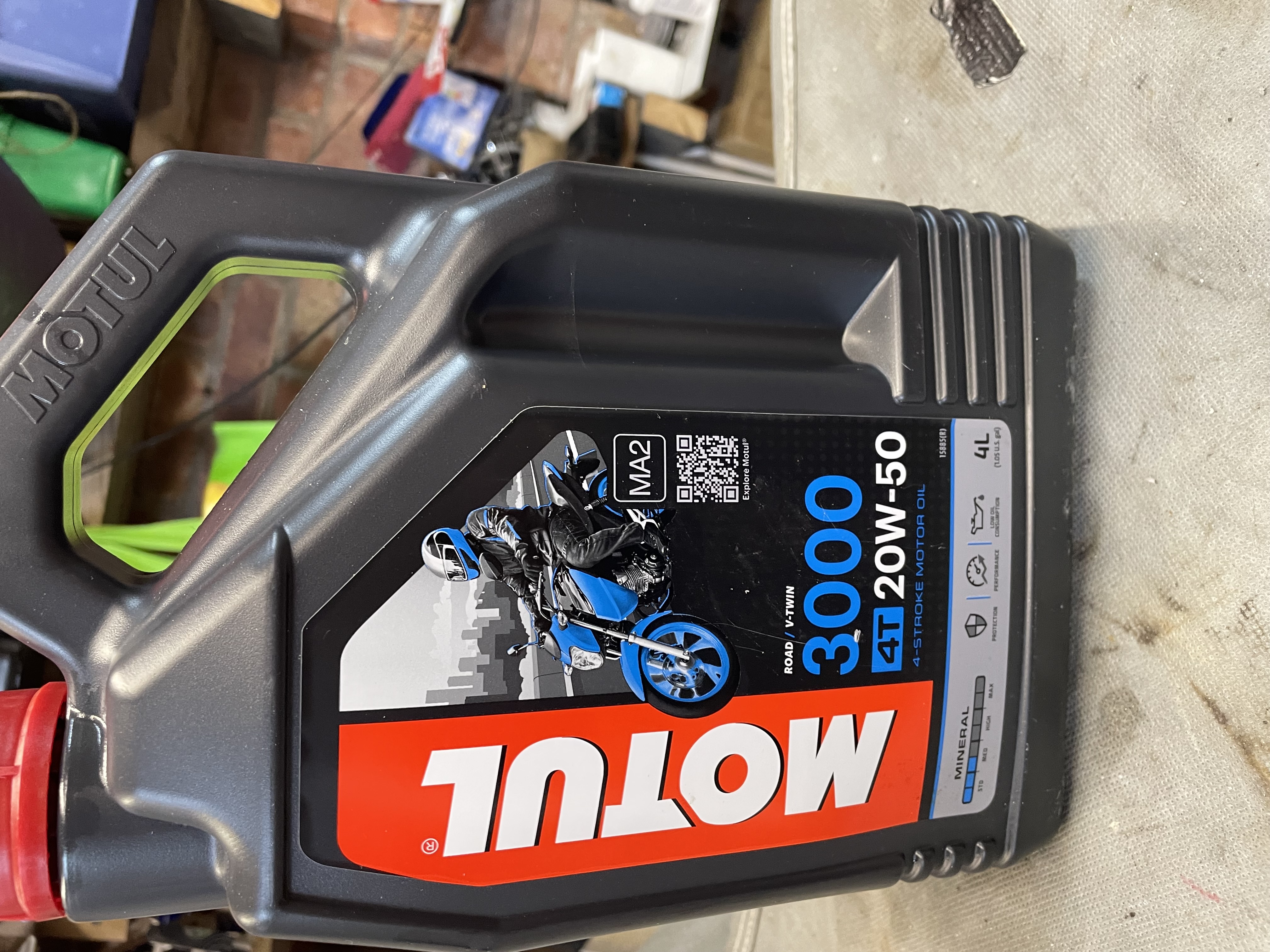

#5 PostAuthor: gray » Tue Aug 06, 2024 8:58 pm
are you running car 10-40 oil instead of motorcycle 10-40? Car stuff has more friction reducers, and will contaminate the friction plates so the clutch plates will slip more and maybe screech.
Or maybe 1 plain plate has overheated and warped

#6 PostAuthor: shaggy » Wed Aug 07, 2024 3:35 pm
This is the oil I’m using
