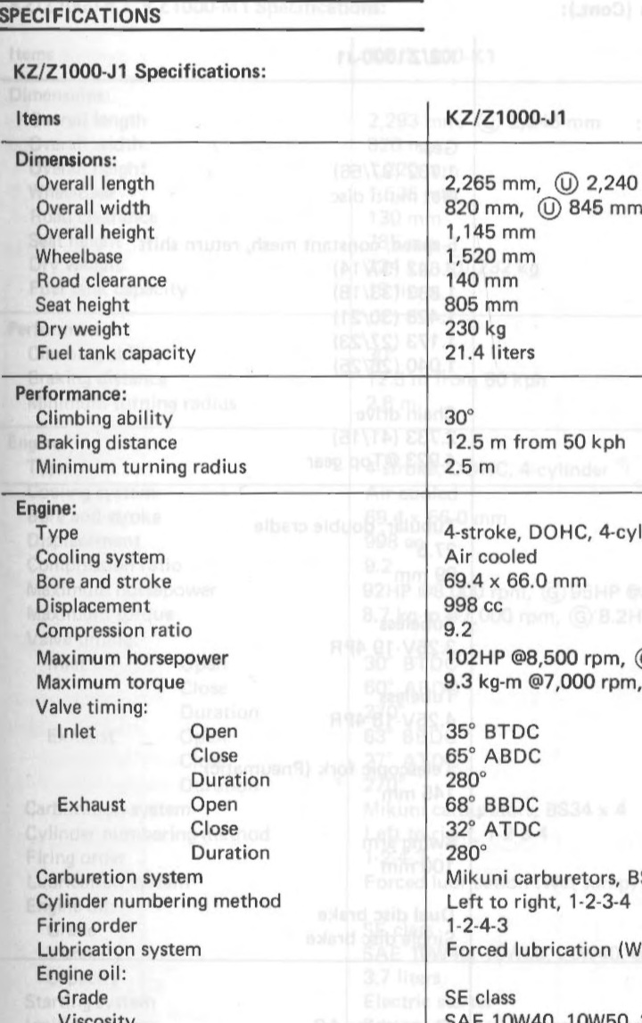

#3 PostAuthor: warren3200gt » Thu Sep 26, 2024 12:00 pm
J1 but near enough I'd guess.

#4 PostAuthor: biker_smith » Thu Sep 26, 2024 1:39 pm
Thanks guys - very useful. Regards - Paul.
