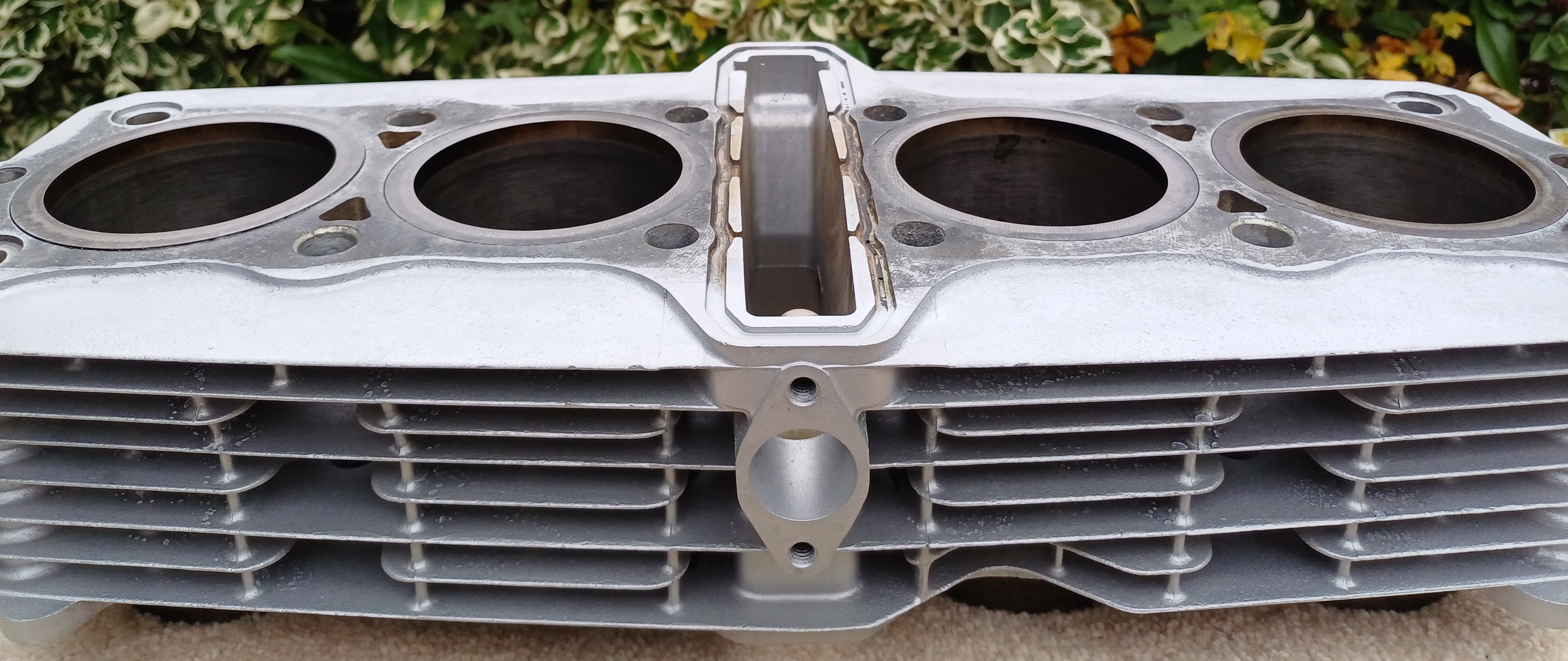

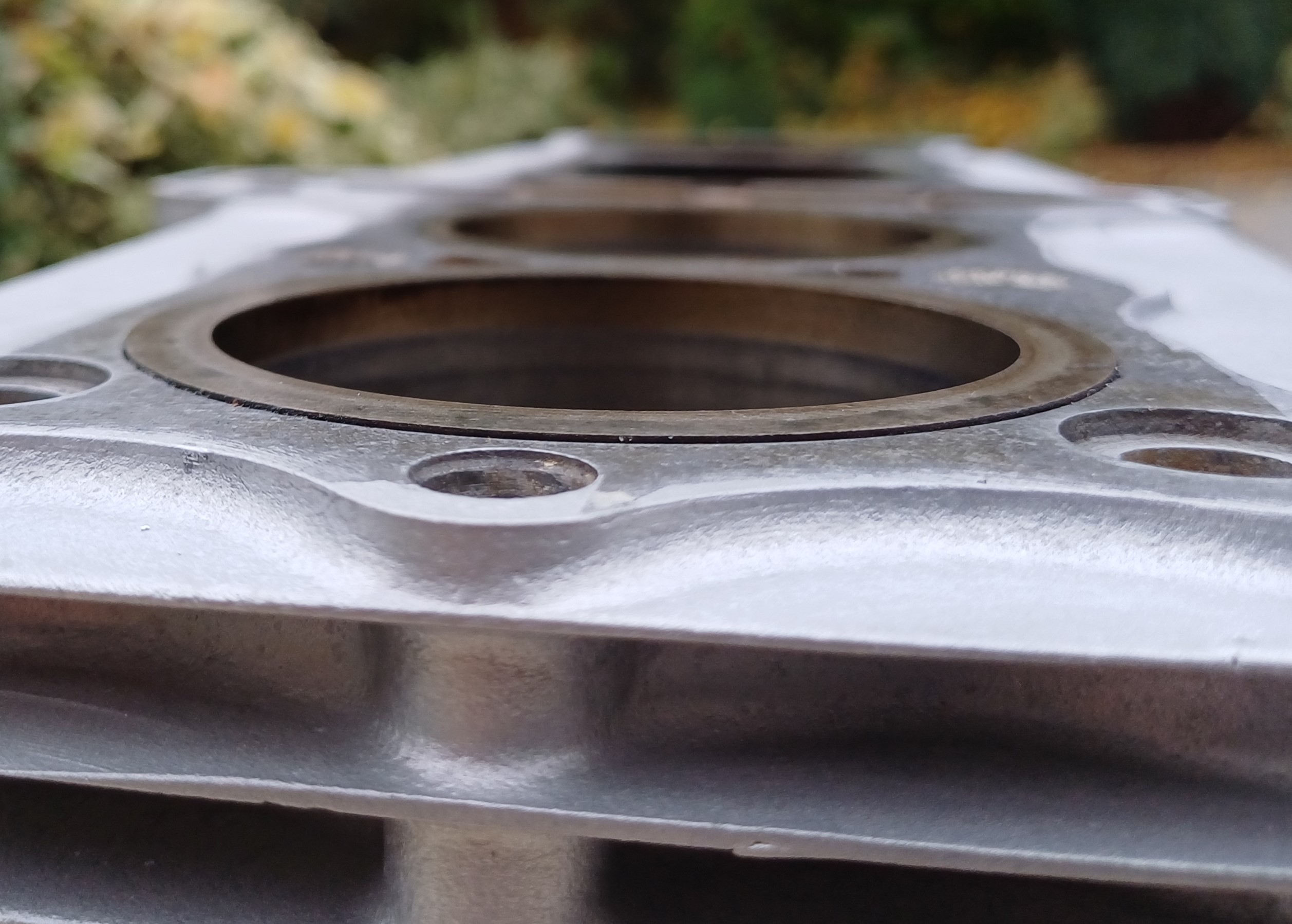

I'm looking for some help on the best course of action to take with regards to the liner on #1 cylinder. I only just noted that it stands slightly proud of the block and the other 3 liners. Looking at earlier photos it would appear that this was also the situation when I disassembled the block 12 months ago. #1 liner does not seem to be loose. Looking for suggestions on how to proceed.

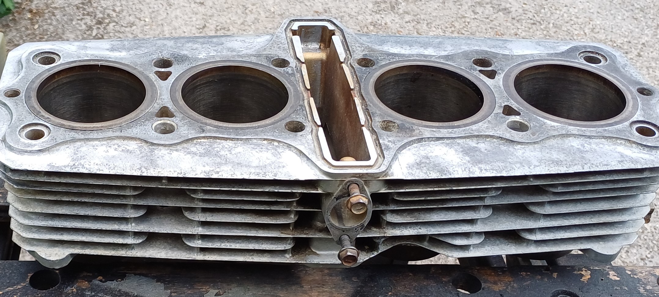

Situation at disassembly 12 months ago.
As is now. (ie no change)

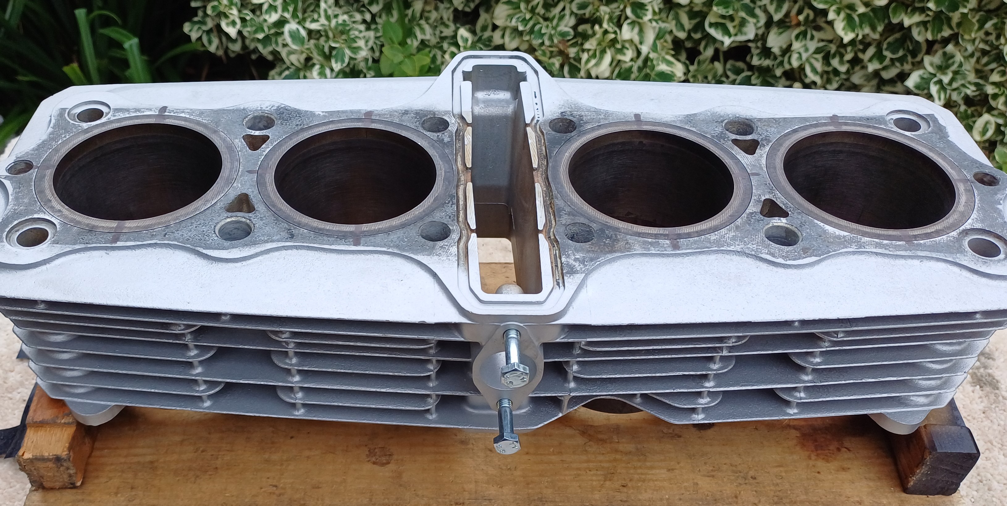

Thanks for all the suggestions. I popped it in the oven and heated to 200 DegC using support blocks, the liner still needed a gentle tap with a soft mallet as suggested by Nigel. I think it should now be fine.

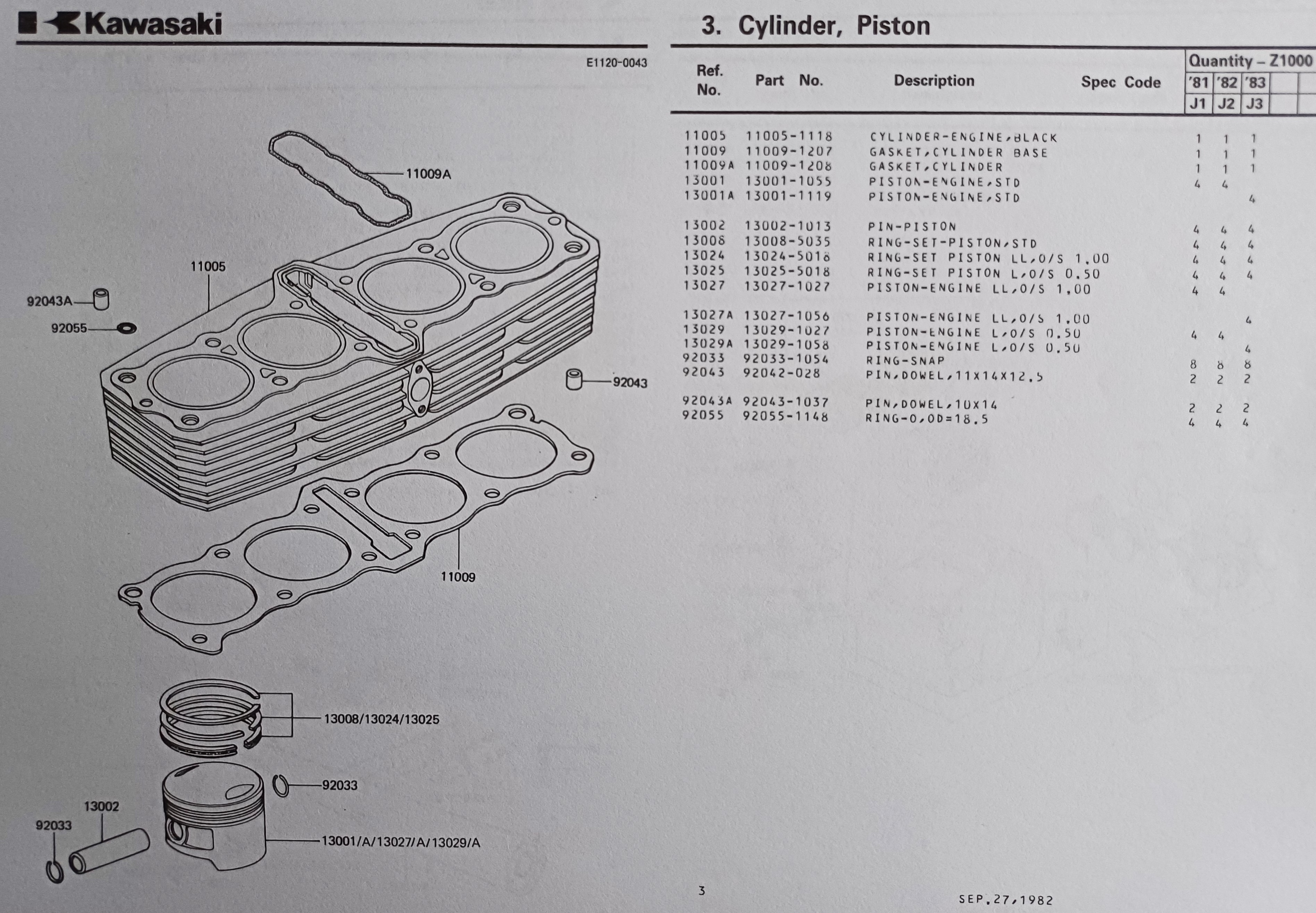

Barrel is from a J model, can't see any o-rings specified for this in the parts book I have?
Correct!
There's no provision for liner 'O' rings on the later models.

kawasaki_man wrote:Barrel is from a J model, can't see any o-rings specified for this in the parts book I have?
Sorry, hadn't noticed is was from the later J model. As has been said, none on this version.
