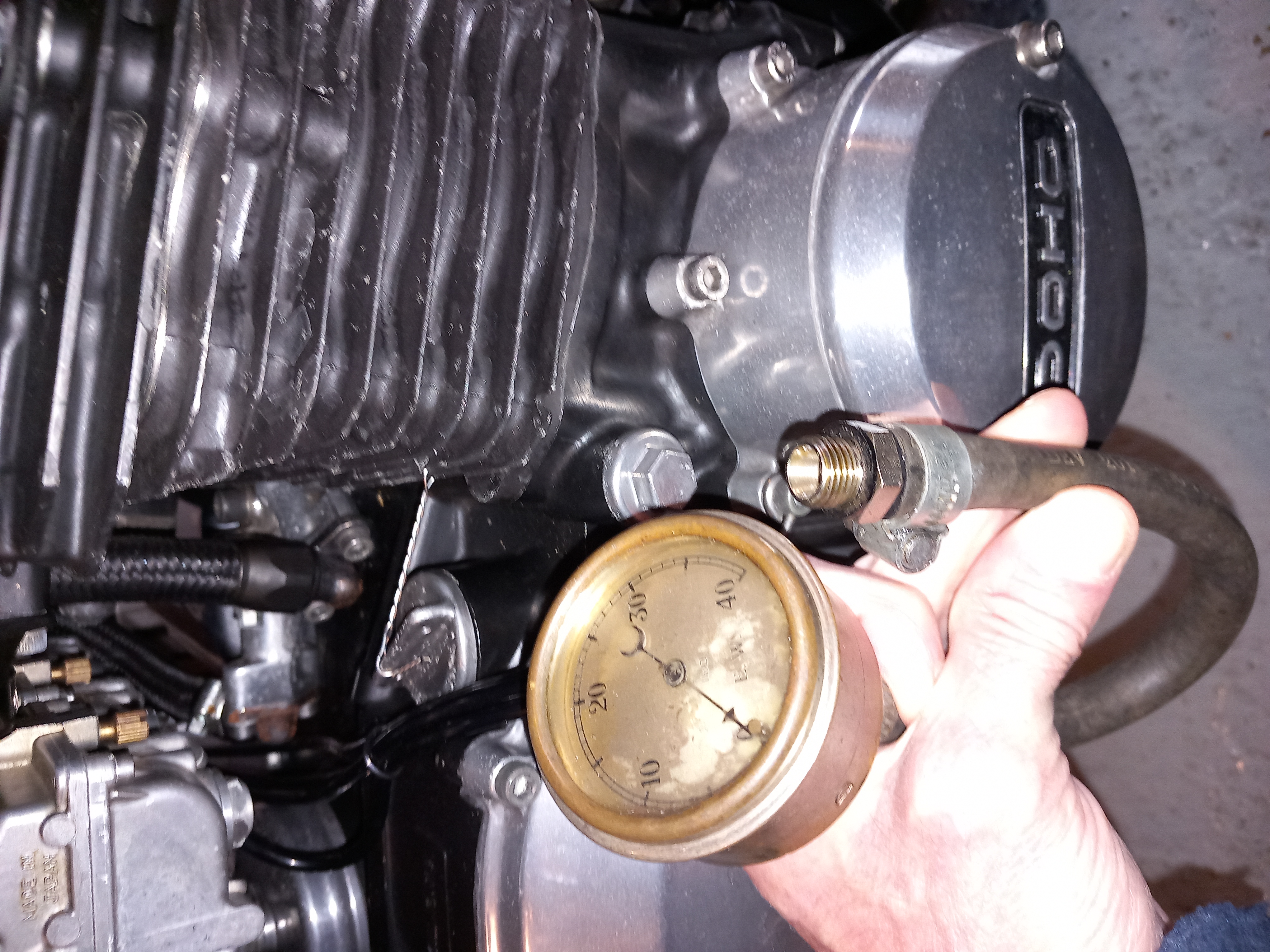

With brand new 20/50, a new genuine oil filter, a less than restrictive oil cooler, at 1500 - 2000 RPM, stone cold, on a good condition engine you could expect to see 15 to 20 PSI. and 2 - 4 ish PSI when red hot.
Old 10/40, red hot; less than 3 PSI at 1000RPM.
