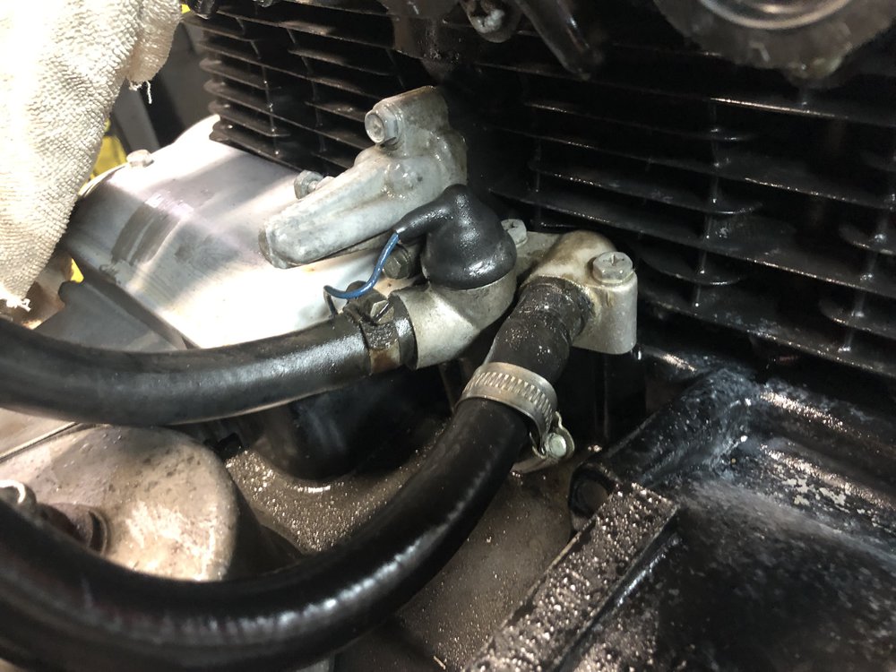

Hello all.
The 1978 Z1R I am restoring has got an oil cooler, which I want to remove. I haven’t seen it mentioned in the parts book or manual so I guess it was fitted by the previous owner.
The two pipes feeding it come from a point behind the barrels.
Can I just take the pipes off from this point and plug the two openings or does it need a circulation of some kind.

You can't just block off the oil gallery.
You need to re-fit a stock pressure switch ( see pic ) in place of the cooler pipe fittings ( or just connect the two with a short loop of hose if you don't want 100% original) otherwise you will starve the engine of oil.

#4 PostAuthor: zed1015 » Mon Jan 06, 2025 11:58 am
The oil cooler and fittings are aftermarket performance parts and not stock parts from a later model.
Original oil pressure switches are listed on Ebay but asking on the forum in the wanted section will likely get you one from a member.
The switch from any Z1 through to Z1000mk2 kickstart equipped engine will fit.
The cooler fittings are also worth a few quid so selling those would more than cover the cost of the pressure switch or form the basis of a trade..

#10 PostAuthor: Al » Fri Jan 10, 2025 1:12 pm
Oil coolers can be a mixed blessing. There is a significant pressure drop across oil coolers, particularly the cheap ones... this on a system that runs very very low oil pressure. There are also fewer alternate routes through a smaller one if blocked by just a small amount of debris. Taken together with an old oil cooler with fibres, carbon, oil line fragments and general smolge after many years of service and you may get cooler oil but much less of it. I would get it running with no oil cooler first to see what it does and then if needs be re-instate the oil cooler if neccessary but perhaps a new one and look to replace those lines with proper stuff.

I’ve fitted the new pressure switch pipe.
Refit the carbs and see if I can get it running, if it runs and sounds okay I’ll finish the restoration and ride it to see if it has an overheating problem.
