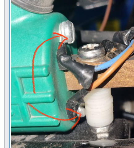

Hello all,
Is anyone able to confirm what size/thread these screws are please,
See image, the 2 screws in each dyna coil,
I have either lost mine or never had them.
While searching the forum for a answer I came across this image so thanks and apologies for pinching it.
They seem to be about m5 but not quite!
Thanks in advance
Stuart

Took the screw out of a disused green dyna coil and inserted a screw which I am pretty sure is m5. (KH400 switchgear screw) So you should be ok with m5 replacement - you should also use a split washer. For info the threaded section is about 8mm and the head of the screw is quite wide at about 9mm. Doubtless someone will be able to confirm.

#3 PostAuthor: skinnyZED » Fri Feb 21, 2025 10:36 pm
Great, thanks for checking,
I didn’t want to mess up the thread by forcing a wrong screw in.

#4 PostAuthor: Gus » Sat Feb 22, 2025 11:27 am
Not M5 they are Yankee imperial.
But I can't remember what size at the moment :roll:

#5 PostAuthor: zed1015 » Sat Feb 22, 2025 11:37 am
They are imperial 10-32 x 5/16 UNF.

#6 PostAuthor: Gus » Sat Feb 22, 2025 11:50 am
Beaten to it.
10-32 x 5/16 UNF pan head screws
I have some here but they are longer and they would need cutting down to length if you want some?

#7 PostAuthor: skinnyZED » Sat Feb 22, 2025 11:55 am
Perfect,
Thankyou for the confirming, and appreciate the offer Gus,
I am pretty sure I have some screws of that size somewhere,
I knew m5 felt almost right !!!

#8 PostAuthor: Kev1R » Sat Feb 22, 2025 3:25 pm
Very surprised at that - the M5 fitted absolutely perfect for the whole length.

#9 PostAuthor: chrisNI » Sun Feb 23, 2025 1:48 am
Kev1R wrote:Very surprised at that - the M5 fitted absolutely perfect for the whole length.
I had a pair with no screw and m5 also fitted perfectly whole length. What is the difference in pitch in m5 and this is thread?

#10 PostAuthor: r3sc » Sun Feb 23, 2025 9:52 am
A number 10 screw has a theoretical diameter of 4.82mm and a pitch of 0.793mm so it’s slightly smaller than M5 in both diameter and pitch.
