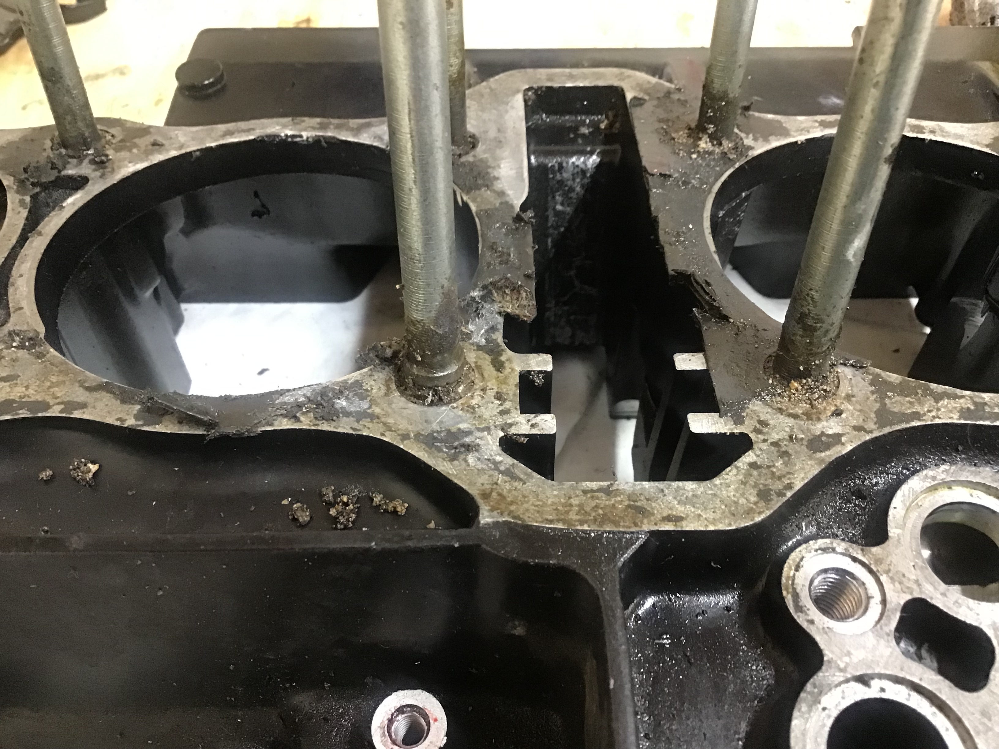

If i upgrade my cylinder head studs to heavy duty is there any other work required

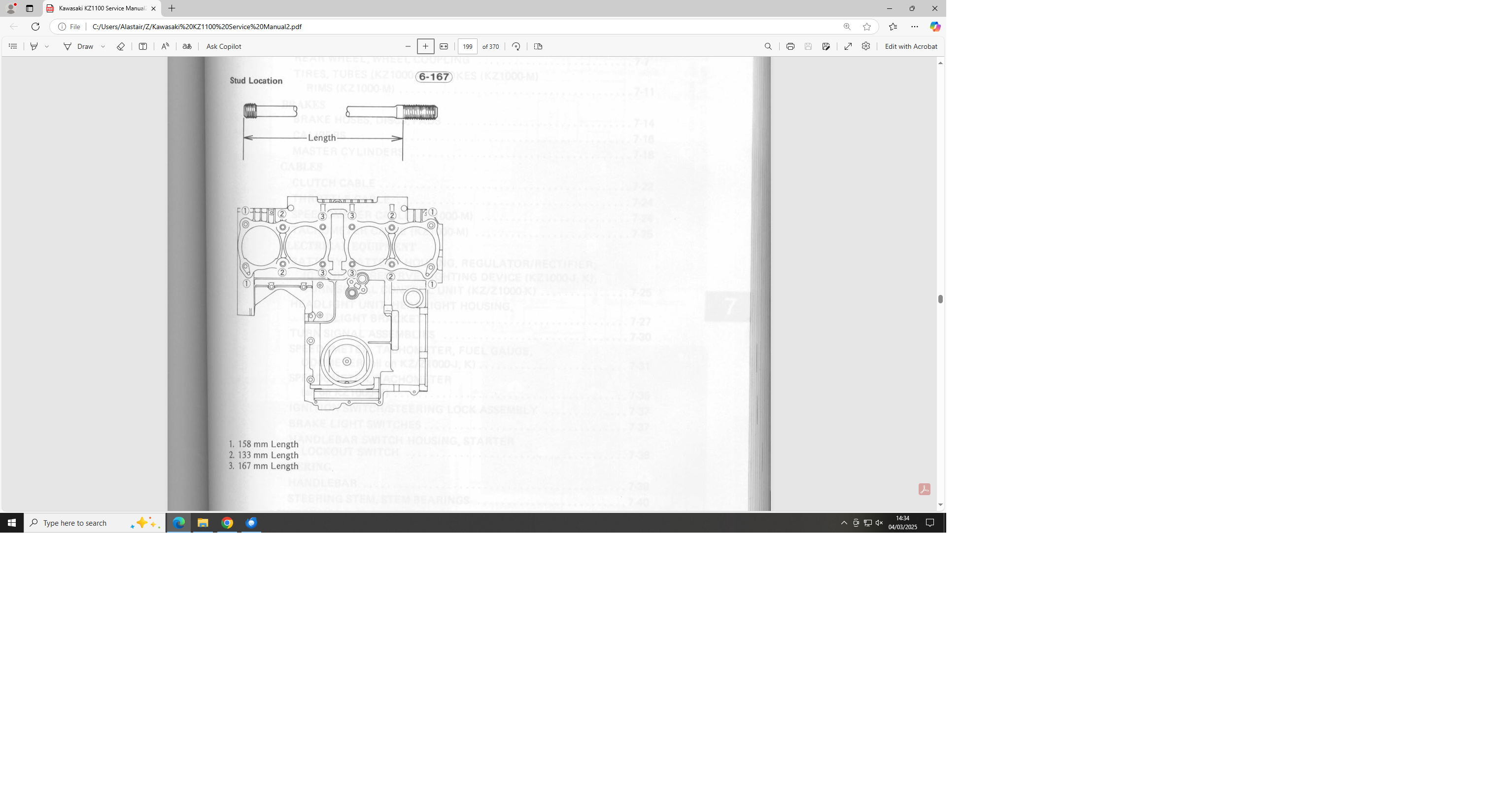

So im removing the studs from the crank casing before vapour and painting I will be replacing with HD studs, i was reading some threads and apparently i should measure carefully the length of the studs as they differ in length I’ve noticed that one of middle 4 is a fair bit shorter is this correct?
Posts: 4037
Re: Cylinder head studs
#5 PostAuthor: zed1015 » Tue Mar 04, 2025 1:48 pm
stusco wrote:So im removing the studs from the crank casing before vapour and painting I will be replacing with HD studs, i was reading some threads and apparently i should measure carefully the length of the studs as they differ in length I’ve noticed that one of middle 4 is a fair bit shorter is this correct?
No! The middle 4 are all the same length.
There are 3 different length studs.
The middle 4 either side of the cam tunnel are the longest .
The outer 4 are shorter .
And the ones in the middle ( between cylinders 1-2 and 3-4 ) are the shortest .
You should measure the installed heights of the stock studs and then fit the APE ones to the same height and mark them level with the crankcase with tape or similar.
This does not mean that the APE ones will be bottomed out in the cases.
After test fitting you should apply permanent red loctite to the stud threads and screw the studs into the case to the correct heights ( indicated by the tape etc ) and then leave the loctite to set.

I’ve measured them now i should wear my glasses one of the middle ones has unscrewed i bit

#7 PostAuthor: Al » Tue Mar 04, 2025 2:36 pm
This may help
Click the pic to zoom
