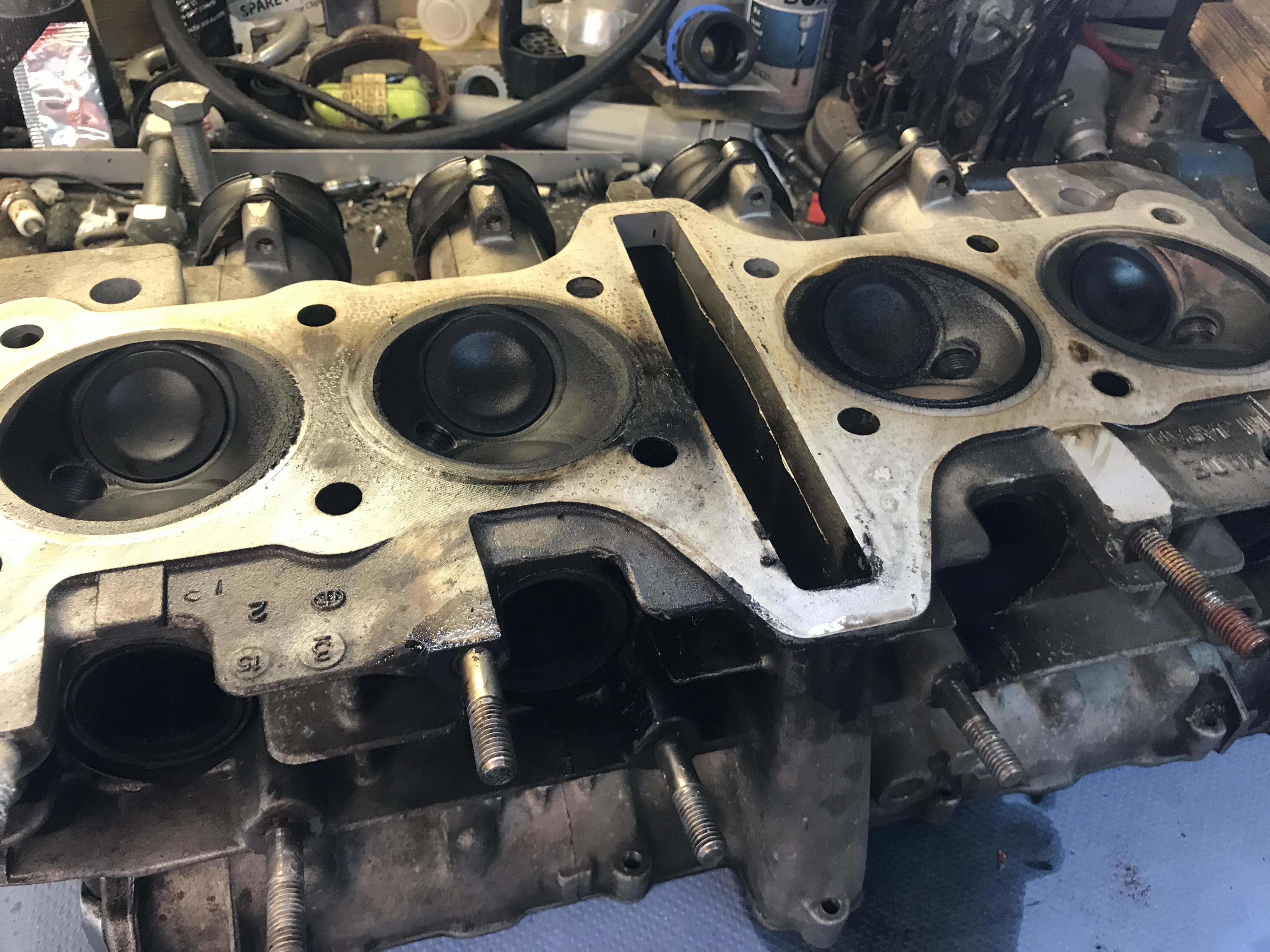

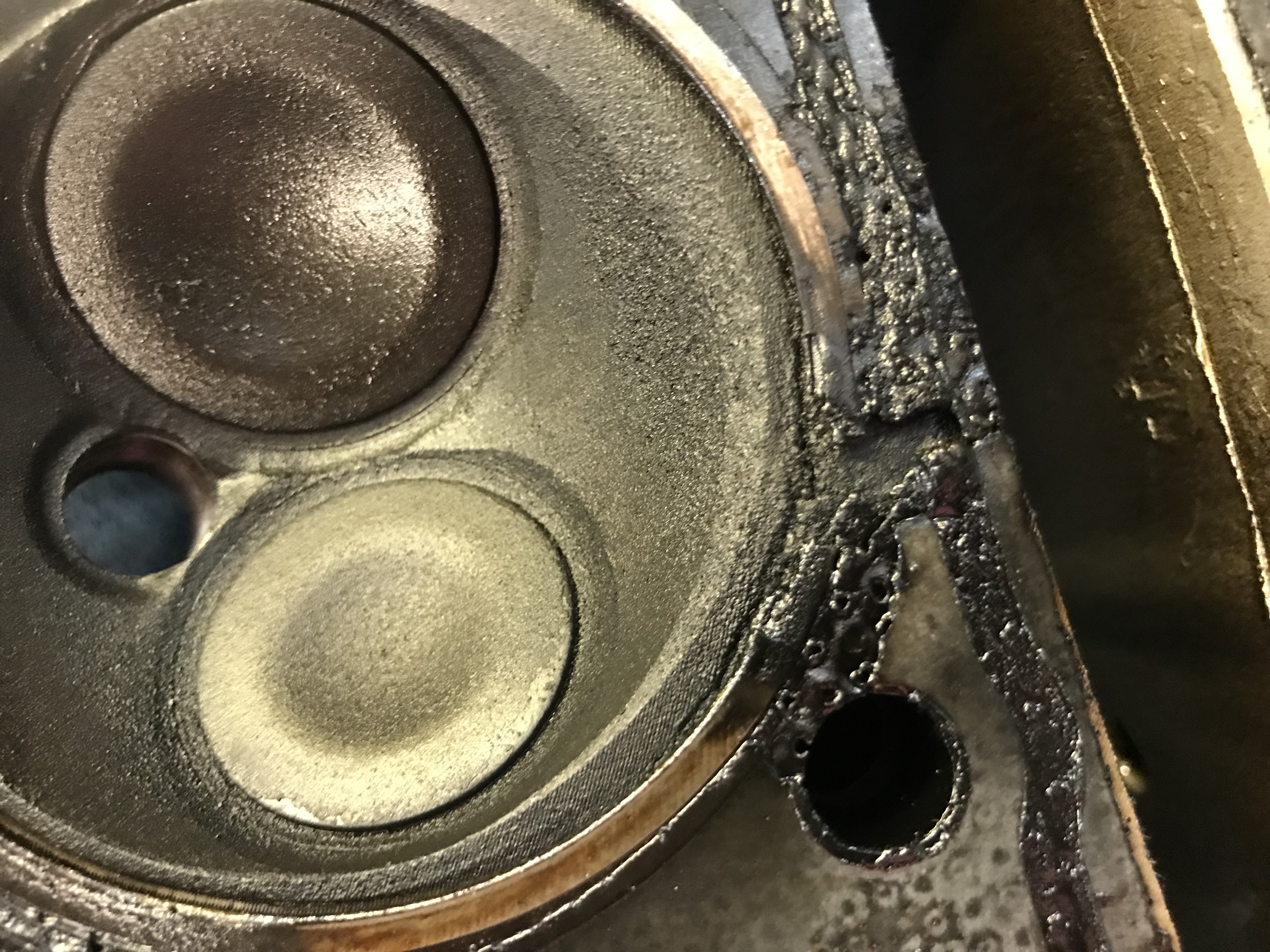

Good morning engine experts. I am helping a friend with a Z1100 (shaft) that keeps burning holes through its head gasket. It first happened soon after he bought it, between cylinder 3 & 4. The head was then re-faced and reassembled with a new Cometic gasket. After poor running issues were reported again I took the top off again and found it's burnt a hole between cylinder 2 and the cam tunnel. Its probably only done about 500 miles between the two events.
The engine is running high compression 75mm (1170) Wisco pistons. When the correct size head gasket is laid over the upturned head there is a circa 5mm ring of flat head (squish) visible inside the head gasket hole. The gap between the top of piston at TDC and the underside of the squish band is therefore the thickness of a head gasket (1.05mm) plus the gap between top of piston edge and top of barrel (0.2mm) so so a total of 1.25mm which I would have thought would be okay. However, as the head and block now need re-facing it will reduce.
Given that reliability is more of a priority than performance I am considering reassembling with 2 base gaskets to raise the deck height by 0.5mm and therefore reduce compression. Has anyone done anything similar? Does anyone have any better ideas?
I have attached some pictures.
Many thanks.
Many thanks.

Re: Z1100/1170 head gasket issues
I had a similar experience moons ago.. Eventually tracked it down to a stud not being put far enough in the crankcase. So although the head nut was torqueing down it was actually torqueing against the last of the stud threads not the head so the gasket wasn't completely compressed.. Oddly enough it was the inner front stud on number two cylinder as it appears yours is. Extra copper washer under the head nut sorted it as it gave enough thread for the nut to compress the washers and gasket and torque against the head.
Thanks for the suggestion Warren. Just had a measure up and unfortunately that isn't the solution. It would have been nice if it had been!
It's gotta be something like that. Head twisted? Head on a sheet of glass and see if you can get a feeler guage between the two anywhere. I always find a shelf out the fridge is just the right size, when the missus it out.
Hi Steve, in your O.P. you wrote:
"Given that reliability is more of a priority than performance I am considering reassembling with 2 base gaskets to raise the deck height by 0.5mm and therefore reduce compression."
This is probably not a bad idea - its been done before !
Looking at pictures its always hard to tell but it looks like maybe several issues here.
That said, as Warren advises, you need the head and deck faces FLAT and then proper gasket prep. and re-torque.
To just get the motor in a usable running condition, proper gasket seal and LOWER compression would be my advice.
An 1170cc motor doesn't need high compression just to get down the road !
Keep in mind that whatever you machine off head or deck face will INCREASE the compression which is not what you want.
Just to mention for reference, back in the day you could buy aluminium alloy or copper base spacers in various thicknesses.
The 1mm squish clearance by the way is a MINIMUM clearance recommended when setting up for racing. You can open that clearance up a fair bit !
Dave, thanks for that. I think that maybe the route I will take. He's not a speed freak (like me LOL) but just wants his bike to work!
