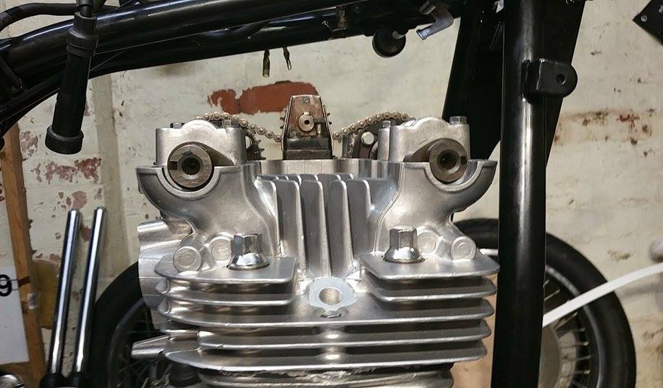

camshafts should be in this position when the valve timing is set correctly noting the position of the notches in the end of the camshafts

#27 PostAuthor: 1975-S1C » Mon Sep 11, 2017 8:31 pm
Yes indeed, it was exactly like that.
