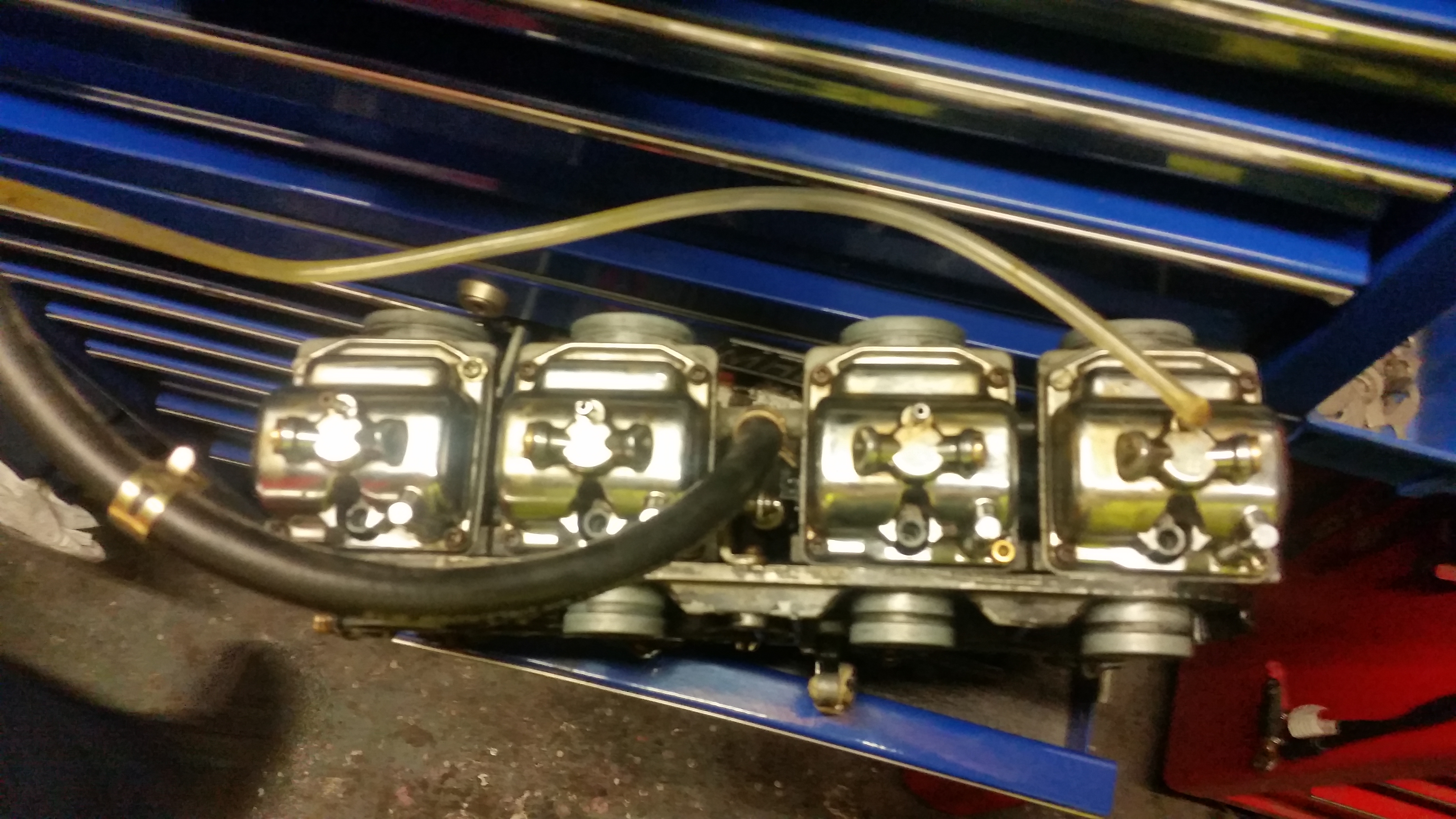

Carbs like these
Posts: 4040
Re: Carbs or cams
#20 PostAuthor: zed1015 » Tue Dec 19, 2017 11:52 am
Swirl wrote:Carbs like these
Yes! they are the ones.
Looks like you already had them on the bike then ? so saves a search and a few quid.
Have they got just the air screw on the side (Z1R) or Fuel mix as well at the float bowl ( Suzuki ).

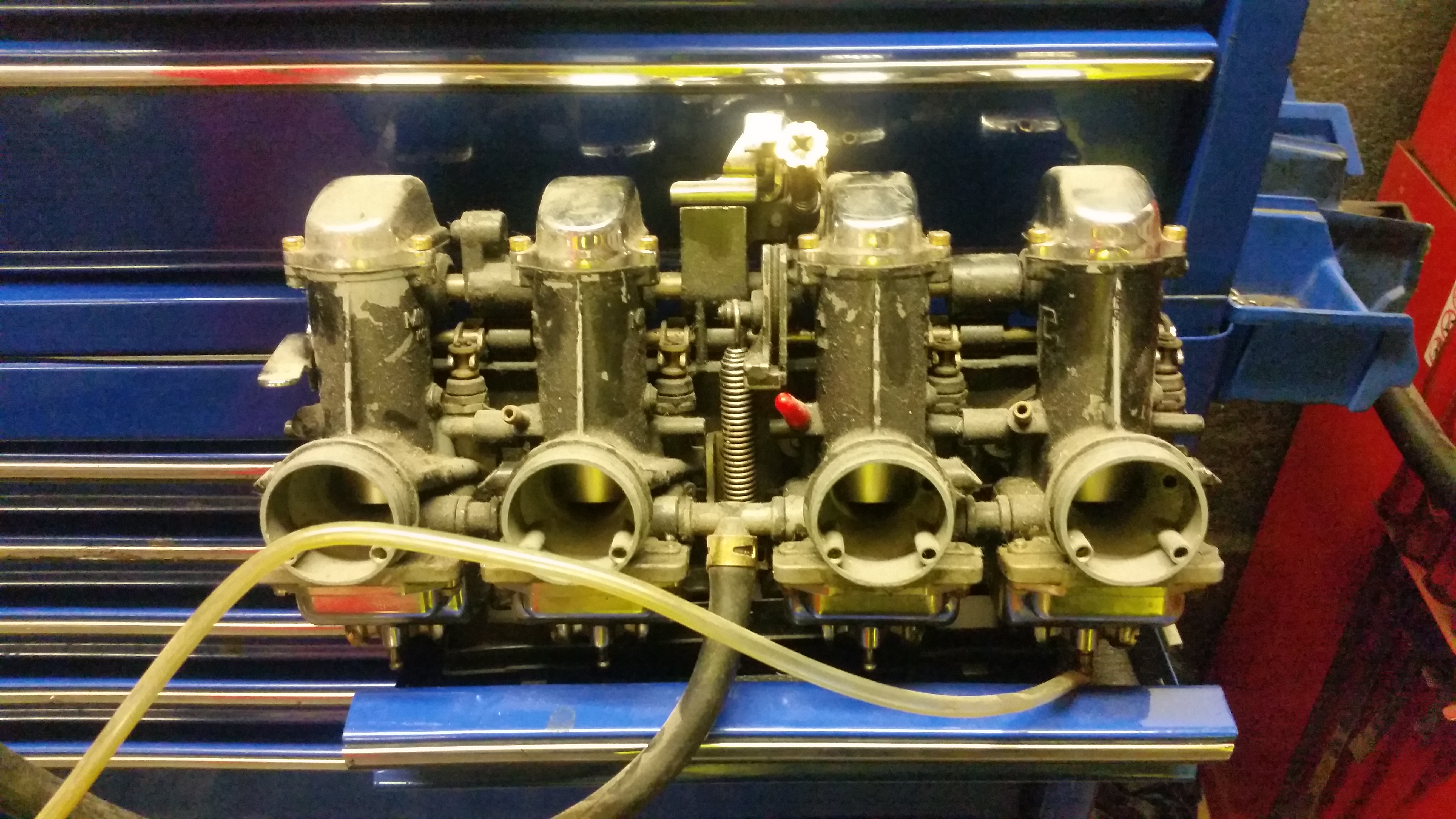

#22 PostAuthor: Swirl » Wed Dec 20, 2017 8:04 am
Bit dusty, but triple chromed

Swirl wrote:Bit dusty, but triple chromed
Yes! Z1R carbs with 'A' model idle screw set up.
Just need a some air corrector jets fitted and you are sorted..
