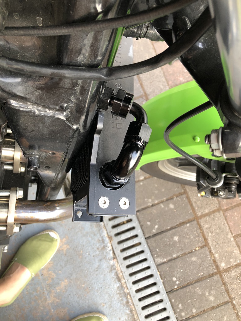

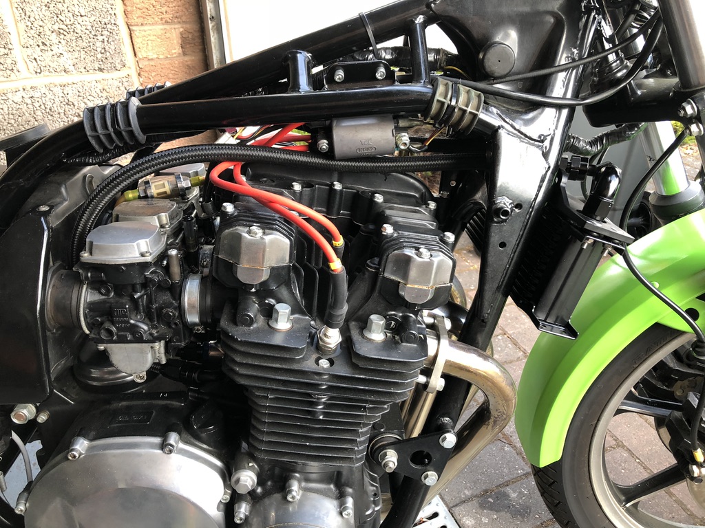

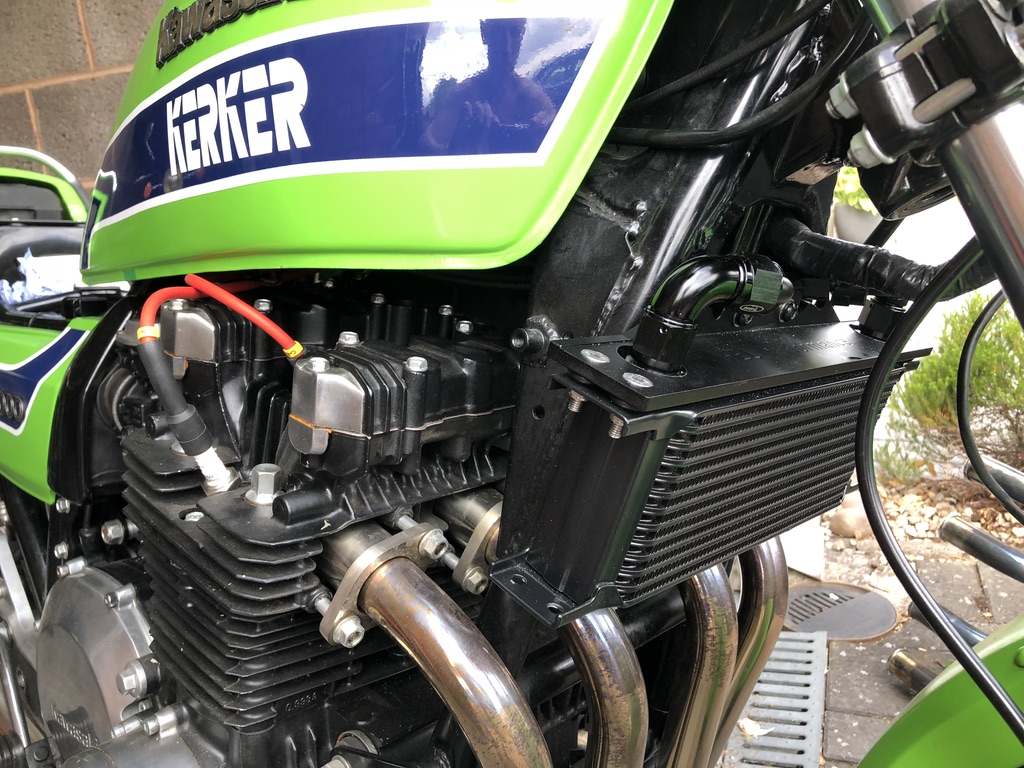

So, I re-routed the hoses to run under the tank and adapted the bracket holding the radiator to allow more space through the front of the frame triangle.... only to find that the hoses were then not quite long enough to bolt onto the radiator without being in tension and with some sharp bends :x
I could have re-routed again to bring them directly behind the engine, but wanted to avoid extra heat as much as poss.
Simple solution was to order a couple of 90 degree shoulder joints to connect the hose ends to the radiator, which has neatly got over the hose length and sharp bend issues. So now I have exactly what I set out to achieve, hoses coming out the top of the radiator, away from heat sources (as much as poss) and now tucked nicely away.
Job done :D
