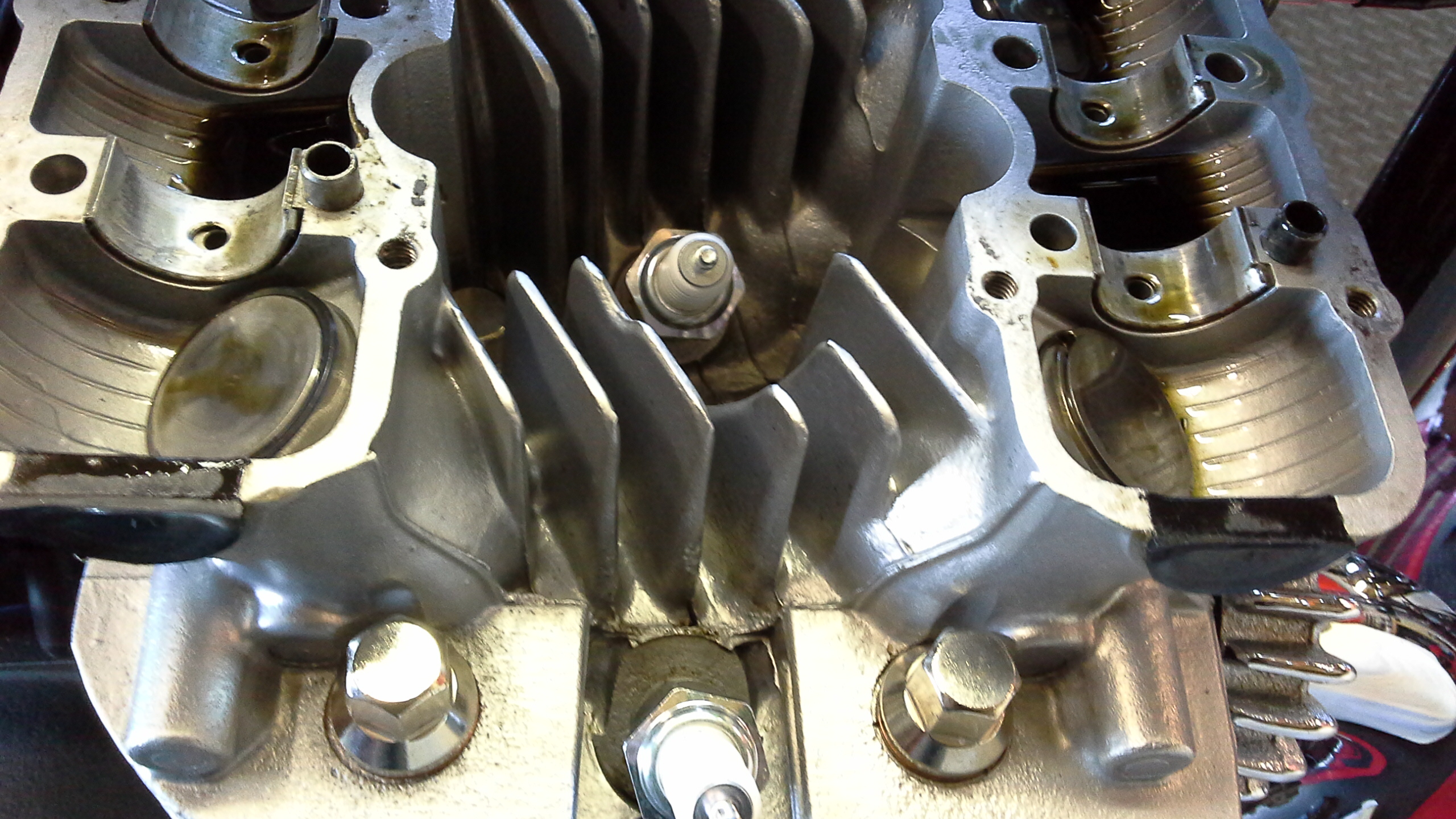

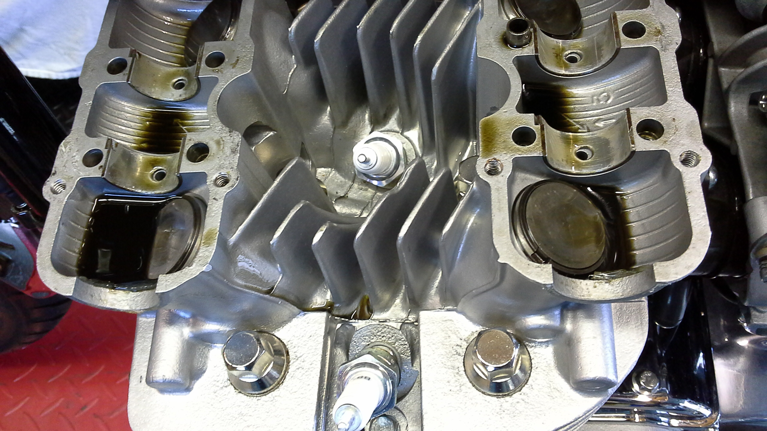

Just a quicky chaps, taken the cams out this afternoon and observed this amount of oil on buckets n01, whilst buckets n04 are nearly dry. Being as though n01 pot was the problematic one, is this a clue as to what's been going on, or is just because it had been on the sidestand.
Re: Valve seal
The oil is there just because it's been on the side stand.
HOWEVER! If you keep the bike on the mainstand it will allow the oil held around the cam buckets to drain away and limit the amount of oil that can seep down the guides which will then reduce the amount of smoke you get on start up...
