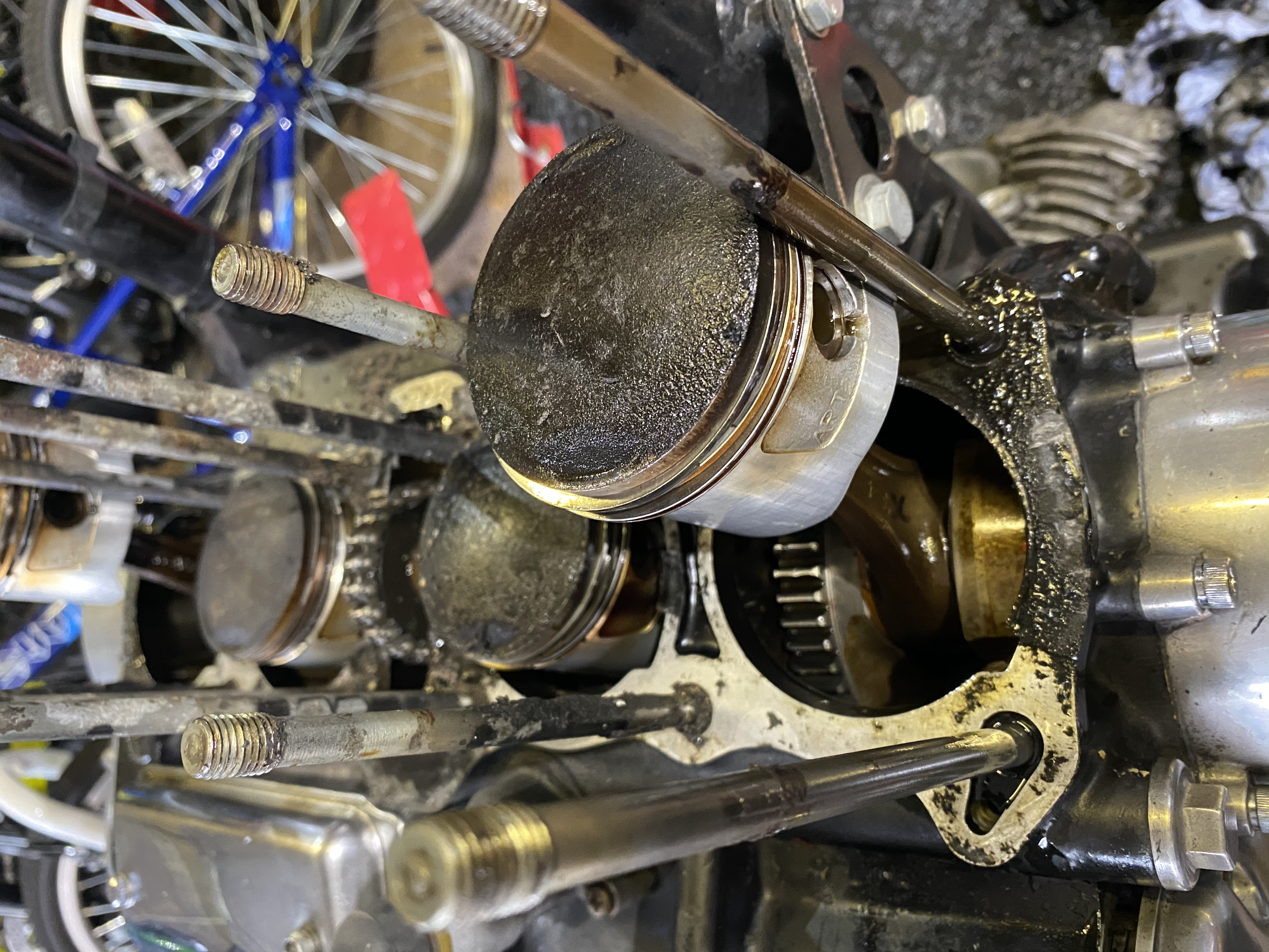

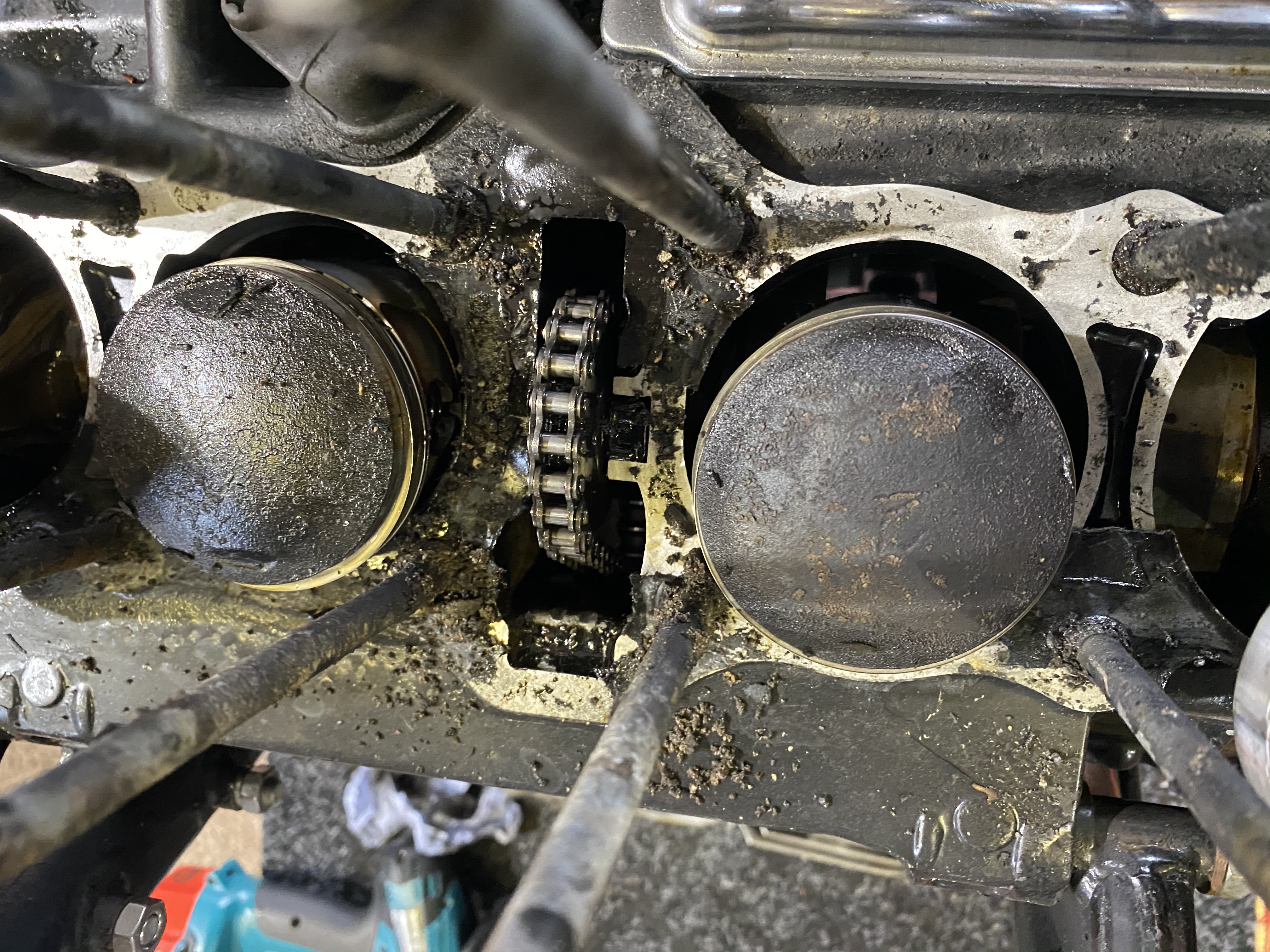

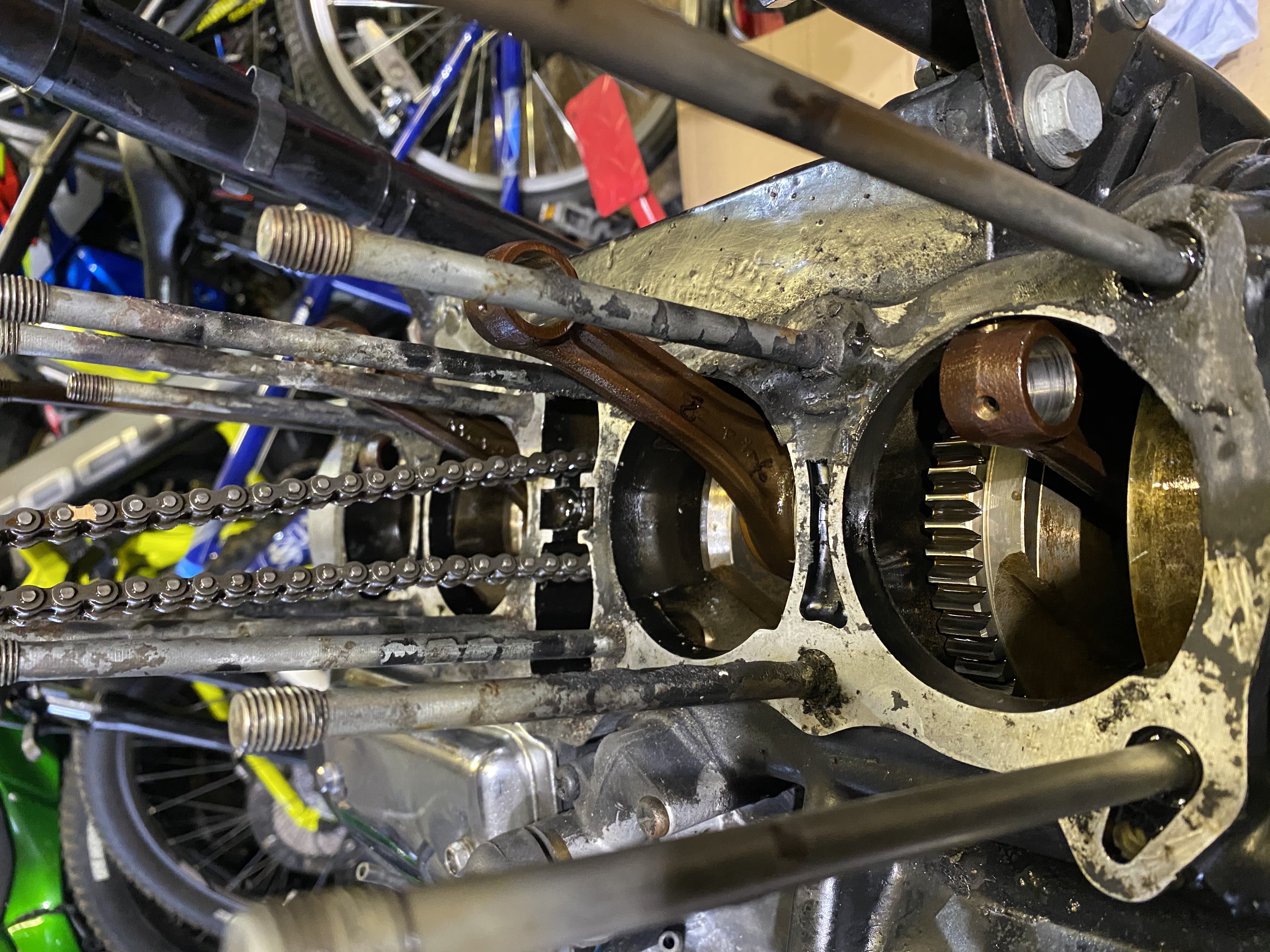

Well, I’ve now jumped in with both feet on my first complete strip and rebuild. Gulp. So happens that the cam chain guide had simply - well - disintegrated!! It wasn’t pretty in there but I can imagine it could’ve been a damn sight worse. Thanks for all the help so far. God know I’ll probably need more over the coming weeks.

at that point i'd do a full strip/clean/check.
Split the crankcases and check all the bearings etc.
