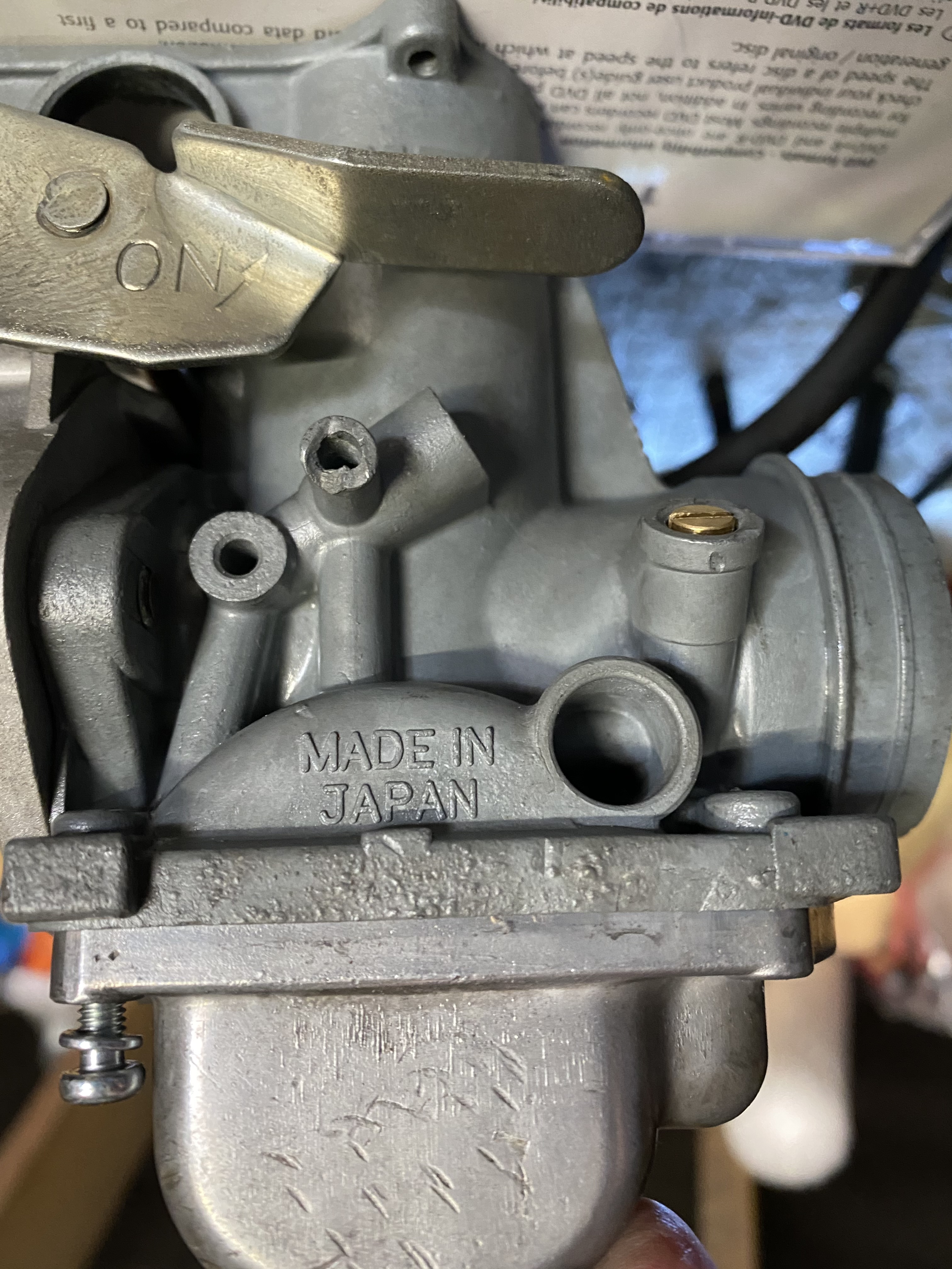

I would also like to see a pic of this other jet you say is present as there should not be any exterior removable jets unless they are air correctors which have been ruled out..

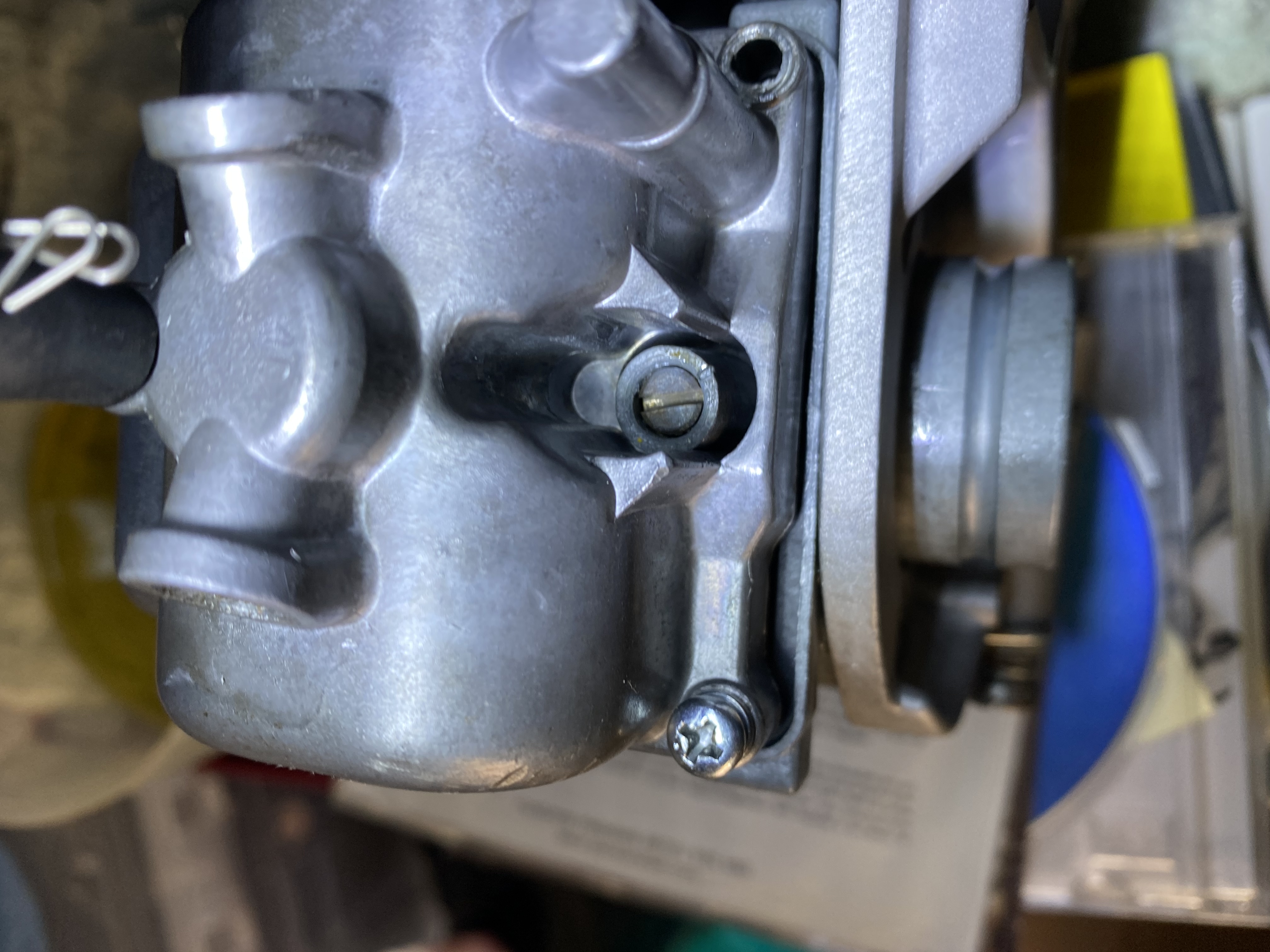

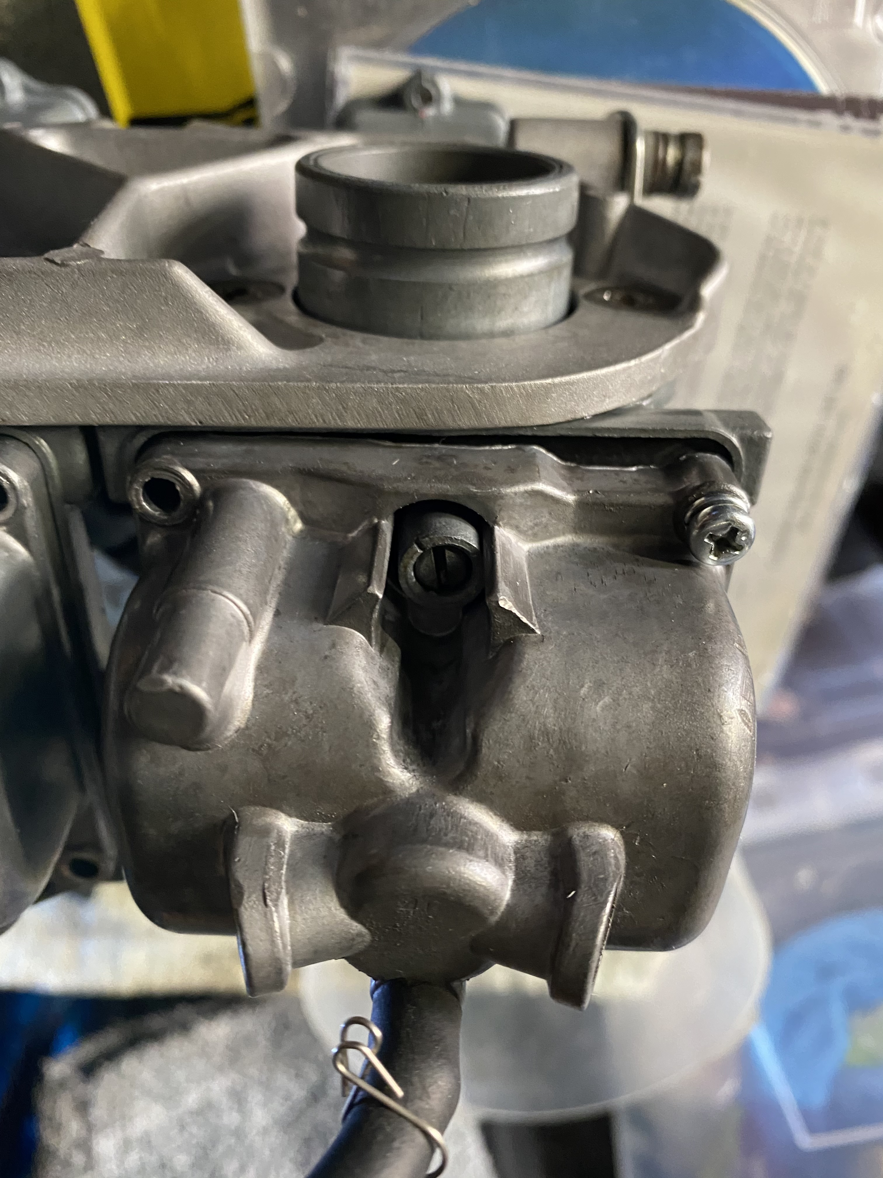

2 pics attached
Re: Desperately need help
The one in this pic was installed in a range from all in to 4 turns out.
They’re all set to 1 1/4 turns out now.

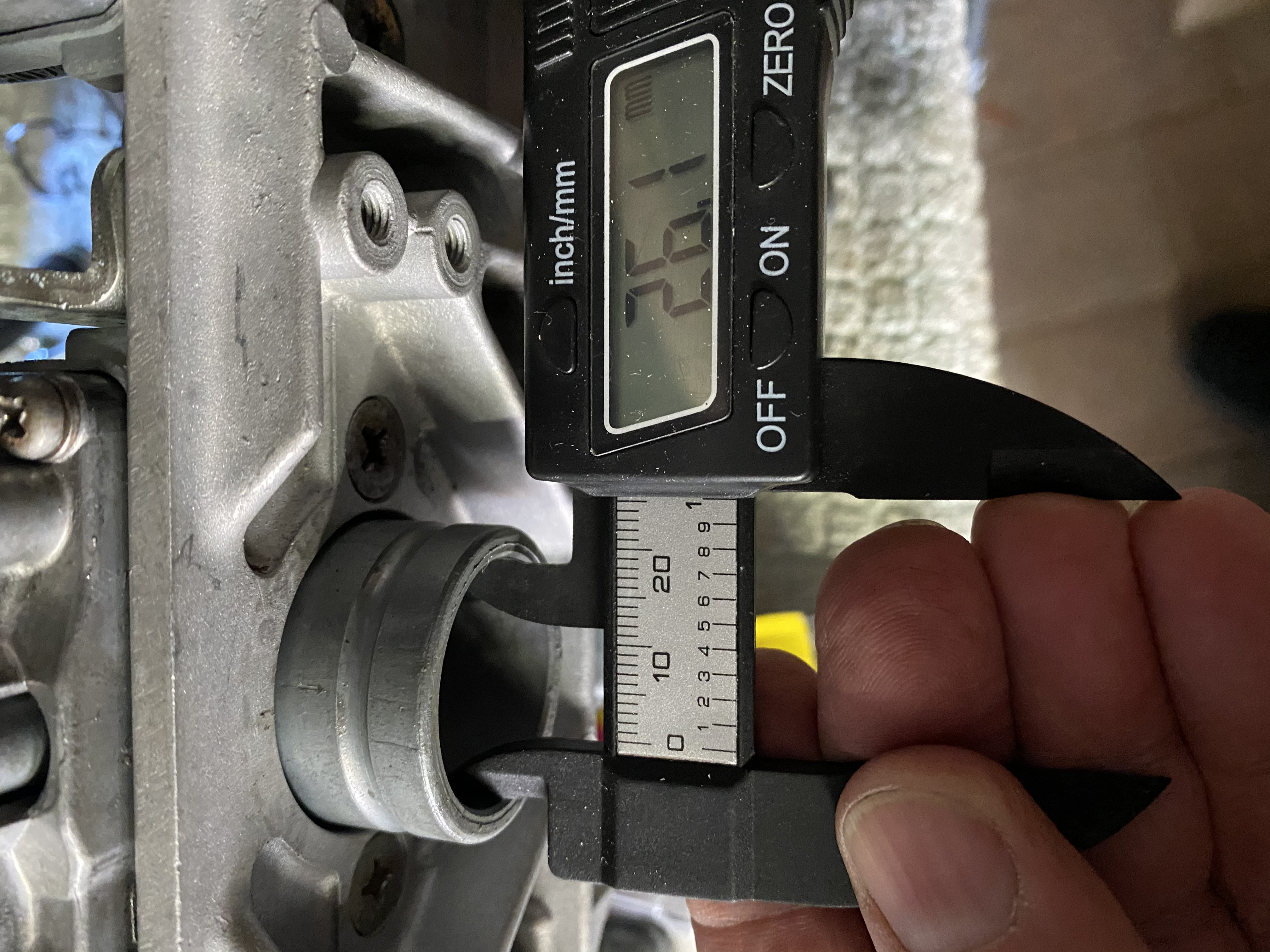

The engine end is 26mm

Yes! Those are Suzuki VM26.
No sign of the additional jet you mentioned..
The fuel mix screws underneath were set individually at the factory and sealed for US emissions.
There is no book setting.
Which Keyster kits did you fit and which components did you change.
Compared to the Z's VM's the pilots on these carbs are on the large side (usually 20 ) whilst the mains are smaller (around 95 compared to 112 ish ).
Apart from air screws and float valves you should re-fit all the original Mikuni internals if needles etc were changed.
Ideally you would use a Keyster GS1000 kit if absolutely necessary.
