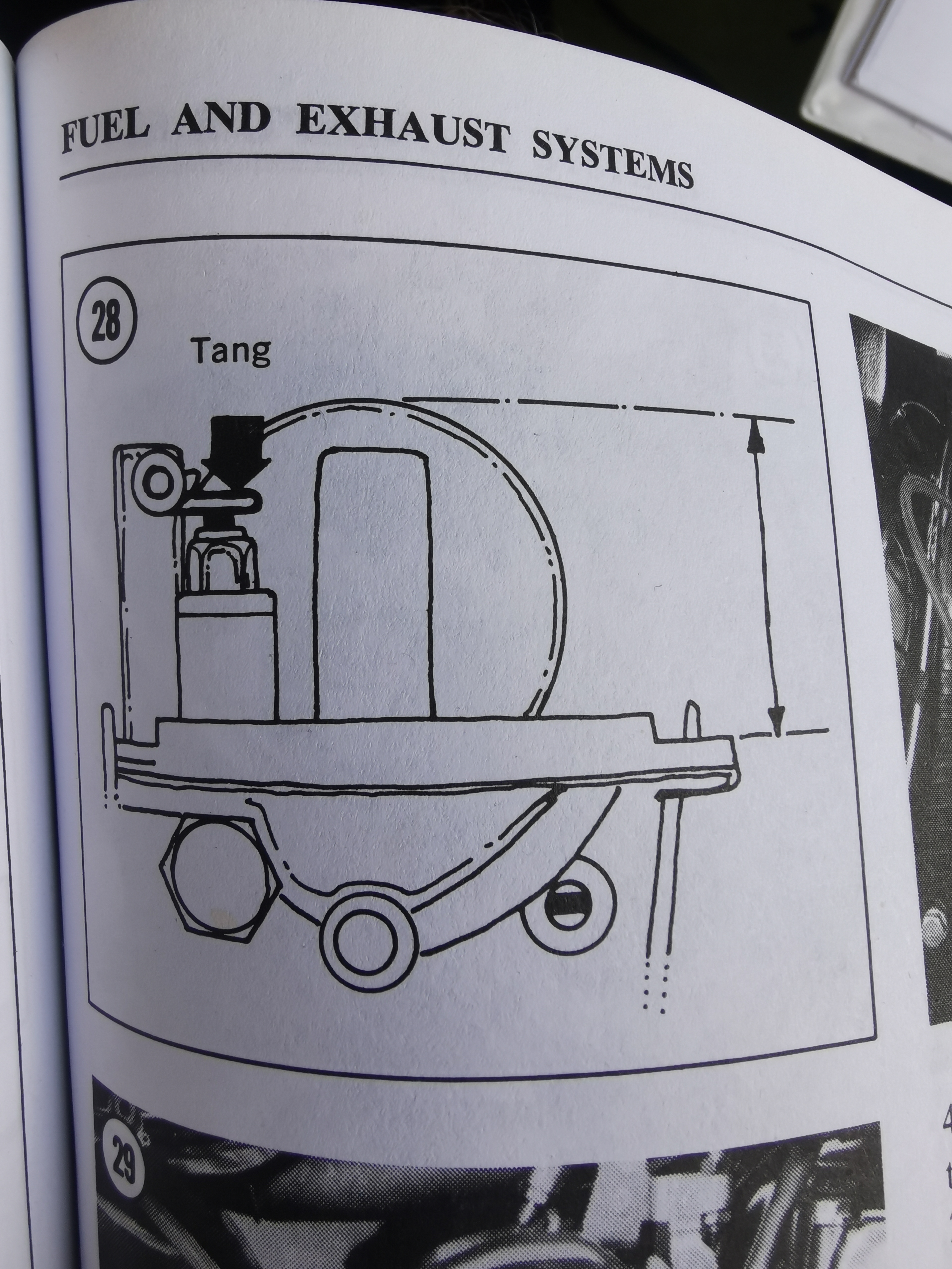

Can you kindly include a photo of figure 28.
Attached mate

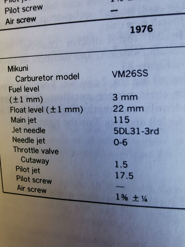

Very confusing with data sheets giving 22mm for the 26mm carbs but also being advised they should be 26mm?
Workshop manual Carb Data.jpg (96.67 KiB) Viewed 11168 times

The question of 22mm vs. 26mm has come up many times before and i still dont know the answer. With regard to another type of carbs i am aware of at least two different versions of the way it gets measured for that specific variety. One is with the carbs vertically upside down and the other is with the carbs 90 degrees to the horizontal. The latter has the float tang resting lightly against the valve, the former with the valve fully depressed. It would be useful to finally put it to bed but without the test method being stated, the measurement is meaningless. What is consistant though for these carbs as well as most others i have seen, is the 3 or so mm below the float bowl face and the use of the 'wet method' for certainty to quantify this. I prefer this in all cases but do it with the engine running which is fine. It gives a great deal more information than the static 'wet' test with little or no more drama once you get used to it. It also takes out a lot of the inconsistencies of the static 'wet' version!
Anyway; just read the 'early' manual for first generation 900's and in there it says that; "The fuel level is defined as the vertical distance from the centre of the carburettor main bore to the surface of the gasoline in the float bowl". In this case it is given as 32mm +- 1mm but critically,.. it is still 3mm below the face of the top of the float bowl. This is for VM28 which naturally have a different radius component to that calculation than the VM26.
So that is three , at least, different measurements or measuring methods :oh

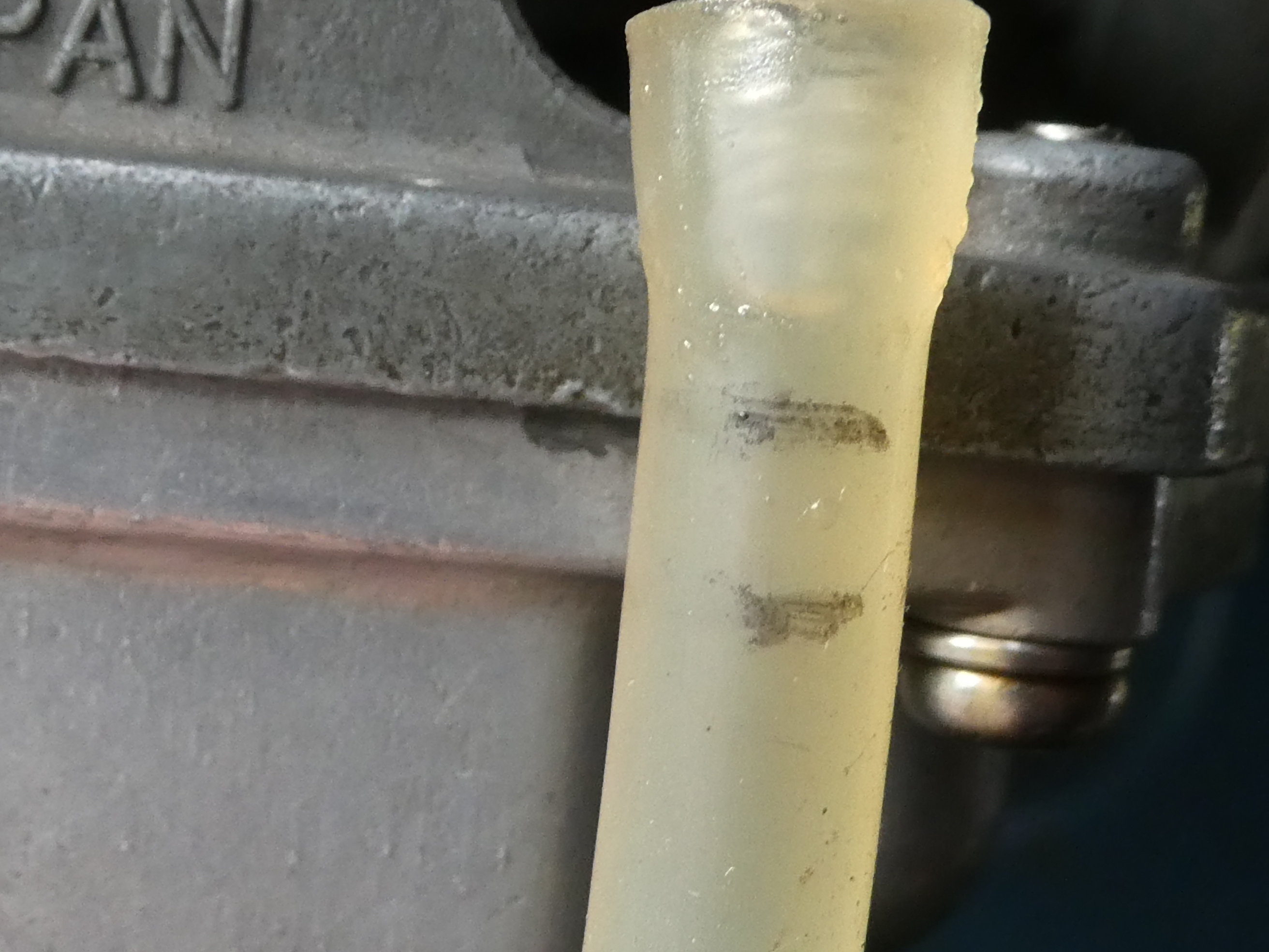

With the float heights set to 25mm when doing a 'wet' test the the petrol in the bowl is above the body flange, see attached photo, I'm at a loss!
Clearly this is why they were originally set at around 29/30mm which is way above where they should be yet I will still suffering from running rich, though I still have the refurbished choke plunger seals to try, but I don't to fit the carbs again only to have to take them off again so need to get the float levels sorted before I re-fit them.
Any suggestions as how they need tp be set? Ignore the static float height level, that should be more or less right or simply set the wet level around the 3mm below the edge of the body flange what ever the float heights are?

Just based on the photo above; that would be a great place to start. Choke plungers will make a disproportionately greater difference to mixture strength by far than will a few mm this way or that on the fuel level height. When i do mine i may have to take them on and off four, five times, perhaps more, perhaps less and for this reason, knowing i wont get it right first time i dont fit the airbox. From the photo; the carbs are not level. Thats OK if that how they are when sat on the bike. In which case i would take the reading equidistant between the screws on the side ie. half way along that taper which will change the visual reading by a couple of mm. Similarly; if you move the tube 2mm higher by accident, when doing the readings, that will stay 2mm higher than the true value which is why i do it with the engine running.
The picture appear to show the fuel level in pretty much the correct place if the tube were moved left toward the centre of the float bowl. You are looking for 3mm i believe, below the the joint where the gasket sits, ie; top surface of the bowl which it appears to be, or would be if the hose was in the middle.
After you fit the choke plungers and run it, if you cant adjust the mixture strength weak enough at idle, that would be the time to re-visit the float heights. Sooty plugs will not be a function of a strong idle mixture except if running it exclusively on idle. The idle circuit is a very small fraction of the percentage of fuel in the carbs above idle and whilst it does provide 'trim' for the greater throttle openings, its contribution is minimal unlike 'passing' choke plungers.

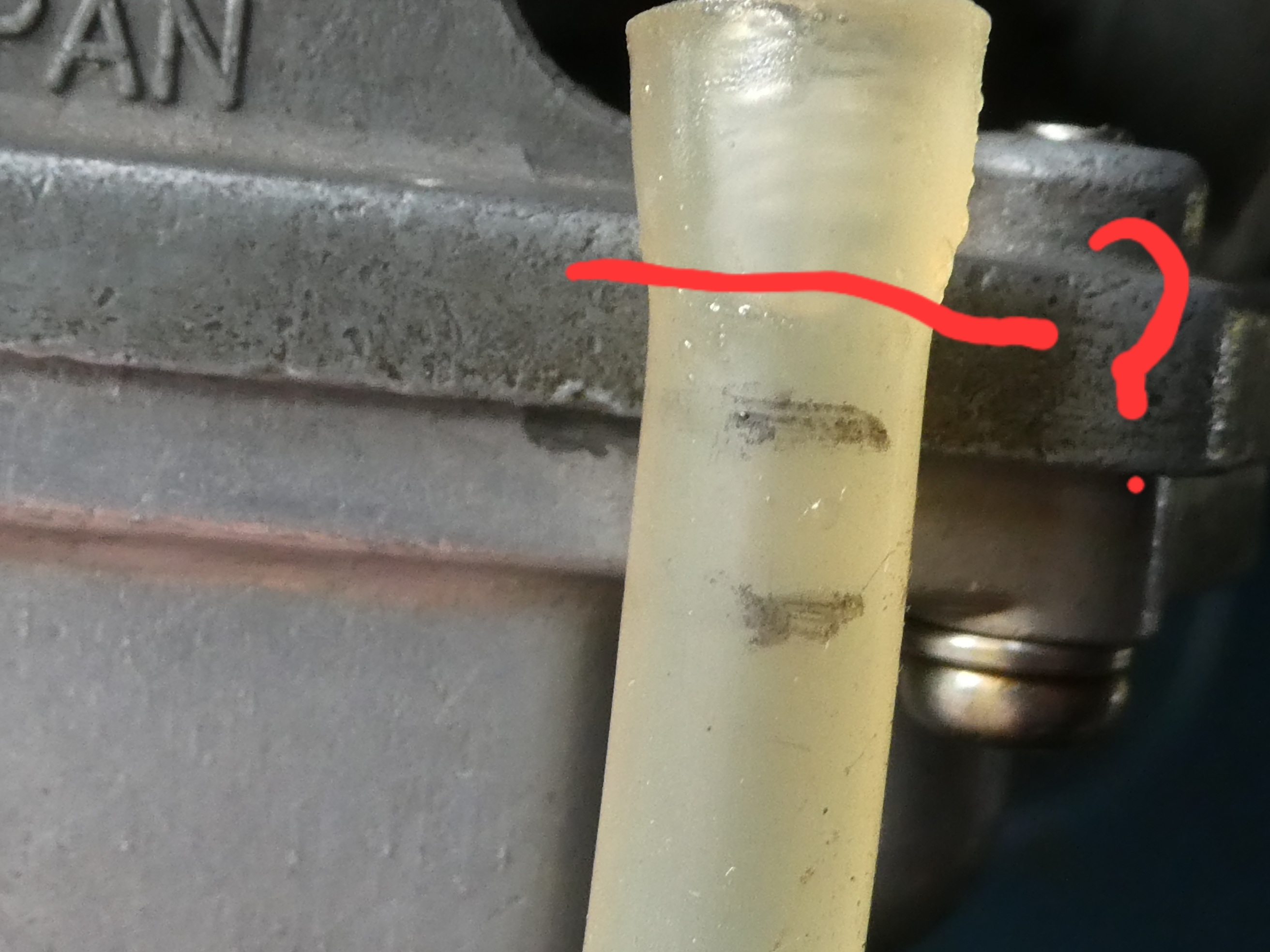

Your photo below isn't that clear, it looks to me like the fuel level is way above the top black line?
sprint wrote: Any suggestions as how they need tp be set? Ignore the static float height level, that should be more or less right or simply set the wet level around the 3mm below the edge of the body flange what ever the float heights are?
Below the mating faces not the body flange.

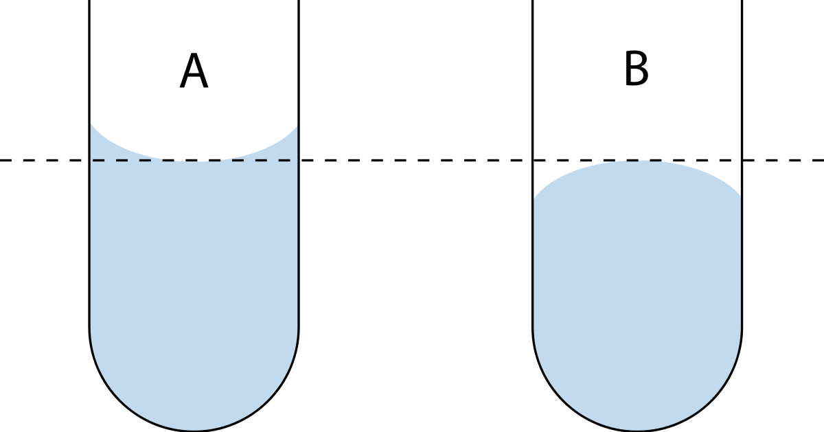

Not that line; Meniscus is always defined as the centre of the tube, meaning; read at the centre of the tube so in this case its the lowest part of the downward curve.

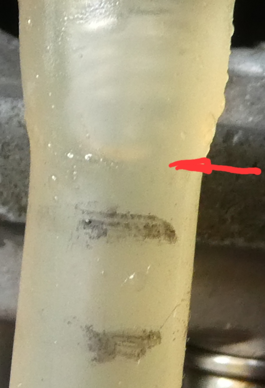

#27 PostAuthor: warren3200gt » Sun Jul 09, 2023 2:09 pm
Here then.?
Where my less than straight line was meant to be.

warren3200gt wrote:Your photo below isn't that clear, it looks to me like the fuel level is way above the top black line?
Two pages ago

Unfortunately I do not have a better clear tube but yes that is the level that you have marked, which is around 5/6mm higher that it should be, should be at the lower black marked level.
As an update I changed the float height from 25mm to 30mm and it has made no appreciable difference in the wet level, so I really am at a total loss at to what is going on here as the wet level seems to be totally independent of the float height?
Yes the floats are the right way round, with the tang stopping the floats dropping too far and not lifting too far.

Al wrote:Not that line; Meniscus is always defined as the centre of the tube, meaning; read at the centre of the tube so in this case its the lowest part of the downward curve.
Thanks, but the measured height is out by around 5/6mm so the meniscus is not having any realistic effect, I wish it was close enough that it was only a meniscus issue.
