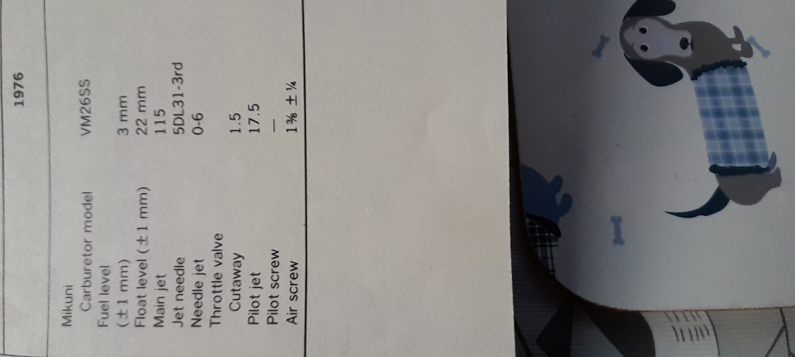

Thanks for replies Guys,
Steve yes will give the rubber links in carb outlets a try, may help,
Kev no idea what restrictors are but when i stripped carbs down there didnt look like anything had been added.
Yes i know to check and re check, this stuff has been checked multiple times to the best of my ability, but that may not be good enough?
Valve Timing- 3 or 4 times as stated spot on
Clearences left slightly on loose side as know they close up after running, but this will prevent any valve remaining open if too tight, and inly downside bit noisier and loose a bit of power due to less lift, ill re do correctly after its bedded in.
Carbs - fully stripped cleaned, blown through with compressed air, all new gaskets jets etc, replaced choke plunger seals, set up to standard, float levels set up, air leaks checked. No leaks as far as im aware, standard air filter, but no damper tube, but that only quitens induction. No longer overflow, all chambers filled with fuel similar quatities in each when drained so valves doing their jobs.
Ignition- George mod done, good voltage at both coils,call 4 plugs teplaced with Denso and cleaned before using after rebore all gapoed corectly. Good spark on all 4 cylinders, all 4 pipes get hot at front and similar output at rear, no smoke.
Am trying to time it using strobe on full advance ie fast tick over 2000 revs, find it difficult to see marks as dyna s has much smaller opening then original, so a lot of the light from gun gets scattered. Will keep trying, but cant see that being the cause, but it does need doing so eill keep at it.

Re: Bike Z900 A4 not running correctly (Still)
Open up the hole for your timing, air restrictors may be in the backs of carbs, these get installed when people put pod filters on, in a previous ownership this may or may not have been done.
Make up a damper tube as well, this may help stabilise airflow going to the carbs, unstable air flows can cause problems, had a thou once that didn't have its rear portion and it ran poorly until one was installed.
Dyna s plate may be wrong way round.
Weird george mod not necessary, clean all connections and make snug.
Oversized battery not needed ever.
Are carb settings right for carbs?
Make sure airbox to carbs is free of leaks.
