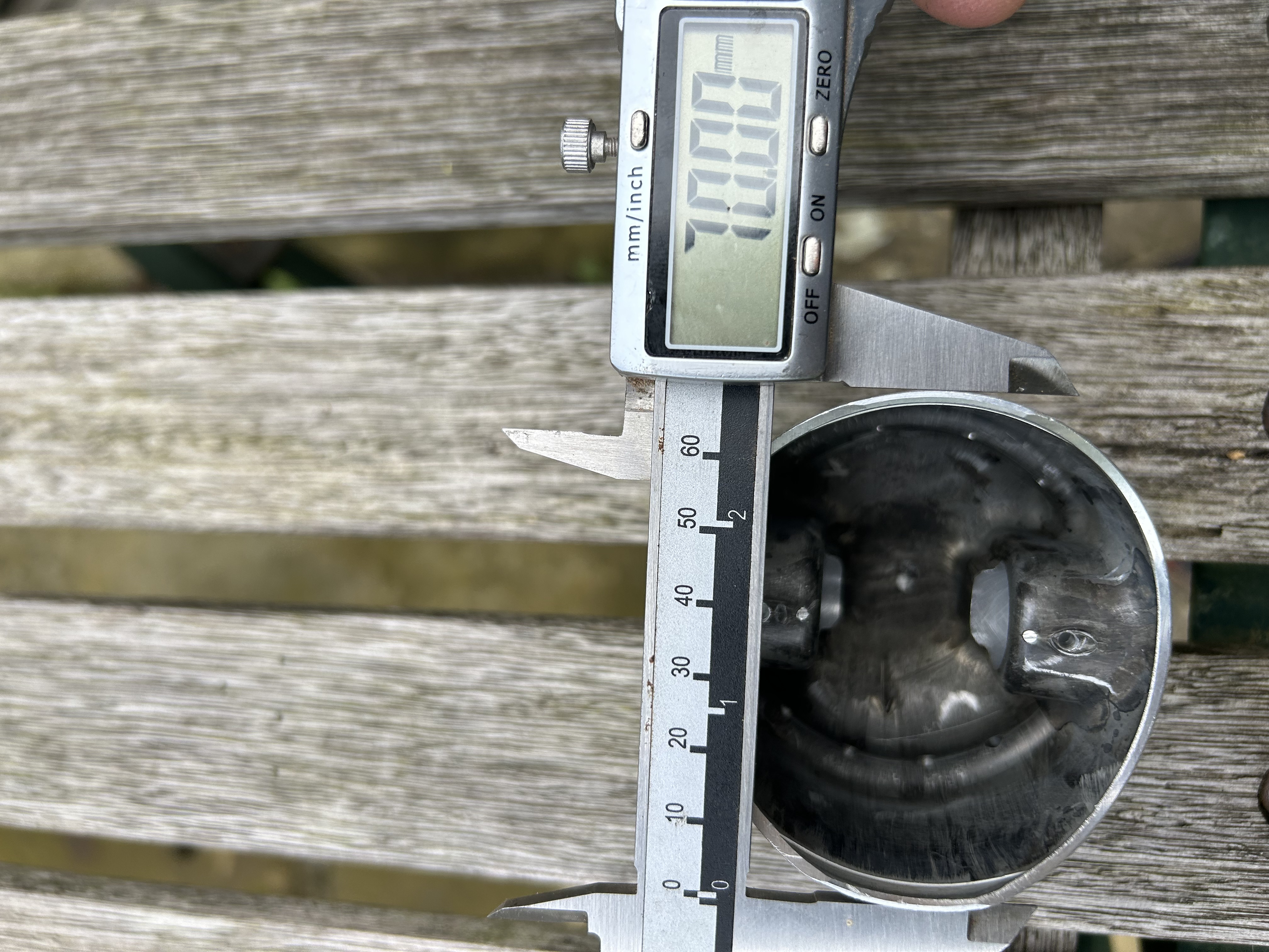

I’m to buy a lotto ticket! I managed to upload a photo of my wiseco piston crown in last post. You can make a comparison.

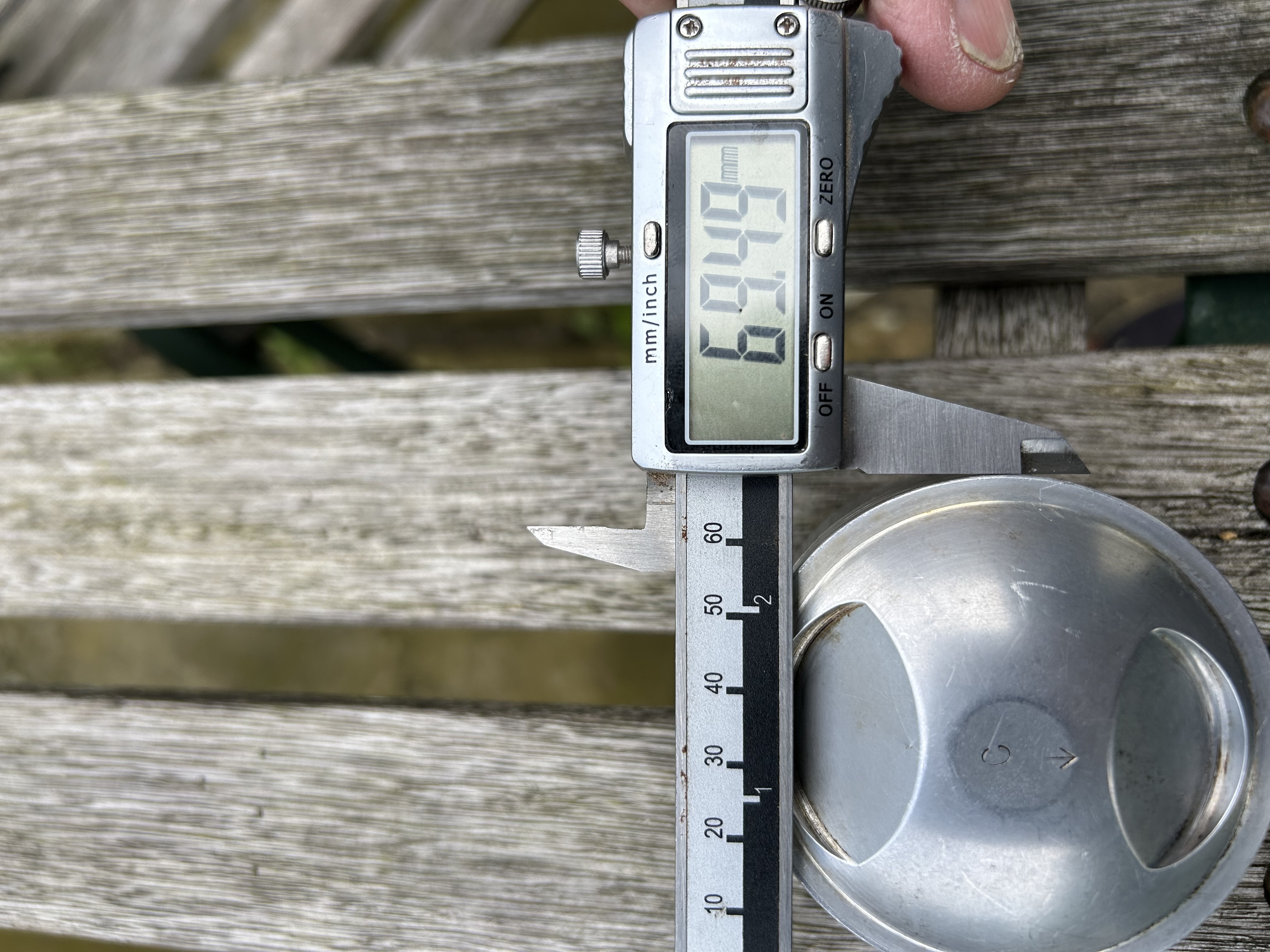

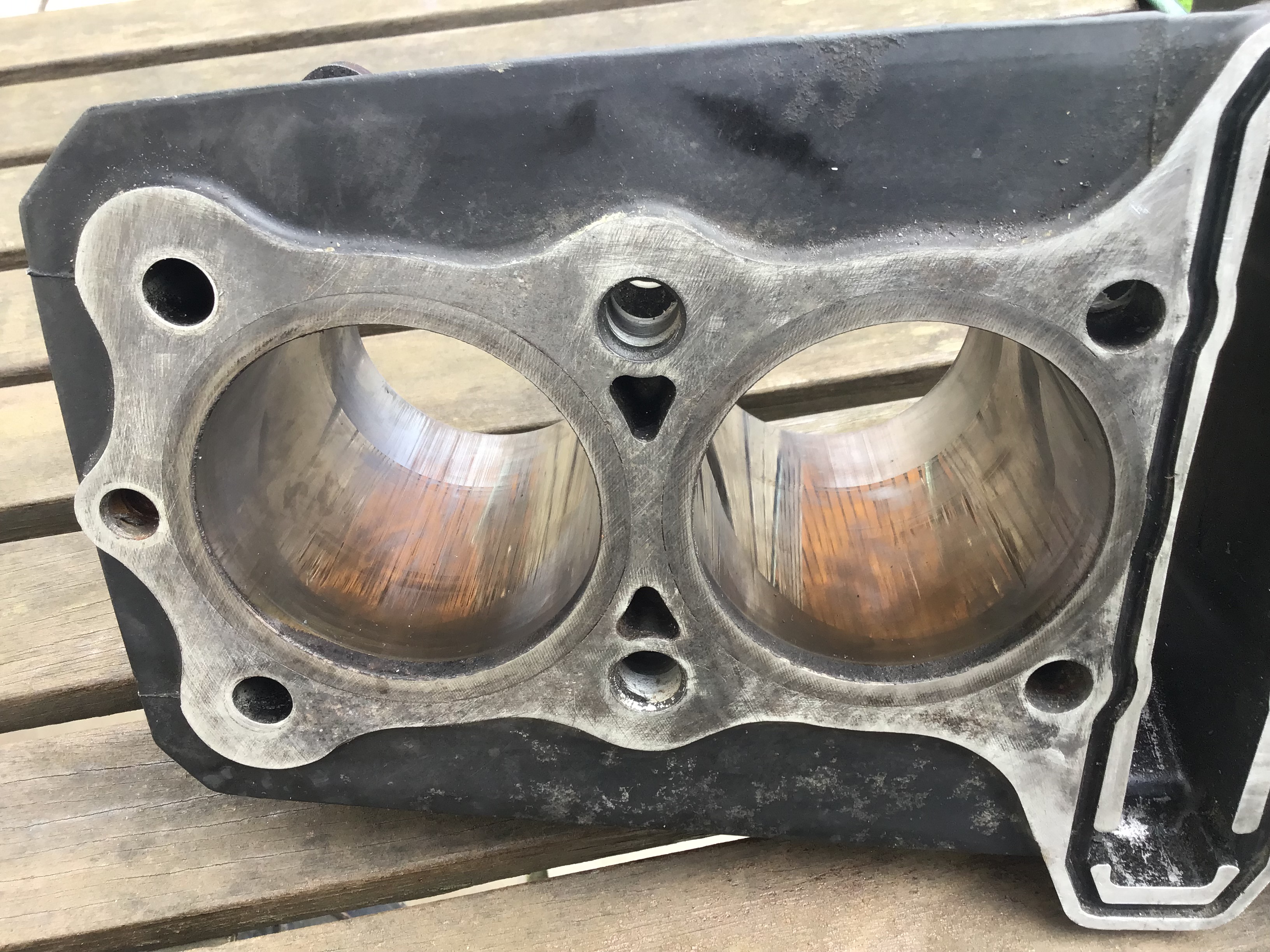

Ok im doing a bit off measuring today, my pistons look new with no blow past .however it smoked a bit and the compression was 115-130 psi checked with two decent testers,the valve stem oil seal were soft and the valve to guide clearance is good (hardly any sideways movement) .Ive not gapped the rings yet. How do you check your piston bore clearance and what would you expect on a 75mm wiseco piston?

For the Wiseco pistons it's 2 thou ( 0.051mm ) measured at the skirt.

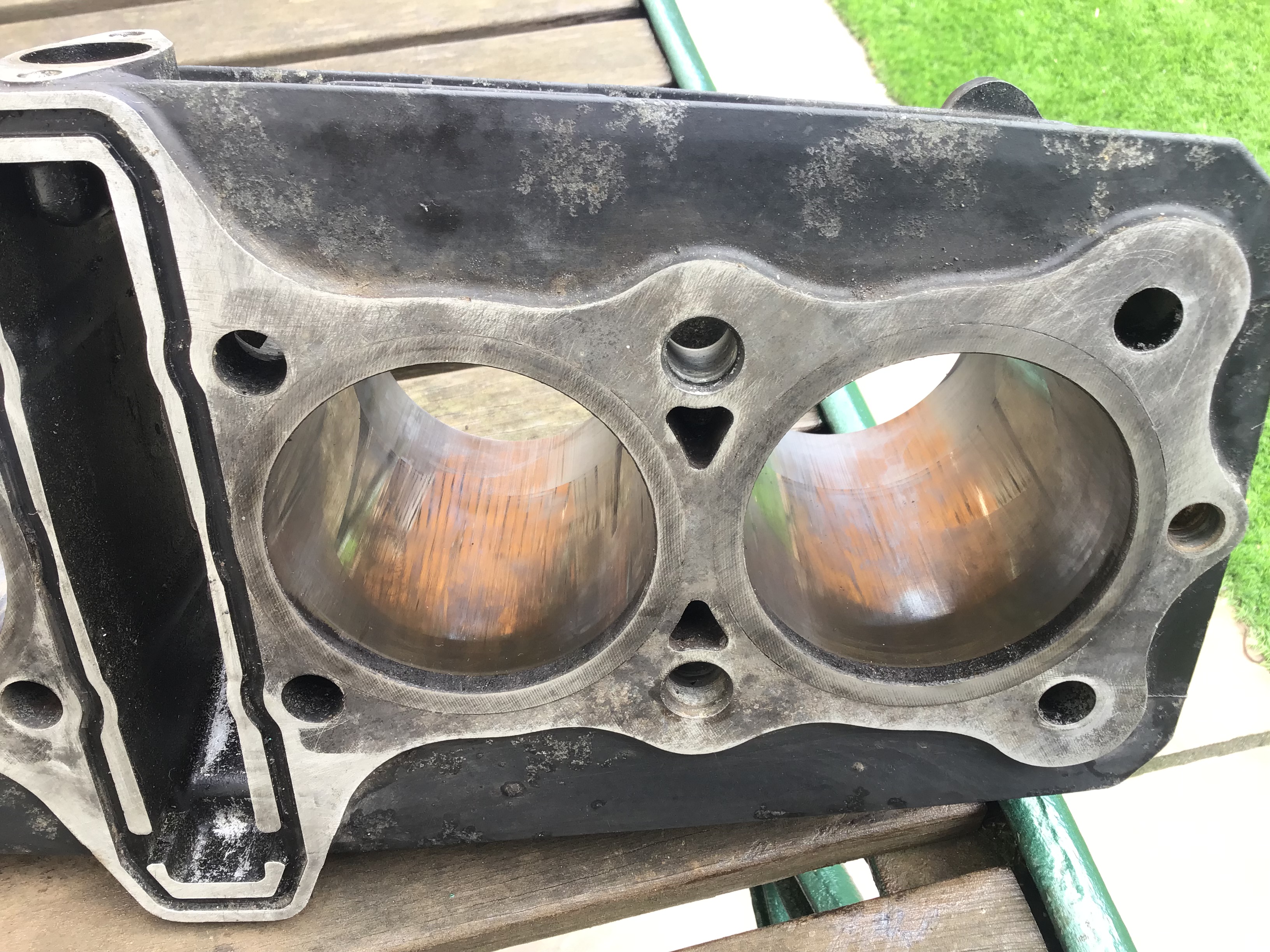

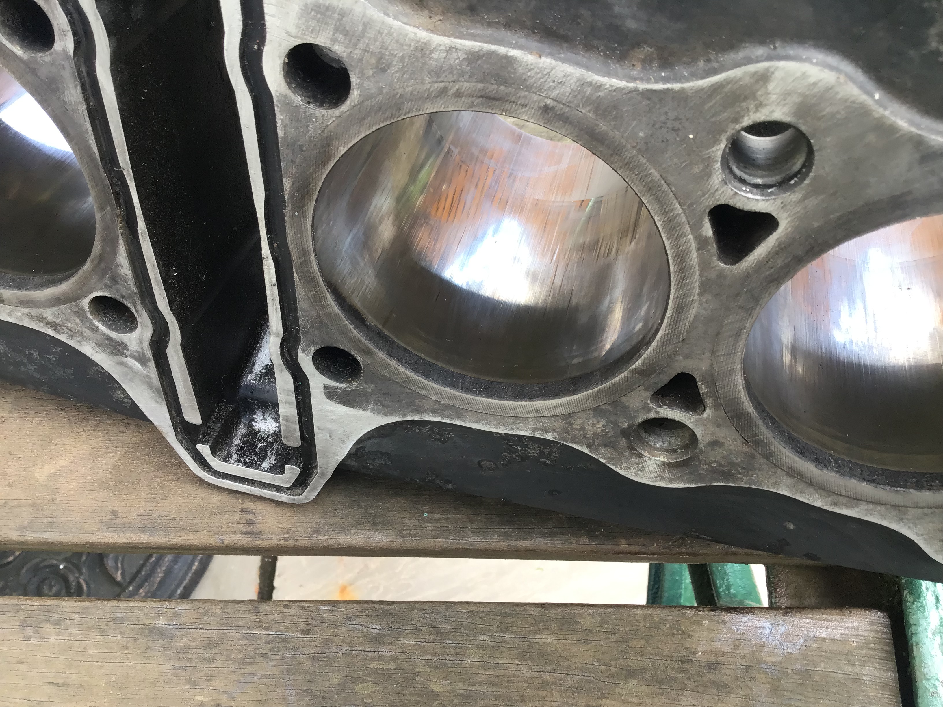

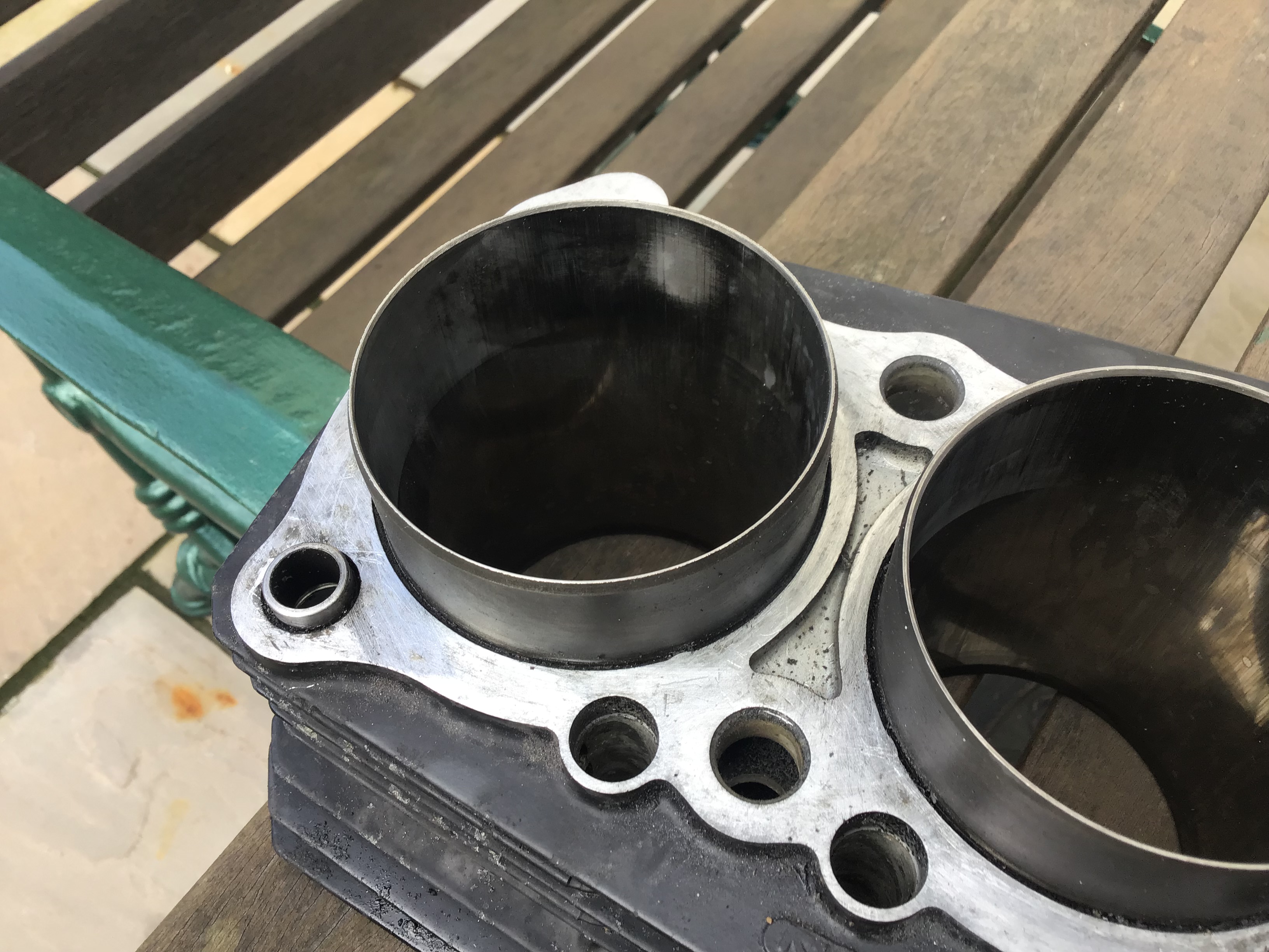

Are those vertical scores in the bore like on the skirts of the pistons or an optical illusion?

There are vertical lines but i cant feel them with my finger nails ill try to get better pictures.im trying to find a reason for poor compression and smoke but theres no real smoking gun yet ,

zed1015 wrote:For the Wiseco pistons it's 2 thou ( 0.051mm ) measured at the skirt.
How far up the liner from the bottom
Posts: 4037
Re: Bore size
#29 PostAuthor: zed1015 » Thu Mar 06, 2025 5:58 pm
Anywhere where on the liner where the lower portion of the skirt travels .
Intake or exhaust side of the pistons.
Not the sides.
