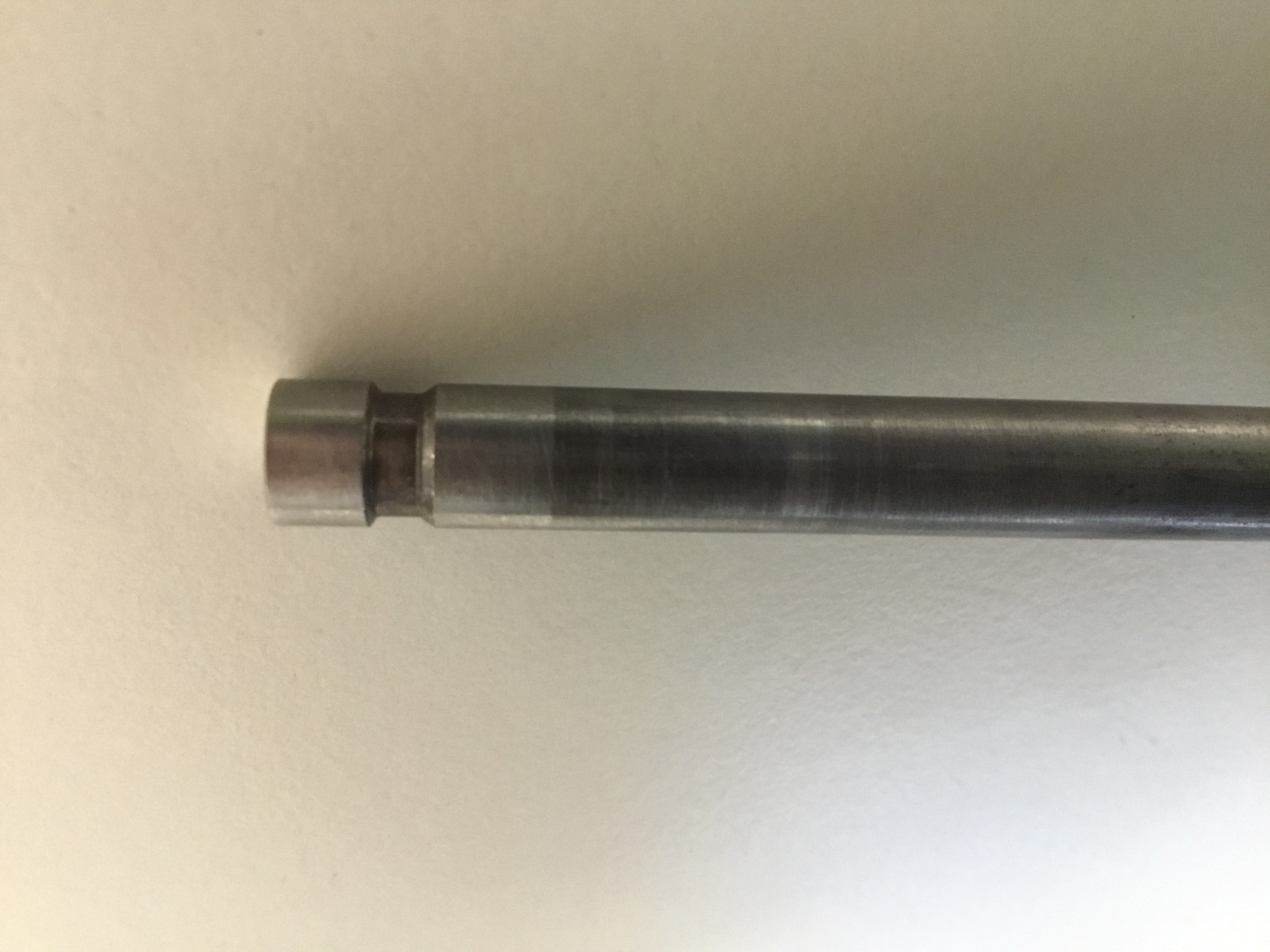

Couldn't get a square profile slot valve, so later round slot valve on order from Nick at Suzuki Performance. Matching round keepers on order from Cradley Kawasaki. All should be here tomorrow or Thursday.

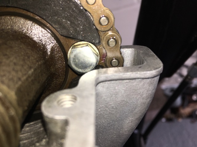

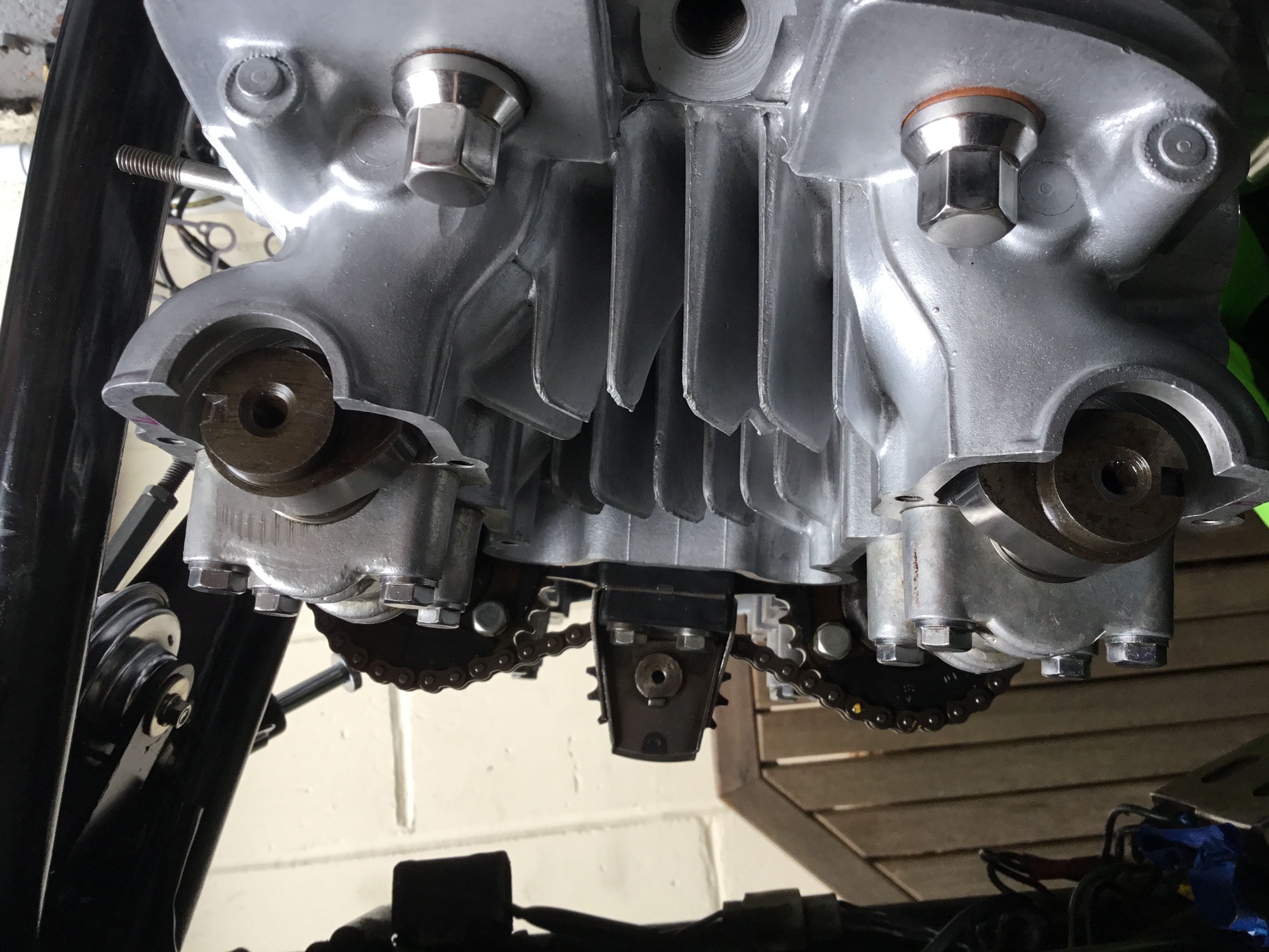

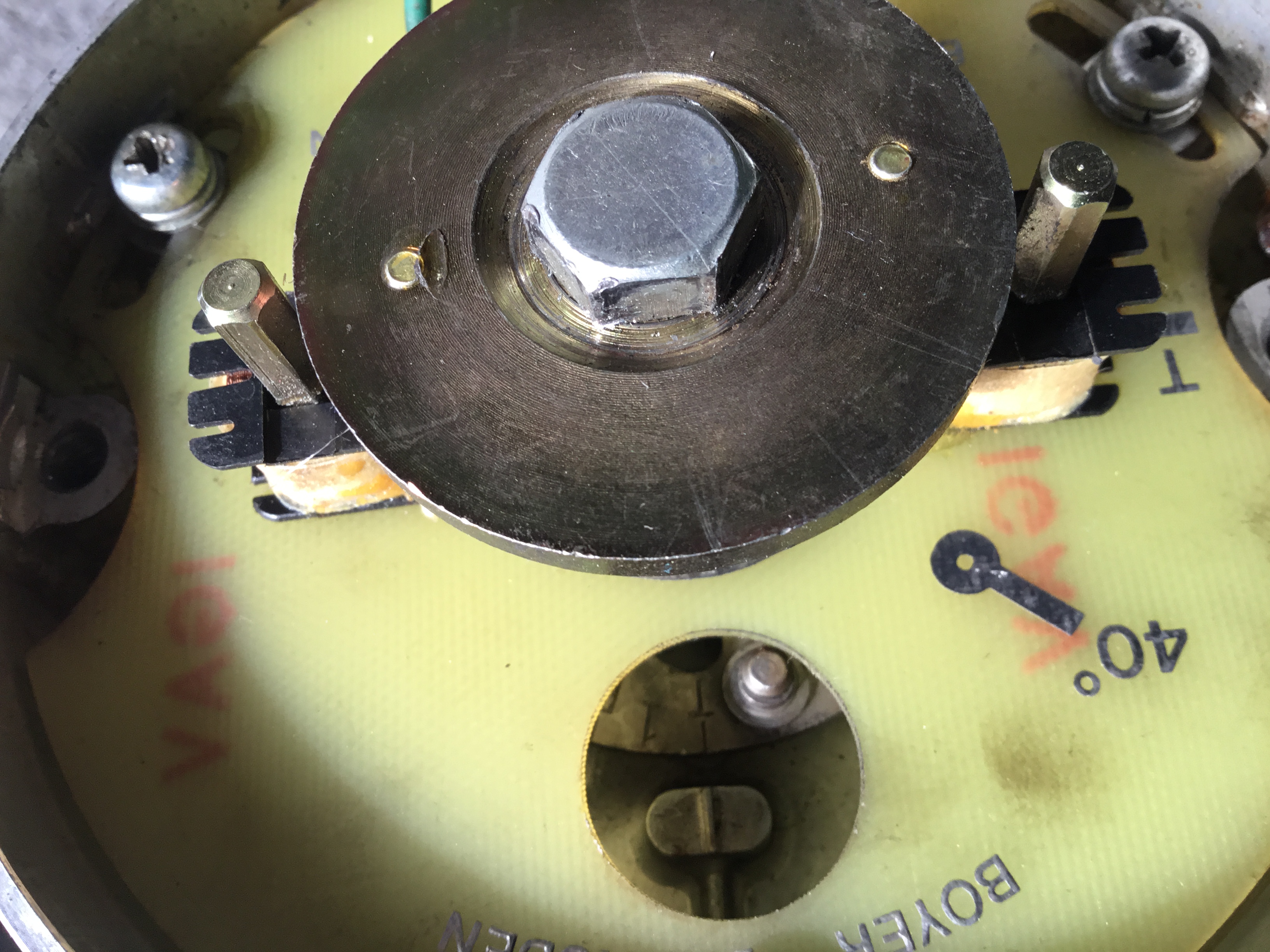

Ok chaps, I think I'm back to where I was before I dinged a valve.
Before I even attempt to put a spanner on the crank and turn it over, could I ask you please to check my work so I don't do something daft again.
The pics show how the crank is set ( on the 1-4 "T" mark), how I've aligned the exhaust camshat with the little "V" mark in line with the surface of the head, and how the two cams on the points cover side are sitting.
Hopefully that looks right and she's safe to turn the engine ?
I'll not do any more till I hear back as I don't want to nause it up again

Re: Cam gap - what's happening ?
looks bang on i would be happy with that
Certainly looks spot on.
Just be sure you did count 28 teeth back from the next pin up from the arrow (i.e count the arrow/V pin as zero ) otherwise it will run flat as a fart.

Splendid. I'll go and check that my clearances are all correct now then. I'm sure they would be as it was just the one that I dinged the valve on that was out, the others haven't been messed with.
Yes, I counted 28 pins back zed1015, starting with number 1 being the pin above the one that the "V" points to.
